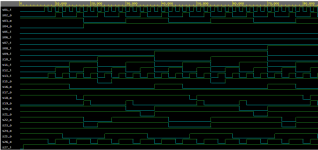

So... I think I have a working model of a Konami 504...
Real Thing
My Representation
I made guesses for pins 15, 18, 19 and 27 which I am pretty happy with... I think this is complete and would work on anything... moving to hardware next.
