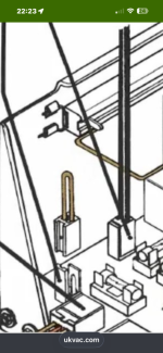

I’m missing a de mag cable around my
Tube as it is not an original hanterex tube ..
I have purchased from swallow amusements the 2pin connectors.
And I see the 2 x 2 pin connecters
One for momentary switch or bridged for degause on power up,
Here
If I wanted to make one ..What recommend gauge wire to use for
The degause wire ? Thnx

Not sure I understand. The degaussing 'wire' around the tube is a coil, not a simple wire. The coil creates a magnetic field when current is passed through it. It would be difficult to make one, I would think.
5,117CR
I admit I assumed it would have to be a coil. 🤷‍♂️ I'm no electronics expert.
Nor me lol, never opened one up and thats only pics can find and google says same
then you have these which must just be one big loop wrapped around for cheap degauss tool
