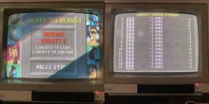

A few oddities remain .... The game is stuck on maximum credits !! and the scoreboard doesn't seem right ... No matter what I set the dipswitches to, this is how it always displays ...
I'm thinking most of this could be due to the battery (lack of) situation. The CMOS settings stuck or something along those lines. Although setting the dipswitches to use dipswitch settings doesn't make any difference. Not sure I understand that part of it yet but I've ordered some battery holders so will put a new one in and see what happens .... I will also deal with the battery corrosion damage at that point too, but for now the game actually plays fine ... So now I can use this working set (white) to try and help fix the other set (yellow) ..... tbc

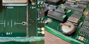

Had no time to work on this again until today and the battery holders have arrived so staying on the 'white' board set, I went about fitting a holder and new battery ...
Connection was corroded away between the via and the trace of the ground connection so fed a couple of pieces of thin wire through and soldered up to reinstate the connection, then popped in the new holder and a CR2032 ...

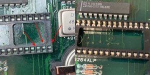

Feeling confident this would sort out the weird settings I fired up the game but it made no difference. Still getting bad CMOS on boot, stuck on max credits, weird high score table .... went into the test menu and tried clearing the settings, which it seemed to be doing but wasn't. Then I tried a factory reset but got a message saying 'failure in CMOS Ram' !. .. hmmmm ok, is the ram bad? I'd checked it previously and given it a green (for good, obviously) sticker so I wasn't convinced it's a bad ram but checked it again (in my tester and in another game board) and still checking out good. Then I had a good look in the socket and even though I had seen some signs of corrosion from the battery leakage before I remember thinking it wasn't bad but on a real closer inspection it was worse than I thought. Some of the socket pins had corrosion but pin 13 and 14 (gnd) were particularly bad. pin 13 looked like it wouldn't be making good contact and pin 14 had actually snapped inside !
Took out the old socket and put in a new .....
RAM back in and powered it up, and happy days - got a normal score board and normal credits ... dipswitch set to use CMOS settings and even holding memory after turnoff/on (y)

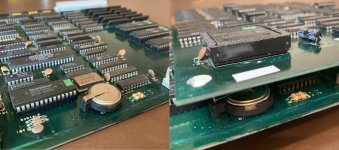

So everything now working 100% as it should now for this 'white' board set ... new battery fits nicely under the top pcb and put some solder mask over the exposed corrosion damaged traces. Not perfect but looks a lot better !!

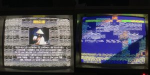

Game boots to cmos message displayed correctly, then get the Mortal Kombat splash screen with sound, but then the screen goes black with just some artifacting (pic on left). If I set the board to go into test mode, it does but nothing is readable (pic on right).

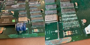

Knowing this has to be main board issues set about repairing the battery leak damage as this is very likely causing these issues .. and as you can see the damage was quite nasty ..
