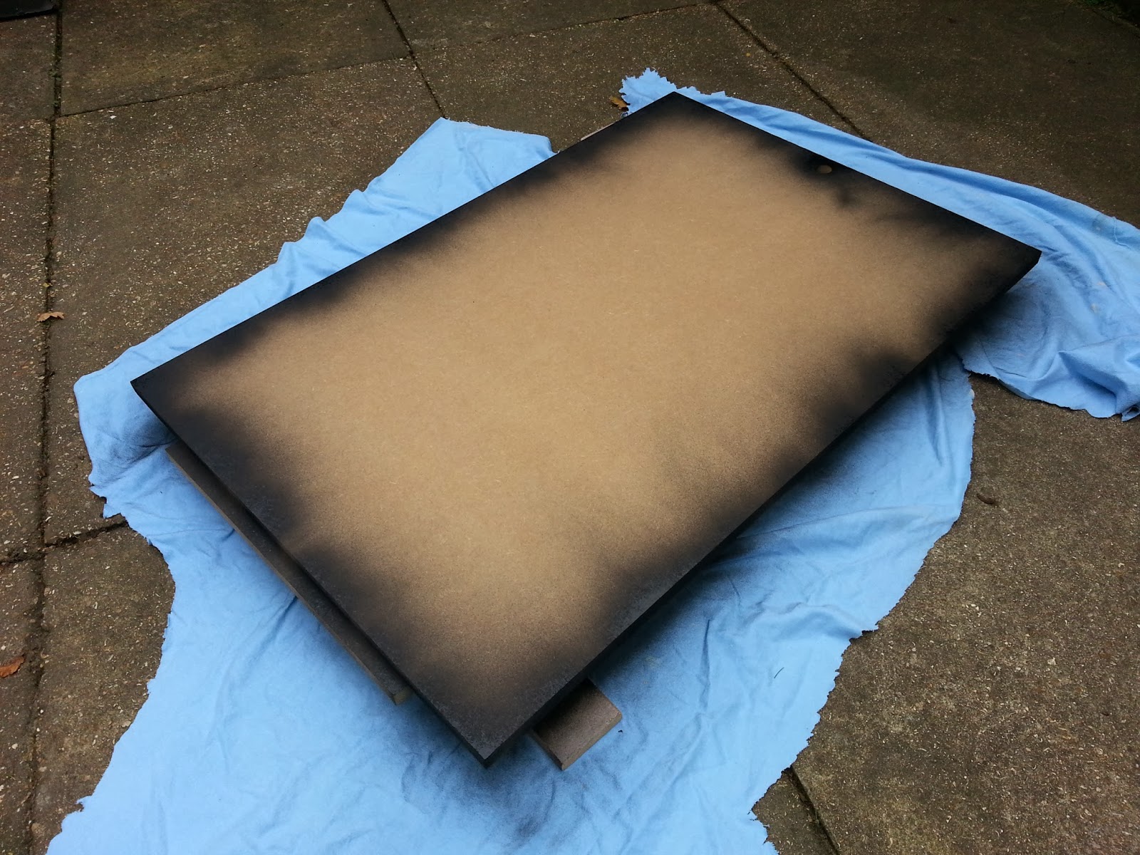

After being happy with the cab innards, It was time to make a back door to replace the rotten one that came with the cab. It had a big section missing and was in a really poor state. The main door is a single piece of MDF cut to size, with a small section which holds it in place at the bottom.
Backdoor cut, lock hole drilled and edges sprayed

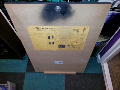

I was going to cover the door with some adhesive vinyl, but after seeing how the spray looked decided to cover the whole panel in spray and leave it at that for now. As you can see below the lock is fitted and the original Atari Information sheet was re-stapled to the inside of the door.
Backdoor complete
