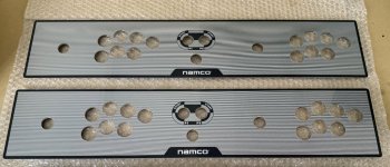

The new control panels are ready to be installed.
I’m at the back end of this project now. I’m having a black stainless steel cabinet fabricated that will match the design of the lower half of the cabs and will sit in between the two of them to house the Airlink step down and hide the linking cables as well as storage for PCB’s.
They will be the first two cabinets to go into my home arcade garage conversion. I’m aiming for about 10-15 in there, and a pair of NAMCO Grigio will likely be my next project.
