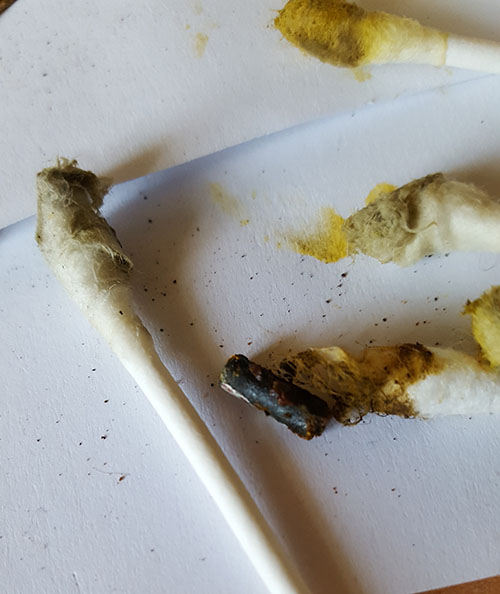

So after some snipping, removing of hotglue and being spat-at as I tried to desolder the thing (hmm.. some eye protection would be a good call next time...), I managed to clean the area up.
Well it took a load of cleaning.. but got there in the end.

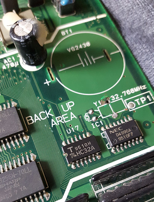

Sadly the timing crystal has been totally nuked, the sacrifice for the nearby chemicals clearly!

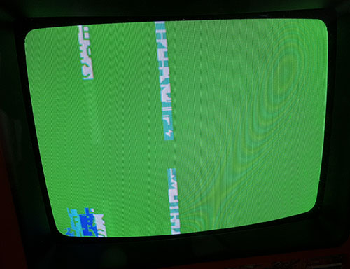

So, without battery or crystal, it now boots to the greenscreen. The 'WORK RAM TEST' functions if I throw all the dip switches, but it never gets to the grid pattern or test mode:
Soooo... replacement crystal time, and then I'll do the battery mod to fit a CR2032 non-charging cell.
Anyone know where I can get a suitable 32.768Mhz timing crystal?
(It's the small 1cm long, silver cylinder type).

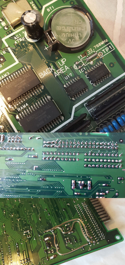

So this evening I got to work, and yep - just as described fitting the new crystal brought the deck back to life, straight into the test grid!
So I did the battery mod, and so far settings and time seem to be saving properly (probably need to do a bit more testing over the coming weeks on that one though!).
Sadly on the test mode I discovered P1 button D was totally dead, along with P2 Left & Right.
Initially I thought these may simply be due to the legs of components near the edge connector being bent over and actually crossing / shorting out.
Straightened them up but no joy - clearly the battery leak had done it's usual trace damage.
Inspecting the resistor arrays and traces, I could see the 'bus' next to the battery leads up to the NEO-C1 chip from the resistor arrays near the input pins. This is where this NeoGeoDev wiki page detailing the pinouts proved to be incredibly useful. I was able to trace the exact pins for P1 button D, and the P2 joystick movements.
And lo behold the traces from these pins are the 3 nearest to the battery on that 'bus' going down to the bottom of the board!
Re-patched them in suitable places on the underside of the board where the grey insulation pad would have been, and boom - one fully working MV1FZS motherboard

I hot-glued the crystal and patch wires afterwards to make sure they stay safely in place.
