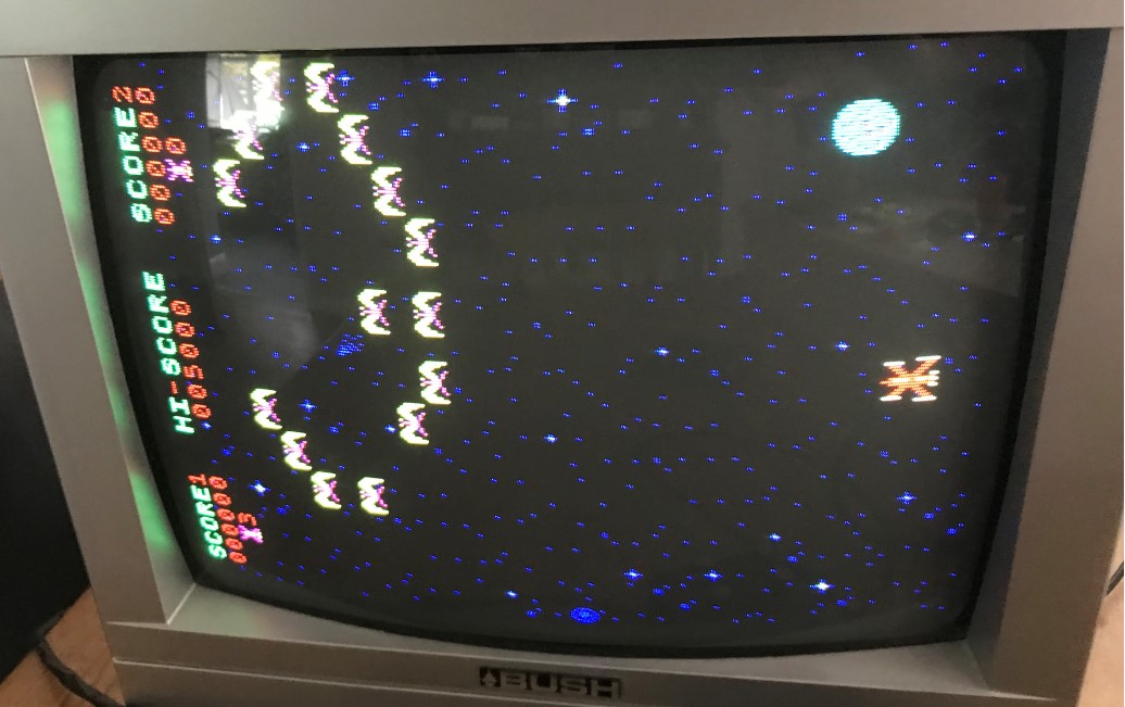

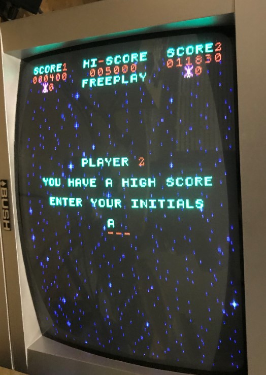

Photos (sorry for the blur on the menu and initials entry photos - the background does funky star scrolling so it doesn't look as clear on the photos as it does in reality)...

- Timeout in name entry mode. If you leave it sat there without
entering your initials, it will time out in about a minute, still save
the score but save the initials as "- - -"

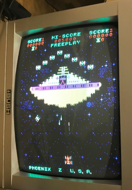

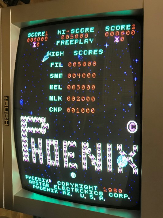

Photos of the updates are below
New menu options
"Freeplay" shown on screen in attract mode
"Freeplay" not shown on screen in gameplay
High score table showing initials replaced by "- - -" if you take too long to enter your initials

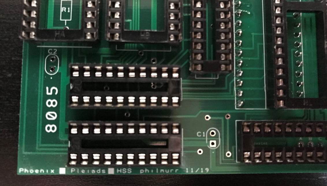

A few people have asked about Pleiads. Well the high score save PCB was
also designed for Pleiads (see the silk-screening on the photo below) which
is very similar hardware and software. I'll be doing a high score save
kit for Pleiads just because it makes sense to.
