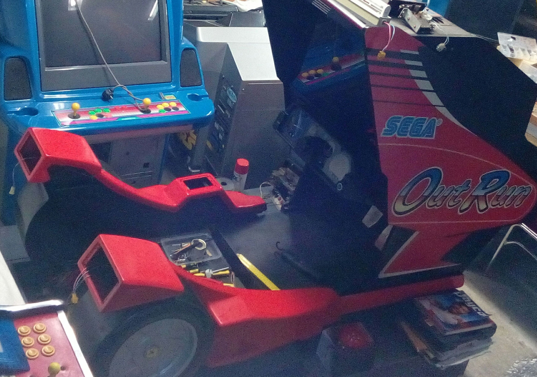

outrun panel and paint
Mykill
229CR
still got exaust pipes to paint

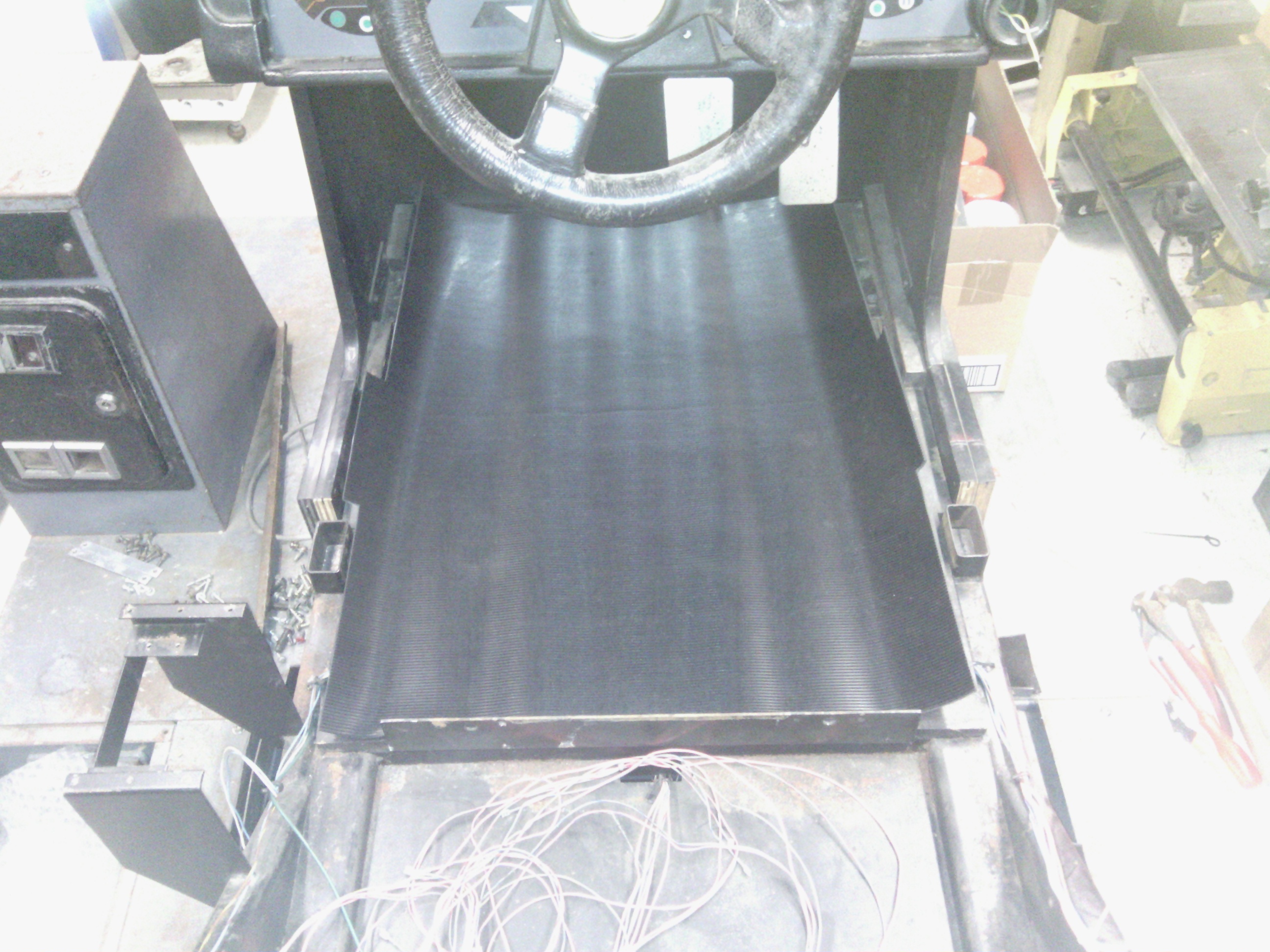

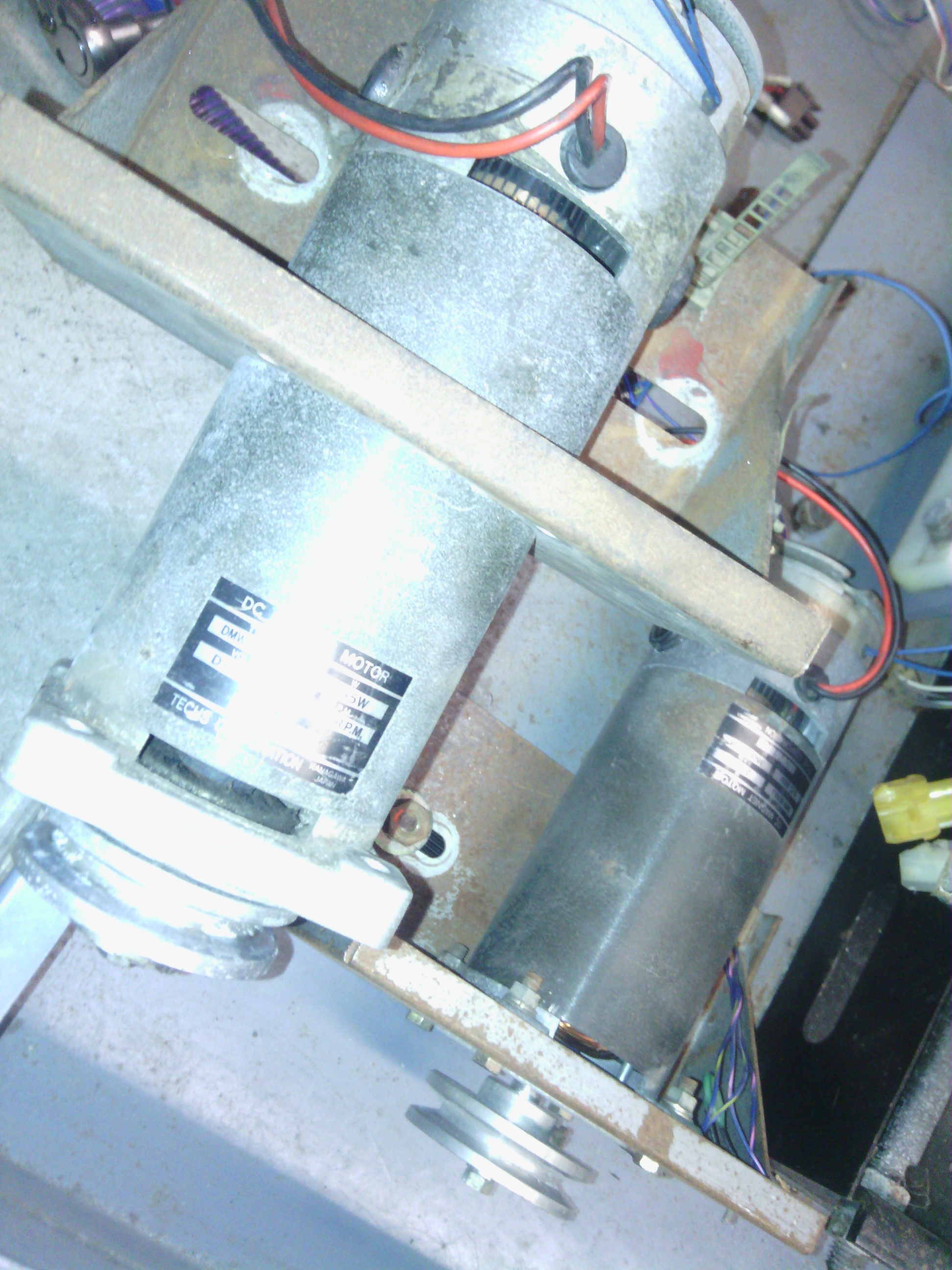

the top motor was installed,i think the bushes have been out
as the motor mounting plate is installed on the wrong side if the motor and isnt removable with taking out the bushes
it dosnt look like much but wasnt rightand off set the pully ,plus new motor has all plugs attached.

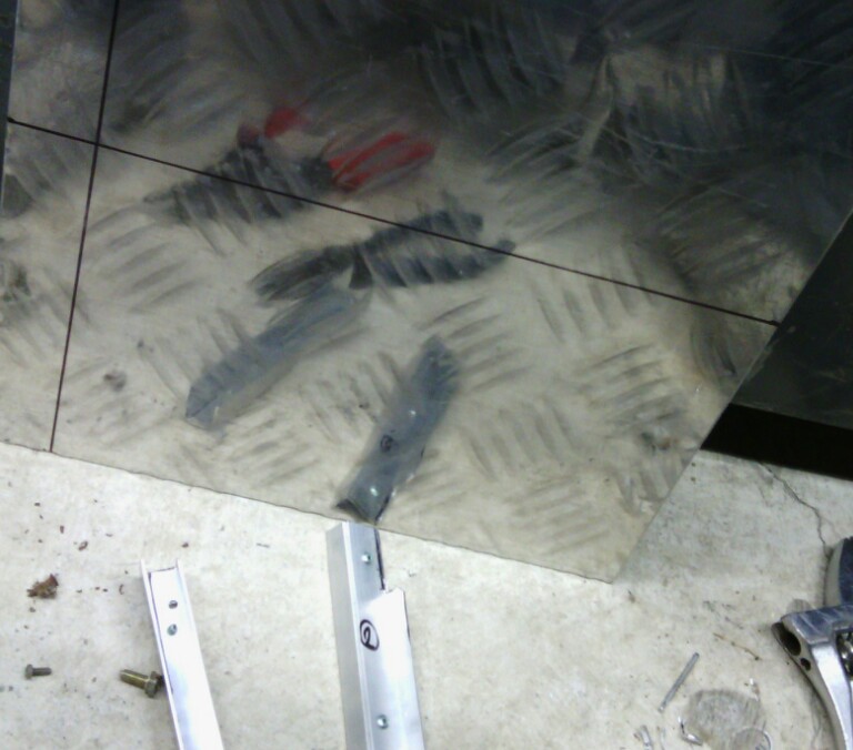

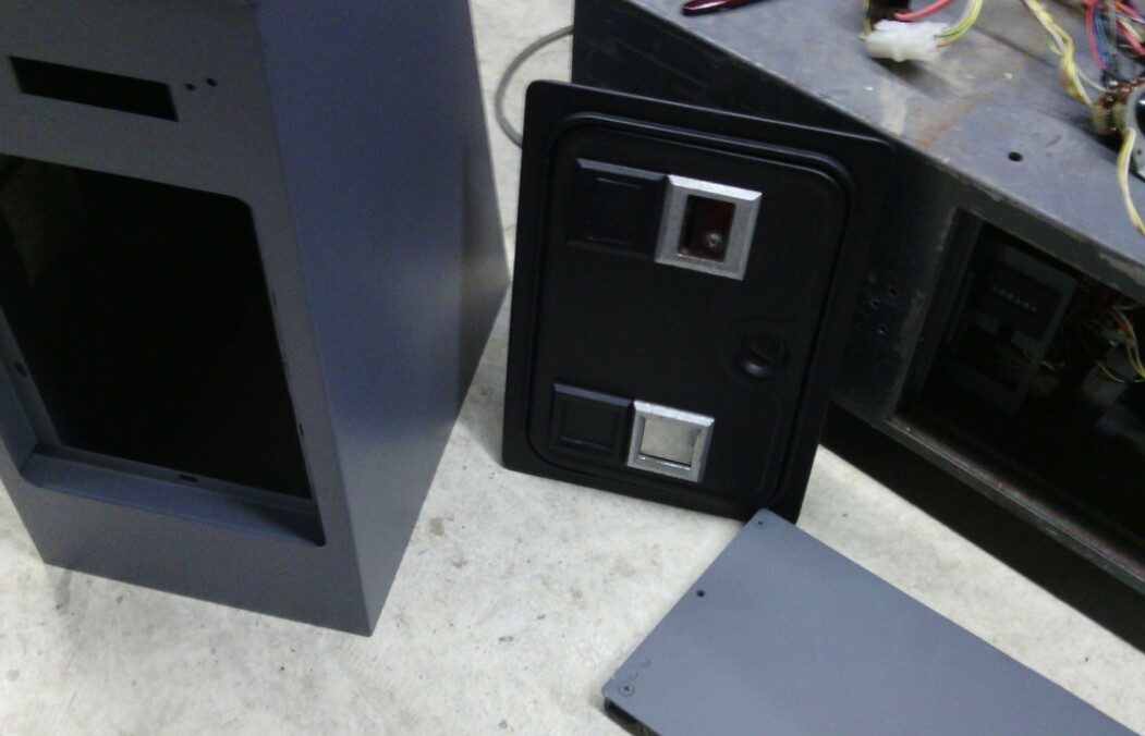

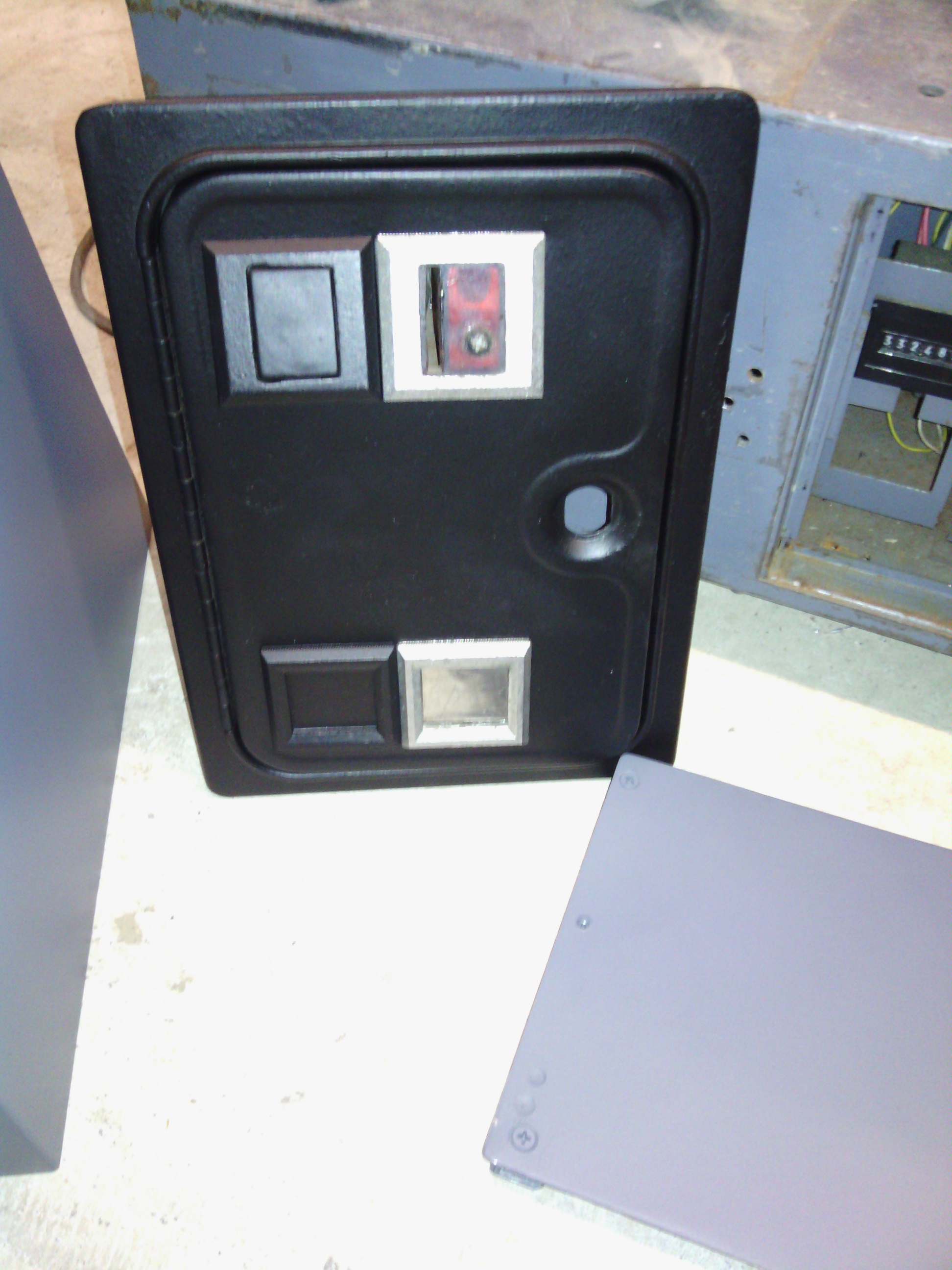

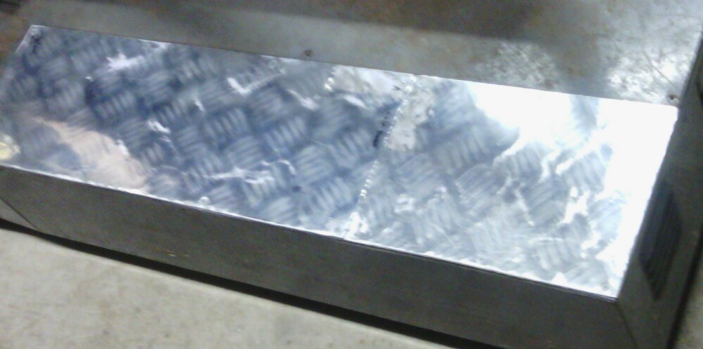

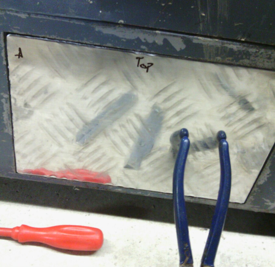

lol,made a coin door and two plates to cover the transformer ,fixed and reset the limit switches

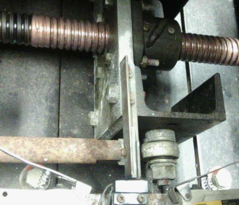

I cleaned and greased all the drive gears and joints ,strange how they used two types of Grease nipples

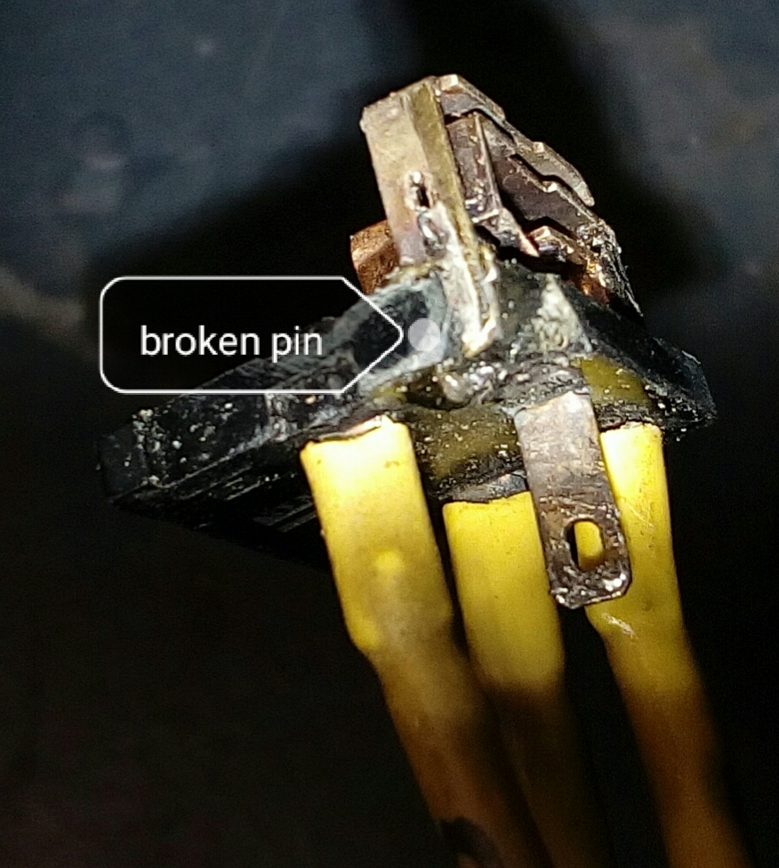

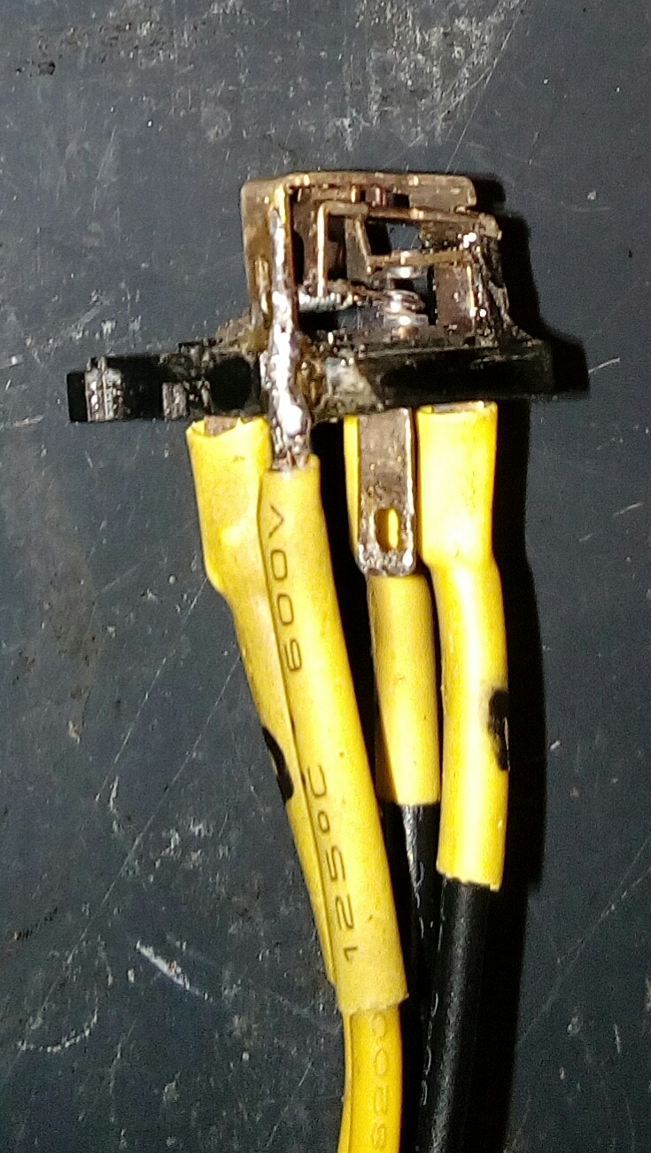

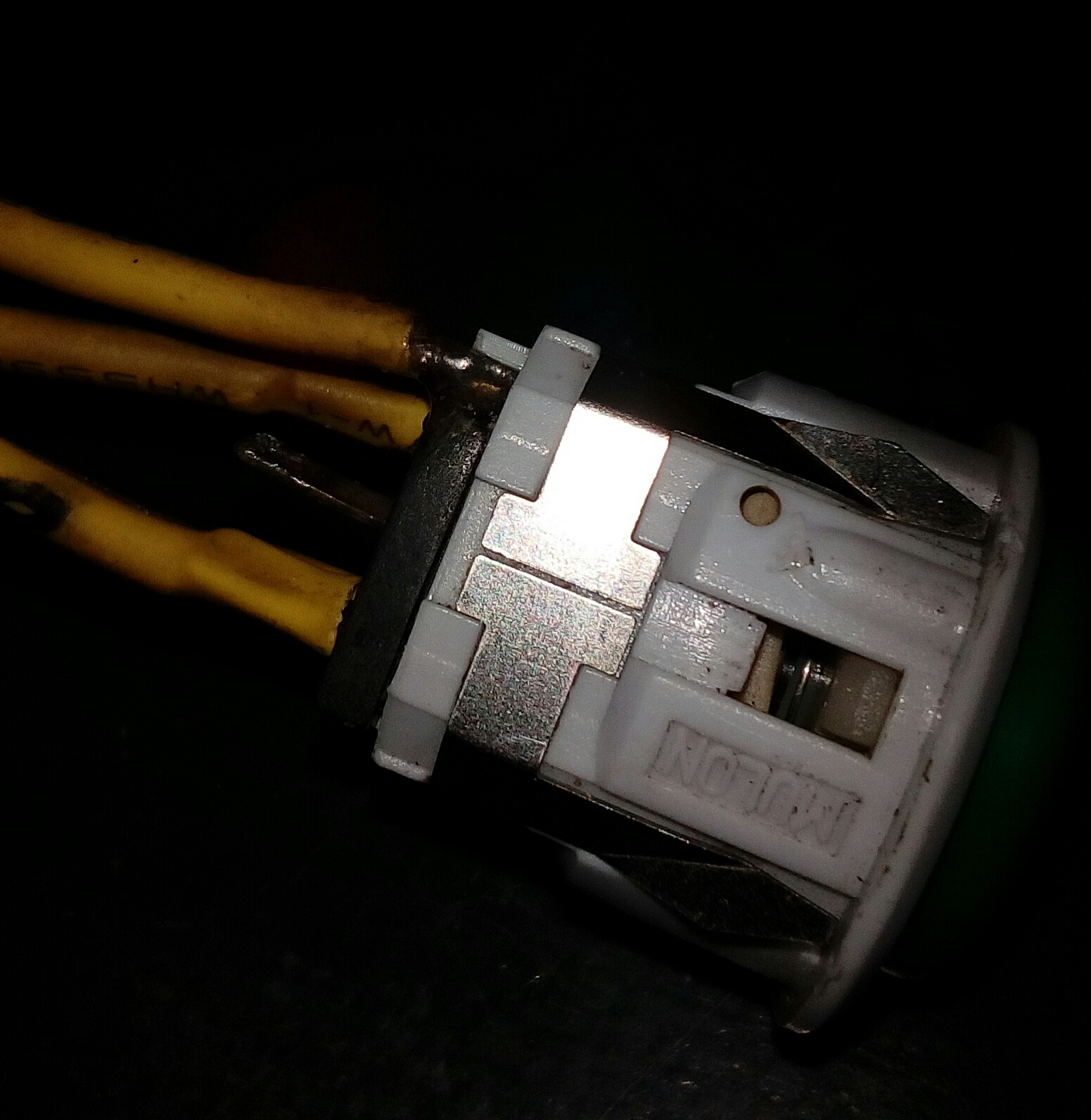

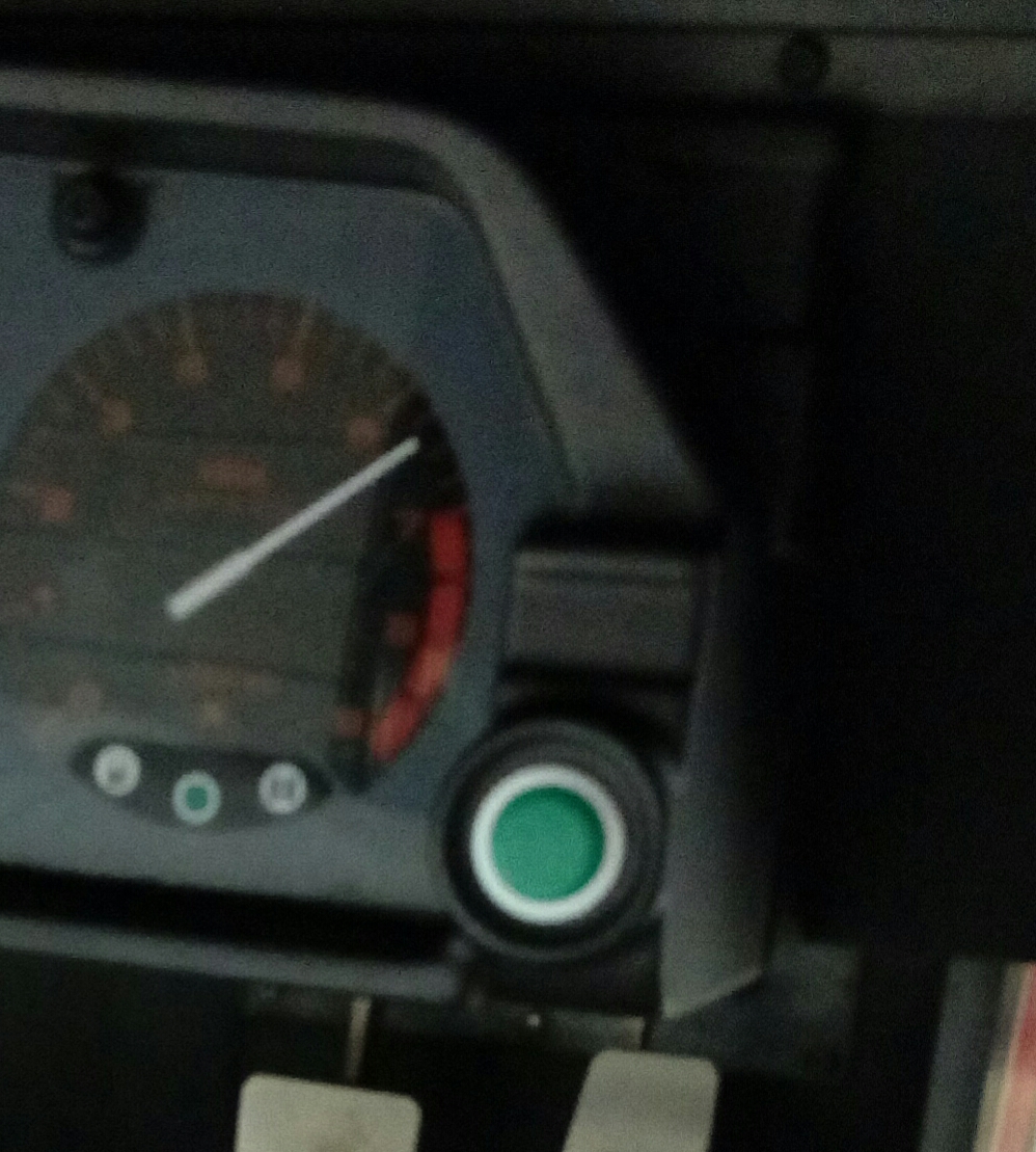

I thought it was a gonna with the broken pin ,ended up fileing off
The corner to solder it,covered with epoxy to rebuild the corner of button. snug fit
