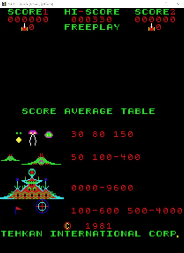

Photos of it running in Mame are below, 4 screenshots showing "FREEPLAY" in attract mode, and no asking for coins to be inserted

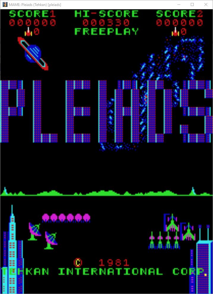

Then using the unused DIP switch you can change between Freeplay mode and non-Freeplay mode (only checked on power-up/reset). Below shows it in normal mode

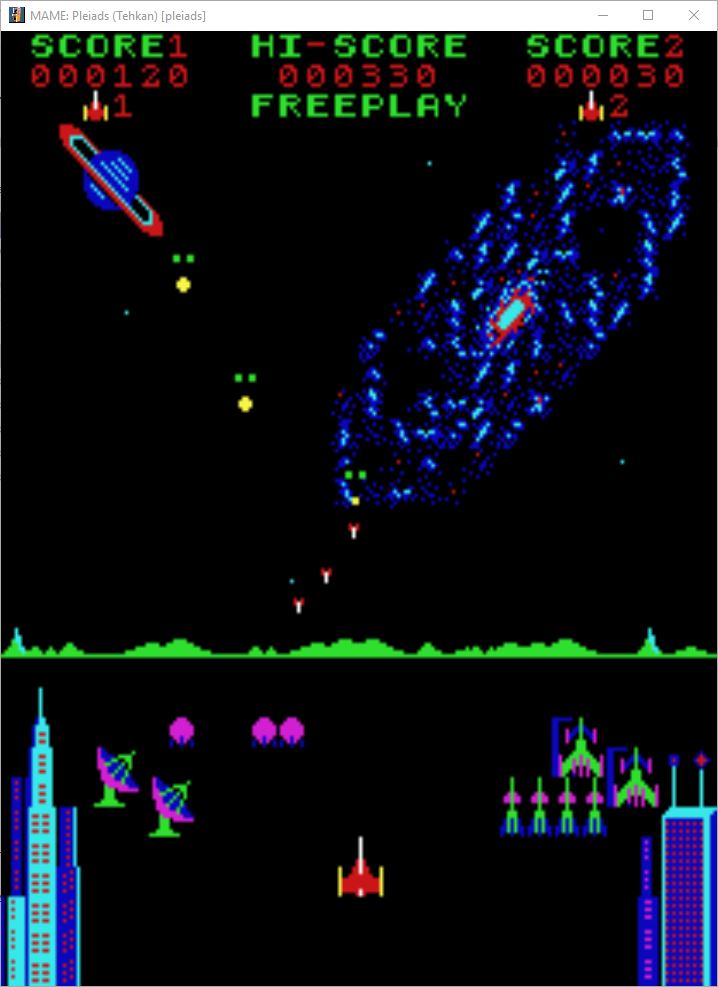

Finally the game playing. And if you're playing as Player 2 your high score will now register!
