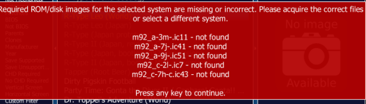

Hey all , Been 8 years or so since I fired up my MAME cab. I have updated everything including the PC and installed latest version of MAME. I have tried to get R-Type to run but missing files and I cant for the life of me find them anywhere ! Dont suppose anyone has them handy ?
They seem to be linked to many M72 board games.
Files are :-

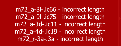

Works ok is version 249 but not in 256 !!!!
I get :-
The file size is suppose to be 279 so I will try to create at this size. Clearly not needed or it would not run in 249.
*** Edit tried and still does not work, Tried one at 2.17kb (2kb) and same ****

I was about to reply - yes, someone's managed to dump the PALs, so that's why it wants them now:
ROM_REGION( 0x0c00, "plds", 0 )
ROM_LOAD( "m92_a-3m-.ic11", 0x0000, 0x0117, CRC(fc718efe) SHA1(d554dd74cecd95754a1e6e24c6a207d6d3428253) ) // PAL16L8 - bruteforced
ROM_LOAD( "m92_a-7j-.ic41", 0x0200, 0x0117, CRC(5730b25a) SHA1(1877b807f6a94f6d515afc940e1d615a453490fd) ) // PAL16L8 - bruteforced
ROM_LOAD( "m92_a-9j-.ic51", 0x0400, 0x0117, CRC(92d477cf) SHA1(6a1e9bfdb367384e8611f46300f378730817514b) ) // PAL16L8 - bruteforced
ROM_LOAD( "mt2_b-2l-.ic7", 0x0600, 0x0117, CRC(3bab14ee) SHA1(312d19cd1a6ef636495bb9a3294261c10bab3a56) ) // PAL16L8 - bruteforced
ROM_LOAD( "m92_b-7h-d.ic47", 0x0800, 0x0117, CRC(59d86225) SHA1(9202bcf962f63edc0ef273f102c38337e90449cc) ) // PAL16L8 - bruteforced

Yeh all good , I needed to update as done nothing on MAME for about 10 years or so. Thanks to all the MAME people for there extremely hard work.
