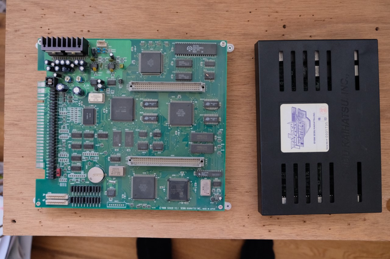

hi i found Raiden Fighters Jet and Viper Phase 1 and both are Dream Island Co, is that a clone?
ali710 User Credits 11CR Oct 20, 2019 #1 hi i found Raiden Fighters Jet and Viper Phase 1 and both are Dream Island Co, is that a clone?
SUPERSPRINT Active member Feedback 11 (100%) Credits 1,033CR Oct 20, 2019 #2 Says Seibu Kaihatsu on the title screen. I’ve never seen or known of bootlegs of these games. Let’s have a look at the pcb, seems legit to me.
ali710 User Credits 11CR Oct 20, 2019 #4 Both Raiden Fighters Jet and Viper phase 1 work on this motherboard.
SUPERSPRINT Active member Feedback 11 (100%) Credits 1,033CR Oct 20, 2019 #5 Totally legit. Seibu printed on all 3 pcbs with serial numbers. Dream island where probably the programming team and it was published by Seibu SUPERSPRINT2019-10-20 10:31:25
ali710 User Credits 11CR Oct 20, 2019 #6 DreamIsland is a license to Asian market I think. Same we got German tuning electronics or USA fabtek
SUPERSPRINT Active member Feedback 11 (100%) Credits 1,033CR Oct 20, 2019 #7 ali710 said: DreamIsland is a license to Asian market I think. Same we got German tuning electronics or USA fabtek Click to expand... I think you answered your own question there then. No licenses were obtained or paid for by bootleggers.
pulstar Active member Feedback 40 (100%) Credits 444CR Oct 20, 2019 #8 Looking at MAME, the Dream Island license are Korean releases.
ali710 User Credits 11CR Oct 20, 2019 #9 what i dont understand is. Seibu games are region locked so how come Korean release work on Japanese motherboard.
Layer Active member Credits 376CR Oct 20, 2019 #10 ali710 said: what i dont understand is. Seibu games are region locked so how come Korean release work on Japanese motherboard. Click to expand... Your mobo should be Korean as well. In SeibuSPI MAME driver, you have the keys for all the regions, check if Korea region key matches Jap one. Btw, it is possible to change the region of the mobo in reburning the iC where the region key is stored. You can change the region in the program roms of the cart as well.
