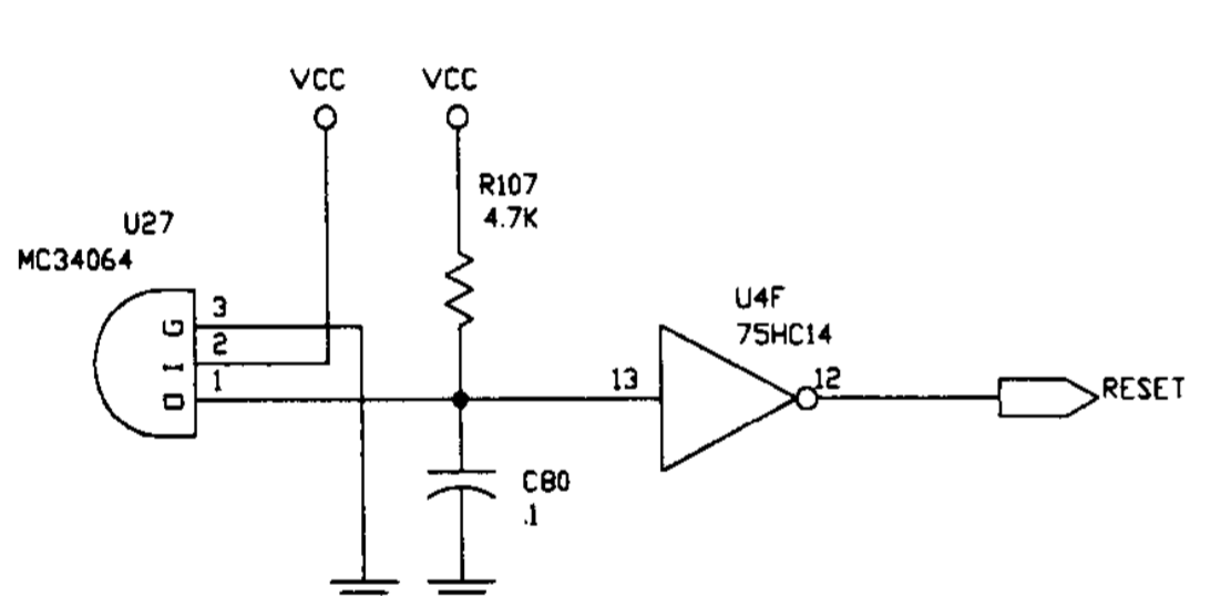

Looking at the schematics, the bit that jumps out is the 'low voltage reset circuit' - can you see what this is kicking out 'cos if it's holding the line low then that would stop it booting.
