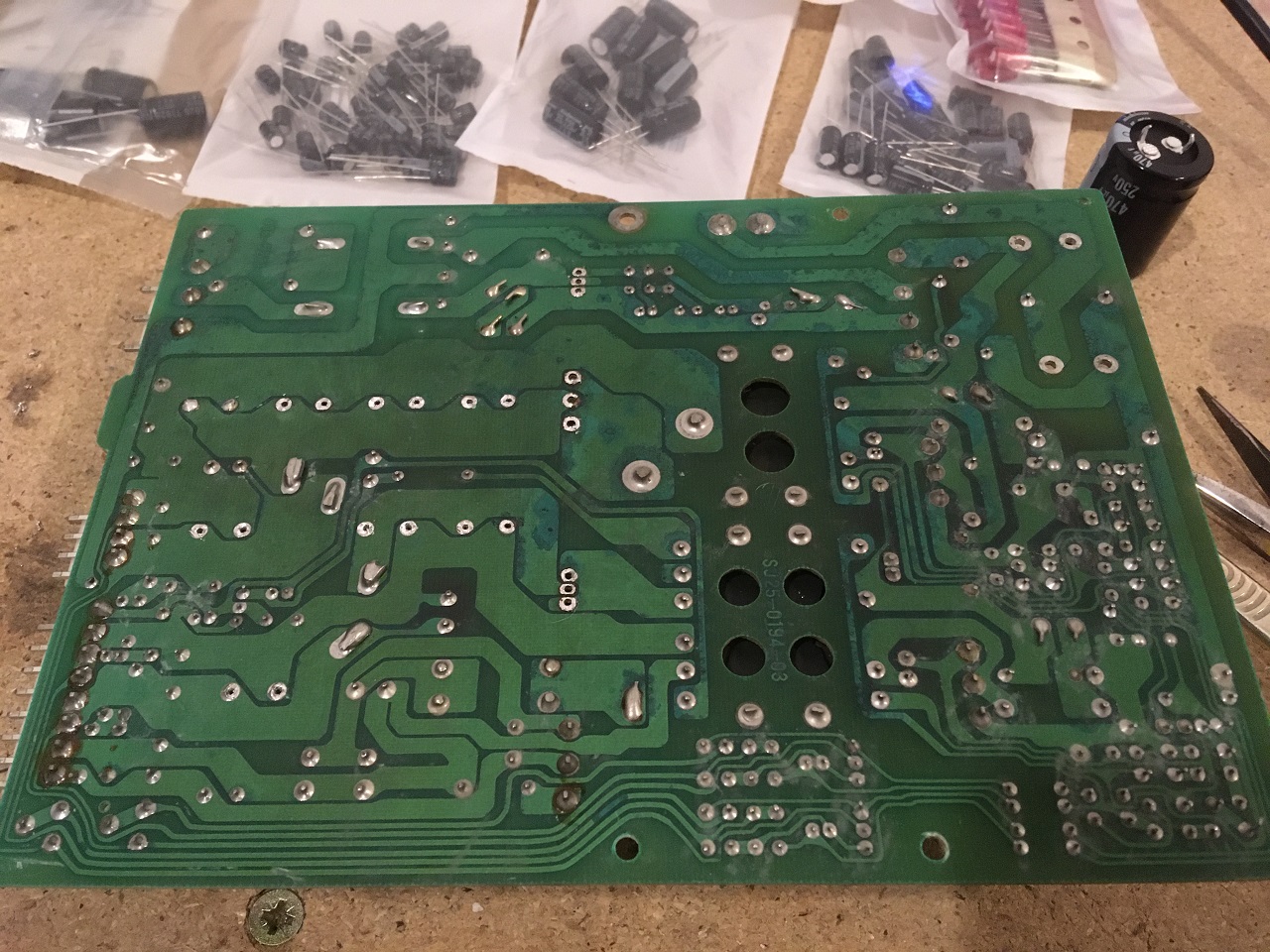

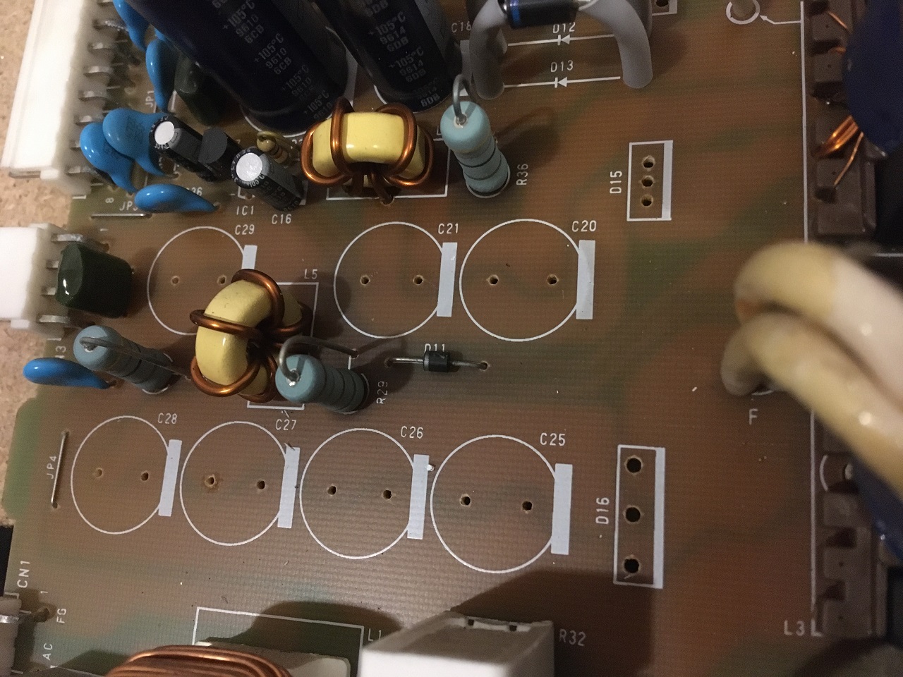

I checked the traces and they were still fairly solid, so I didn't have to do any repairs there, I just removed all the electrolytic caps and gave the board a good clean with isopropyl alcohol and then distilled water, using a small brush with both liquids.

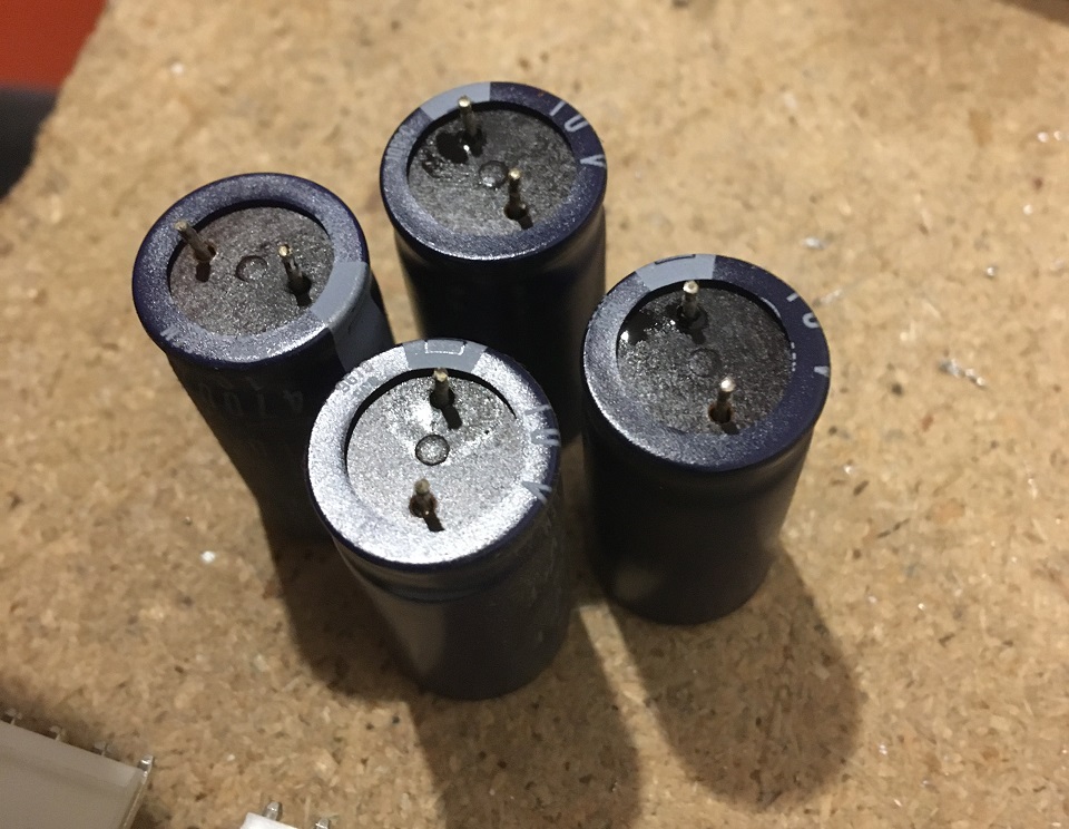

Cap removing:
Always seemed to be leaking electrolyte around the negative pin:

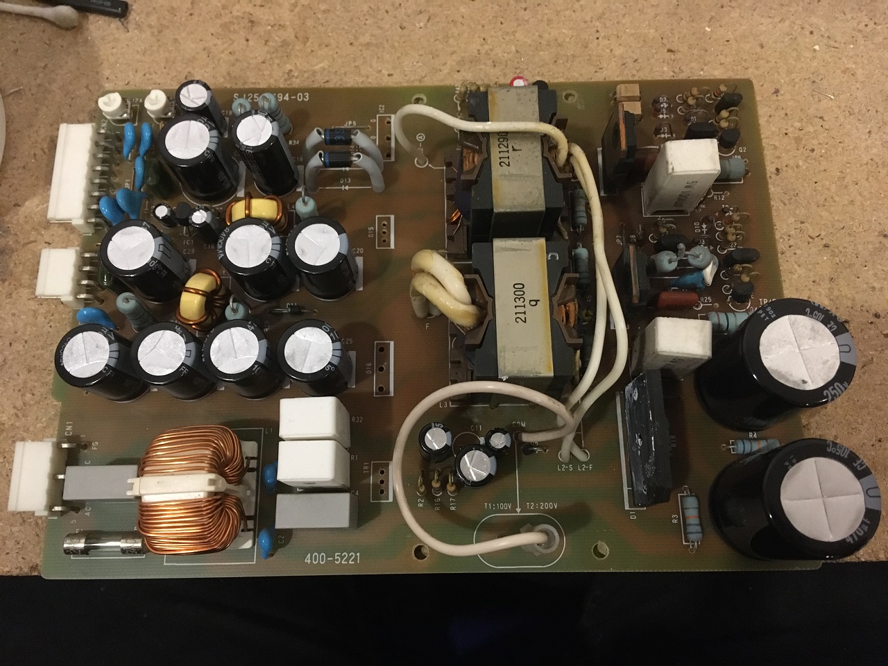

There are two aluminium heatsinks across the board with the power transistors and diode bridges mounted to them. These needed to be removed to access the capacitors. I found it easier to unsolder the components from the board while still attached to the heatsinks, as the mounting screws were often blocked by the capacitors. A bit tricky but do-able.
Otherwise, recapping was fairly straightforward. The only extra servicing I did was put a bit of solder on the power plugs, they hadn't dry jointed but they didn't seem to have much solder on them so I thought I'de toughen them up. I also cleaned off the old dried up heat transfer paste and re-applied some new paste on the heatsinks where they are mounted to the case.

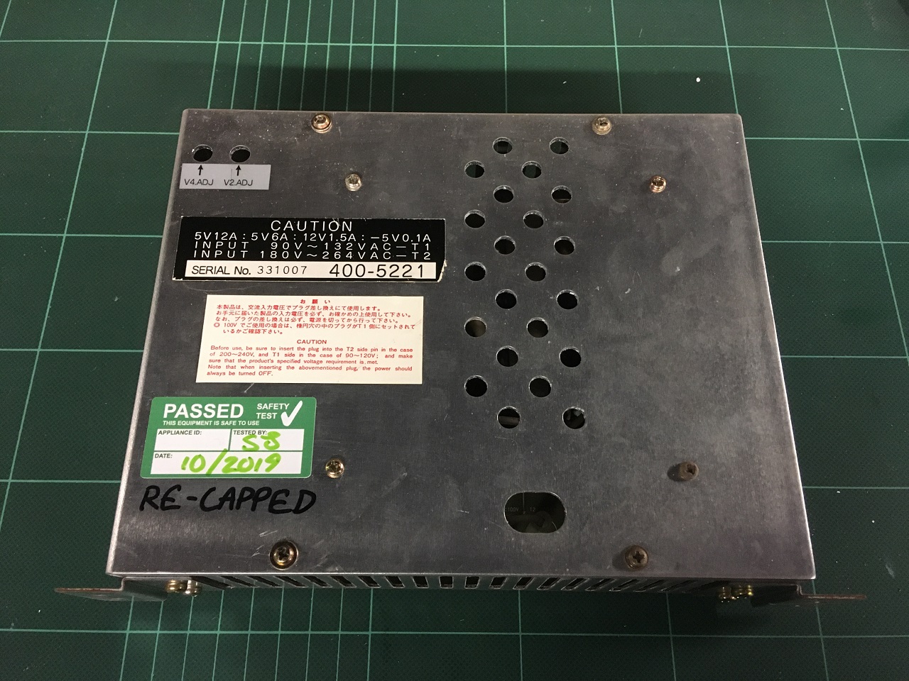

Shiny new caps fitted:
To finish off I PAT tested them and hooked them up to a dummy load to make sure the 5 volt line levels were okay before plugging them back into the Daytona twin.
I was certainly quite alarmed at how much they had leaked, and pretty much every single capacitor had started to leak, yet everything seemed normal.
Normal that is until one day the corrosion is bad enough to cause a catastrophic power supply fail and send my lovingly repaired Daytona Model 2 stacks to video game no-longer-working land. So I'm pretty happy I caught them in time.
