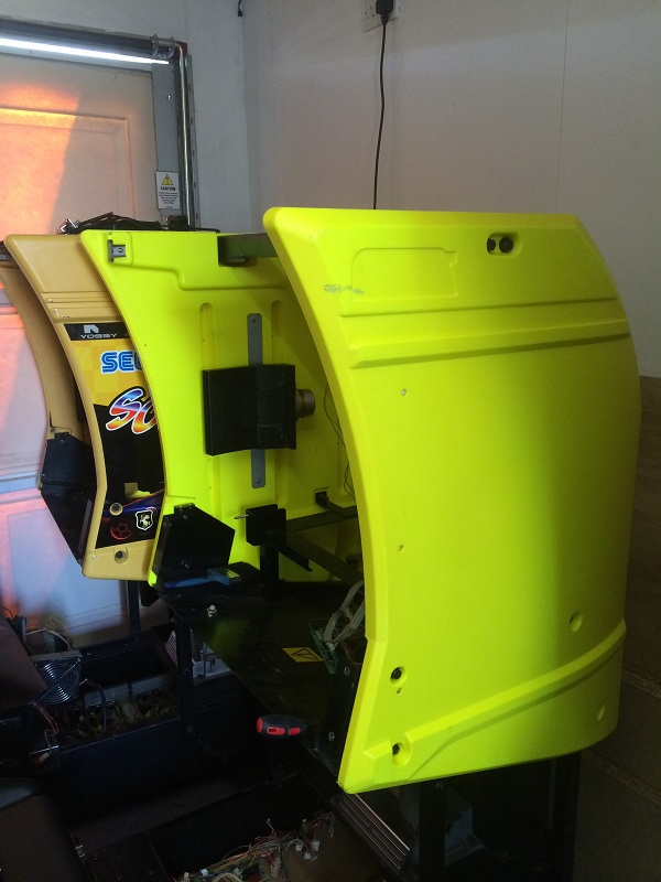

for the most part this is an original SCUD Race, but at some point the side panels have been replaced, with those from a Model2 driver, they have also been painted Yellow. underneath they were originally red but I don't want to risk taking the paint off to find tatty sanded down red underneath so for the time being they will stay as they are.

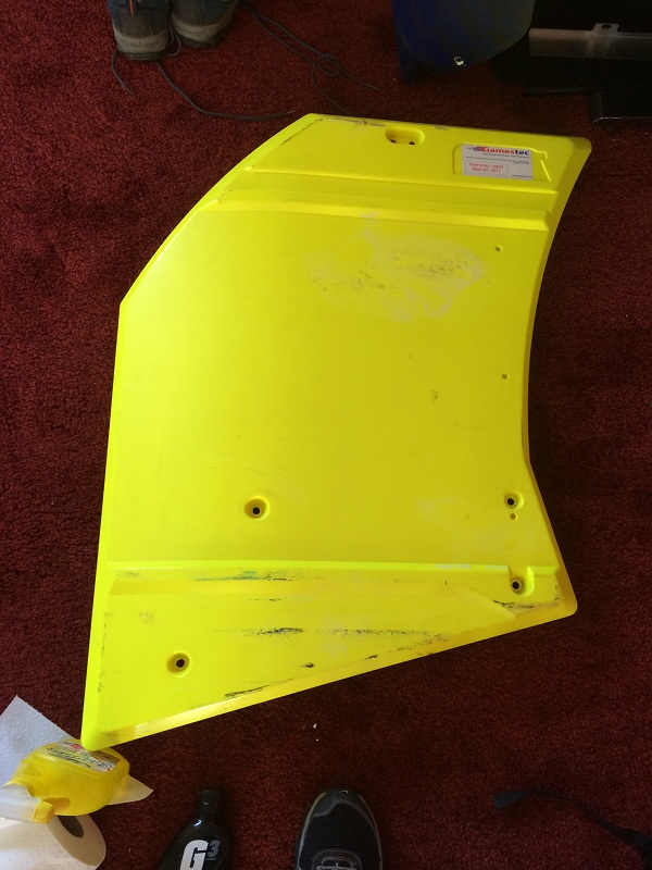

With the Daytona2 the sides were a bit tatty, scrathed and had no side art
I've never had much luck with plastic polishing as im far too lazy and usually give up after about 10 mins, but I forced myself to spend a few hours on each side and I think they came up ok.
Once this was done I could finally start to get things moving.

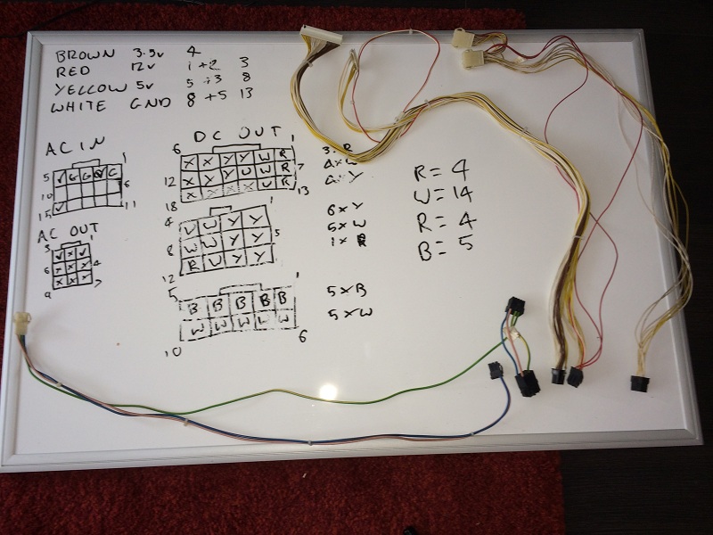

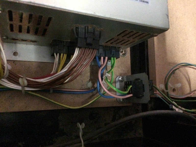

While i was waiting for my mate to help throw the monitors back in I figured Id take a look at the Daytona2 base and sort out the wiring.
Pretty hacked in PC supply and most of the original connectors were cut and gone :(
Dragged out the Whiteboard and started to work out all the pinouts, then created a new set of cables from scratch, I needed M3 power and also output for the rear fans, the scud helped as a reference to double check things.
and then install this and a proper M3 PSU.
