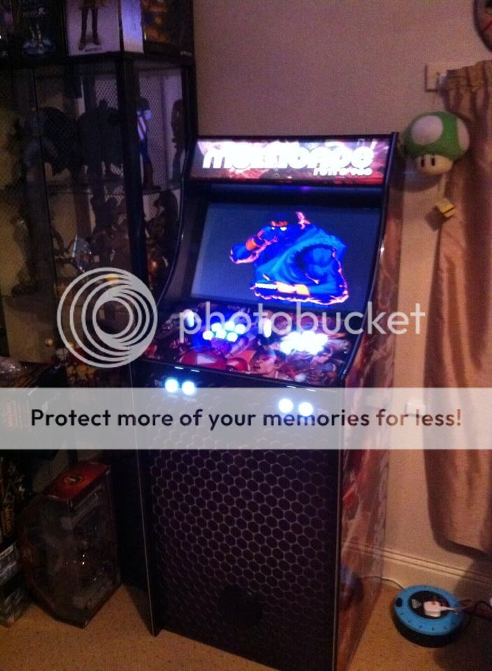

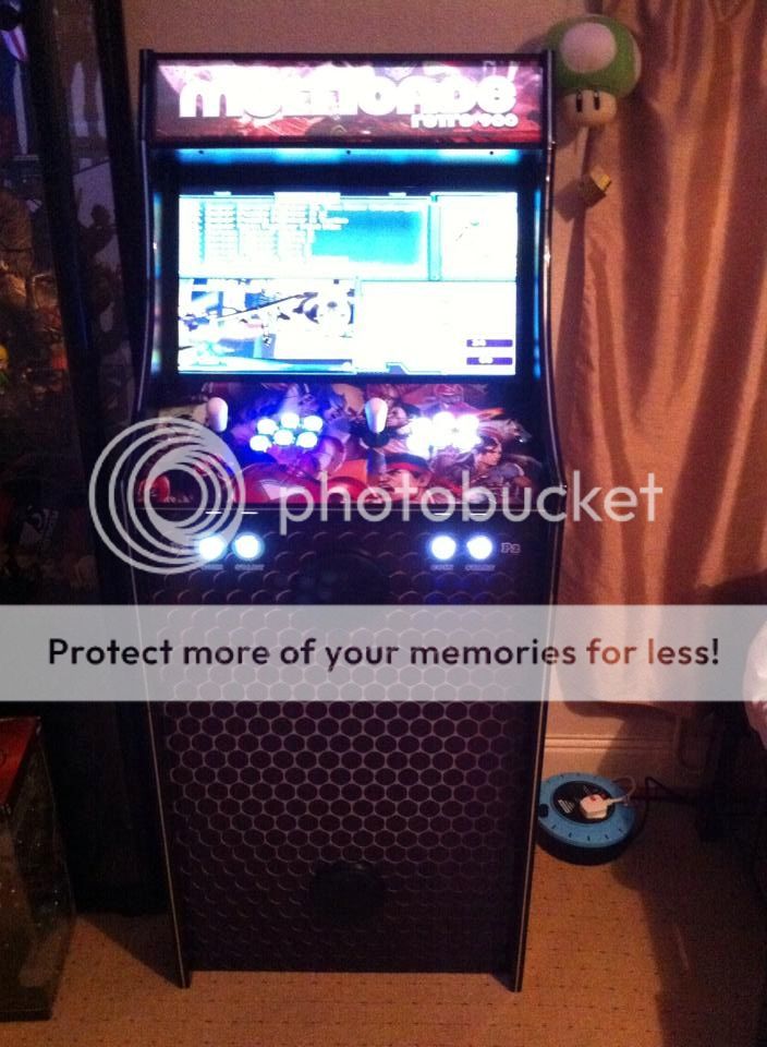

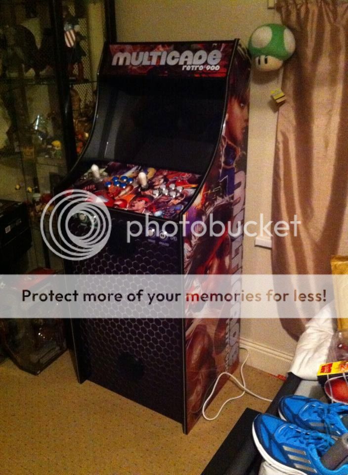

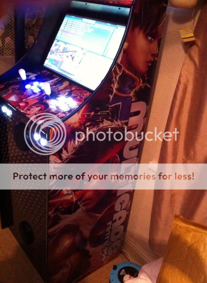

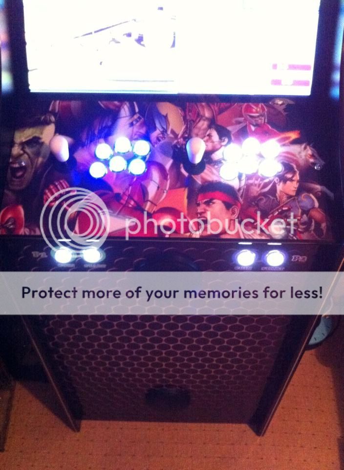

Hey guys, i did not buy the machine in the end. It was adding up as too much hassle transporting it, taking it apart, getting it into the house, finding a space in my room etc etc etc
I did however get a wooden cabinet with a game elf stuck in it
