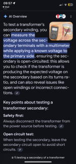

Testing the transformer yellow 2 wires for
100v Am I ok with ground probe & live probe either way round ?
AndyGeezer
580CR
Doesn't matter what way, but you should be reading around 100-110VAC from those two yellow wires, if not then trace to 240V going into the Transformer, very rare transformer goes bad TBH.
big10p
Coins detected in pocket!
5,675CR
AC current flow changes direction 50 times a second (50hz in UK), so it doesn't matter which way round the probes are on the terminals.
