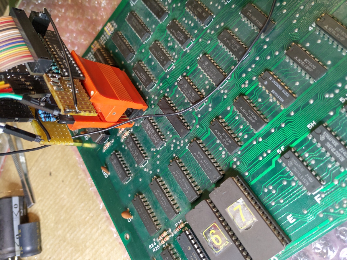

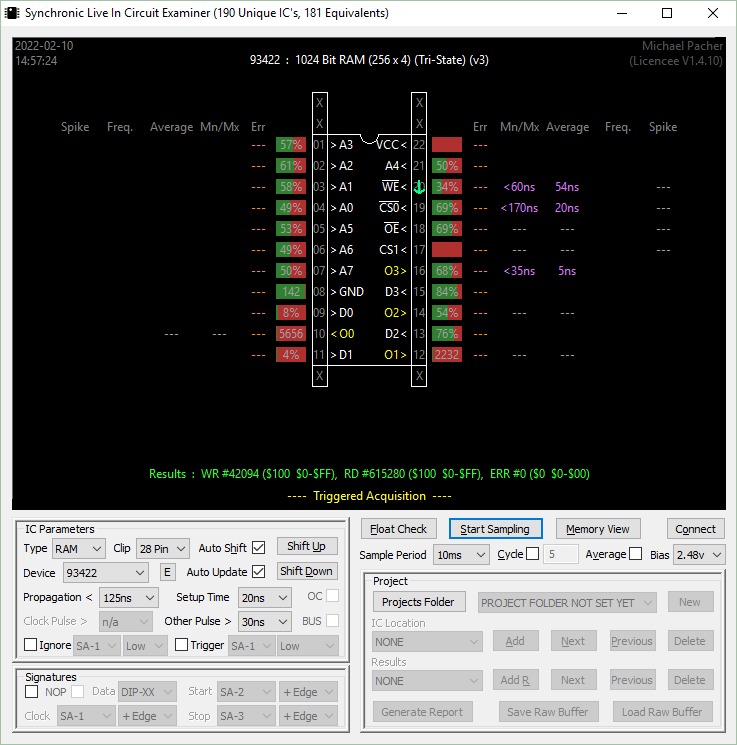

Thanks for your offer but I made a prototype for being able to do 28/32 (my was wrong 24/28) today. I needed this desperately.
It was a 15 minutes job, looks ugly but works perfectly.
I used an ORCA Looper board and measured the 22 pin 93422 RAM both with the original 24 cable from you and then with my prototype boards attached.
Both gave the same feedback, very positive!!
All the best and keep on doing the good work with Slice ... at last I can go on with so many repairs here involving 28 pins, have nearly 50 pcbs on my workbench ....

You will get some skew in the signals and may get some interference from straight ribbon, just keep an eye on the bottom 8 signals when using it just in case.
