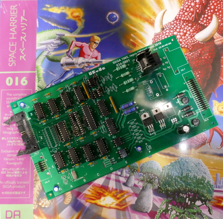

It was a pleasure to meet John and Colin today at NERG.
And John brought along the untested pro-type:
Looks absolutely fantastic... Good look with the testing guys....
John Bennett
5,203CR
Great to meet you, Colin and Neil too, Jim
. Respect to the vinyl Space Harrier soundtrack background too!
As for testing - I'd say weeks rather than months hopefully. It's 100% ready now (just successfully programmed the 22V10 GAL tonight
), so I'll start tomorrow. Got to take it slow as it's got different components to the original* and I've also got to make up (and document) stuff to test it as I go through it. Got a few other things on the go too, but I'm mindful you've got to keep momentum up on stuff like this (so it will get done).
*You can use original parts, but we're shipping with modern alternatives (set by jumpers), so the GAL code is new, the MOSFETs are new, the TRIAC circuit is new... (and it might not all work)John Bennett2018-07-16 21:40:05

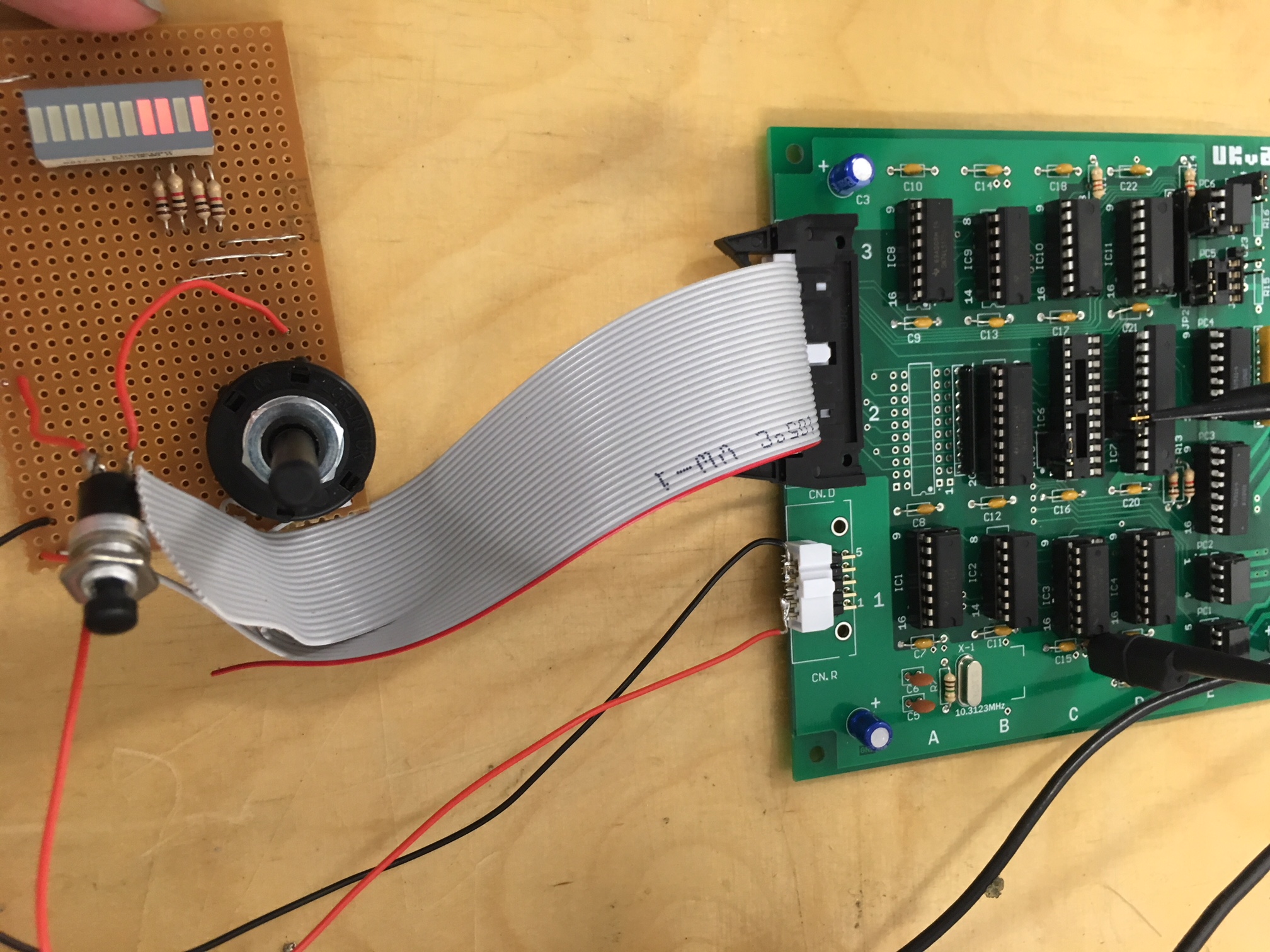

I managed to find an hour or so to start making a (crap looking) test harness (the LED display shows the binary dial output). I used a doorbell transformer to get the low-voltage AC into the unit.
and...
so far, it works.

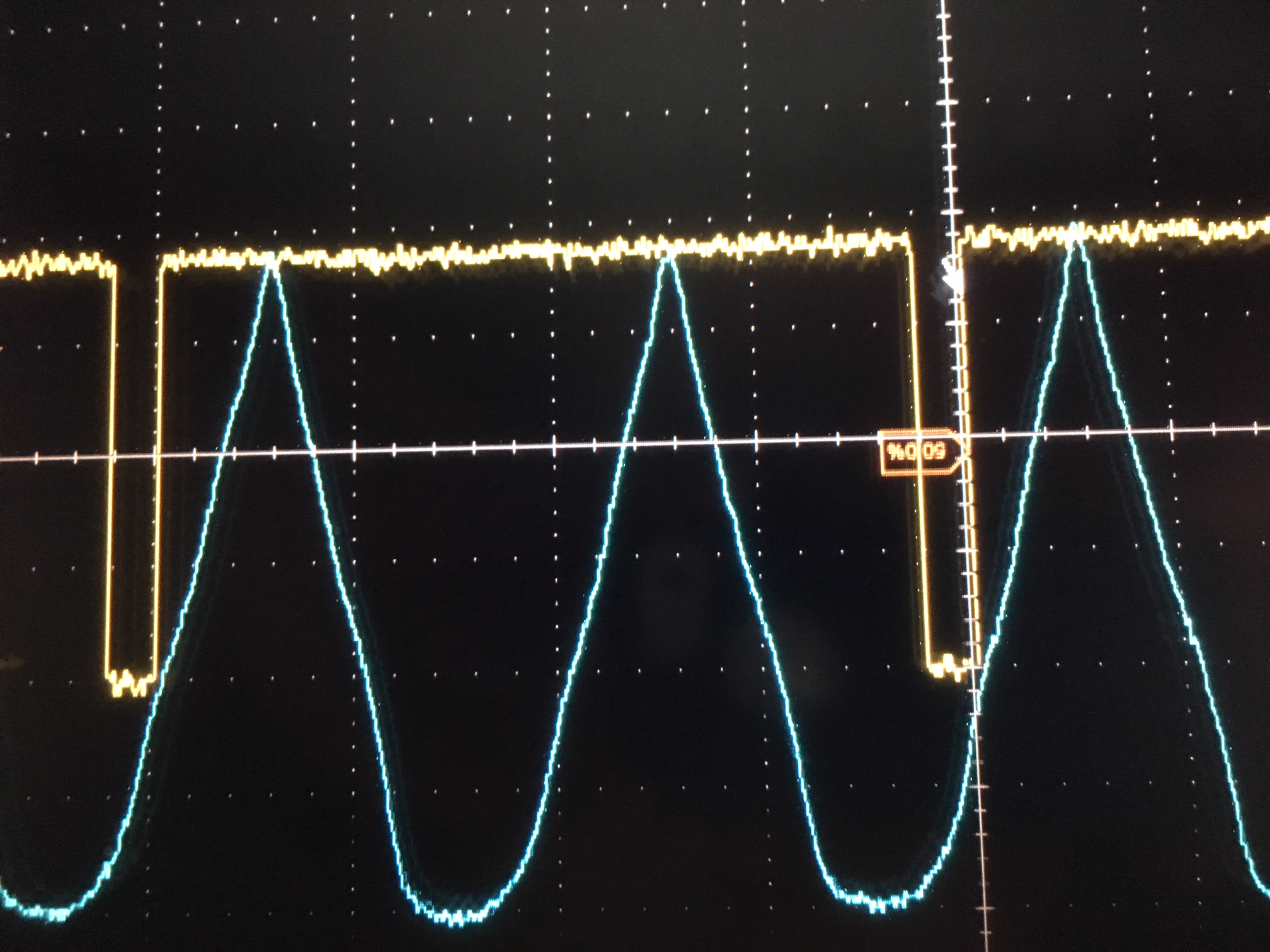

The unit syncs to the 50Hz mains and tries to put out a pulse at the correct phase to control the motor triac.
I didn't have a probe to get the mains properly, so what you see is a rectified mains (imagine every other hump is upside down), but you can see the pulse intended for the triac. It's phase/frequency locked as the synchronisation is working.
By adjusting the binary pot, I can move the pulse phase to various places in the positive and negative mains cycles (which will vary the speed and direction when it's all hooked up)
So a relief. This means the majority of the logic is working (we've copied it correctly) and that the GAL22V10 reworking of the original PAL is working (for the motor drive stage anyway).
