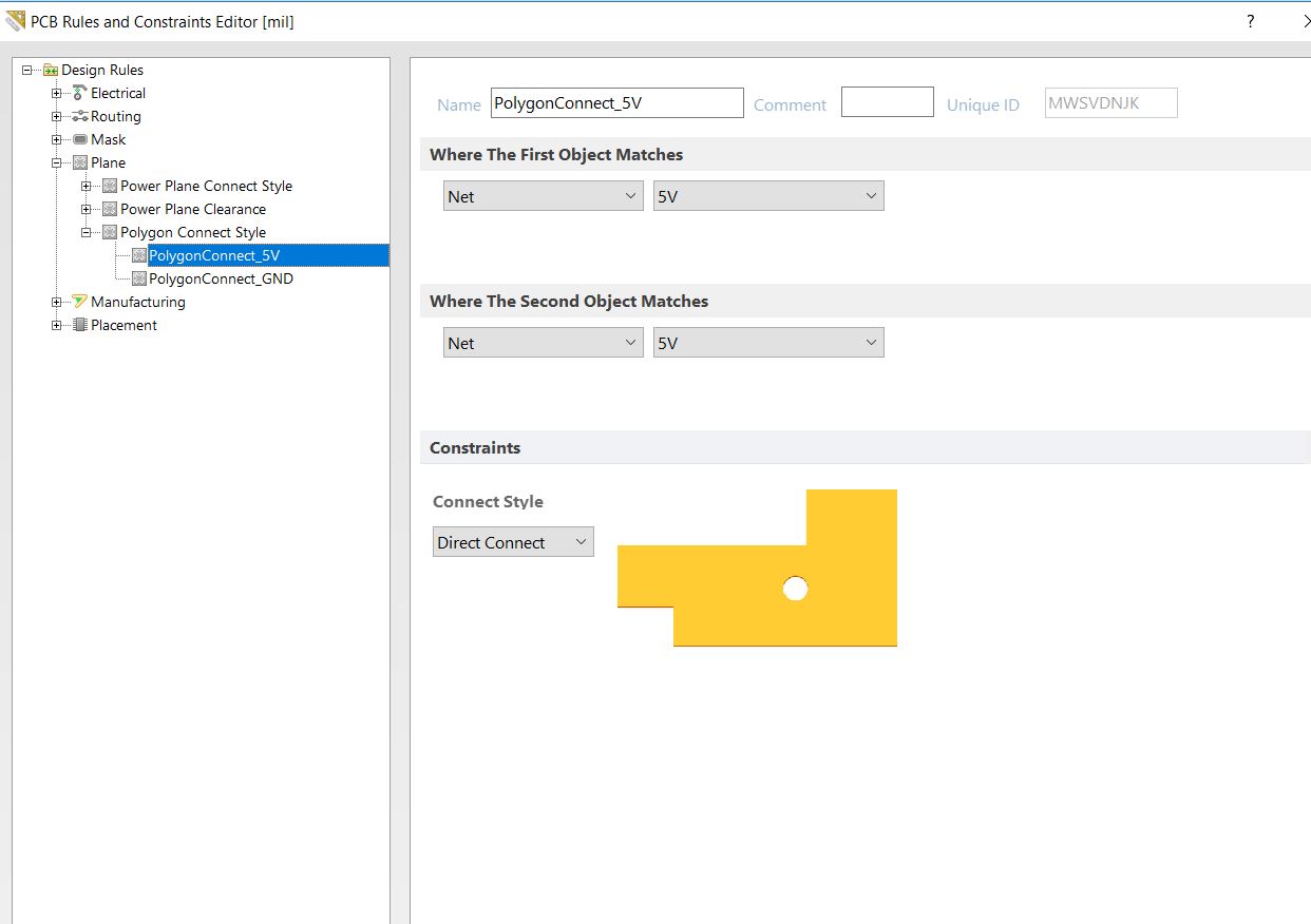

@John I think I understand what you mean, these kind of 4 little thin lines that CM makes from the poly to the component leg? I was wondering about them, and how to change. I will investigate.
@NaokiS tell me what the nickpick details were? Just so I can avoid doing again! thanks.
I've had a look and you can't specify the thermal relief for each polygon by right clicking.
What I think we've got to do is go into the design rules and create a rule for every net we've got a polygon on (as some want thermal reliefs, others don't). Fortunately there's not many.
I've done it for a couple so far.
I might name some of these power nets in the schematic as it makes it easier to find them in the drop-down list of nets.
Repour all polygons to update.
I can sort it tomorrow if it's too daunting.

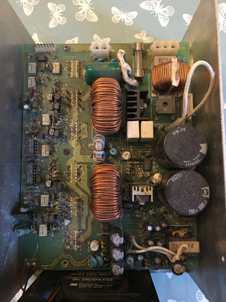

I'm sure there will be a few aussies interested in this board . What other games could use this motor controller board , G loc perhaps? Most G loc deluxes no longer move because the driver boards can no longer be repaired due to obsolete parts.

G-LOC looks rather different unfortunately. Funny looking board - bendy tracks that look like they're from the 70's, but looks like it uses power transistors rather than triacs (so more modern tech)
https://www.gamoover.net/Forums/index.php?topic=36585.0
(includes further links, albeit in French)
With G-loc (and pretty much anything really), it depends what schematics are out there or how easy it is to get ahold of a PCB. Oh and what demand there is. Nothing unclonable there I can see though.

on a different, previously brought up point, the RadMobile board looks radically (see what I did there?) different....

Good to know that G-LOC is the same as RadMobile. Is that your PCB?
tin
671CR
Oh wow I hadn't read the link you posted before for the GLOC thread on gamoover, can't believe it's the same! Yes that's my board. Not a clue if it works atm.
