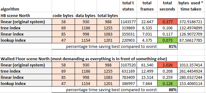

I spent some time writing code so that I could dynamically switch between the different compound lookup methods, so that I could test their effect on rendering, the results are interesting.
The lookup index manages to shave about 85% of the time taken by the original routine and as actually twice as quick on interesting scenes compared to the quicker index search methods 1 and 2. It does use 7% of the available ROM I have, which coupled with the renderer takes it to around 12% of the total ROM.
I'm decided to go with that method, but if I have to I can see that the other search methods are pretty quick and could be used if I get desperate.
I'll record a video showing the rendering tomorrow and you'll be able to see the speed differences quite clearly as I unlocked the view rotation so it runs continuously.

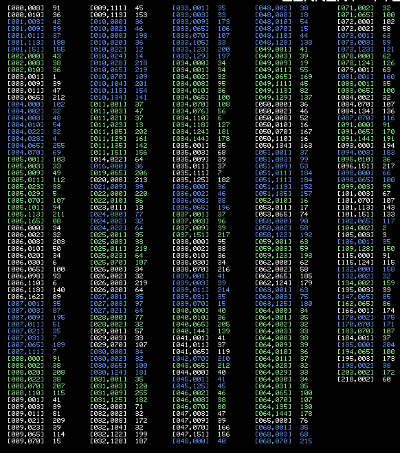

Here's a spreadsheet of the data to look at and the two scenes being rendered.
