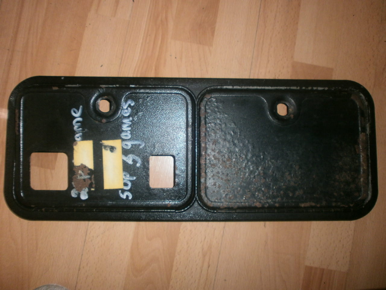

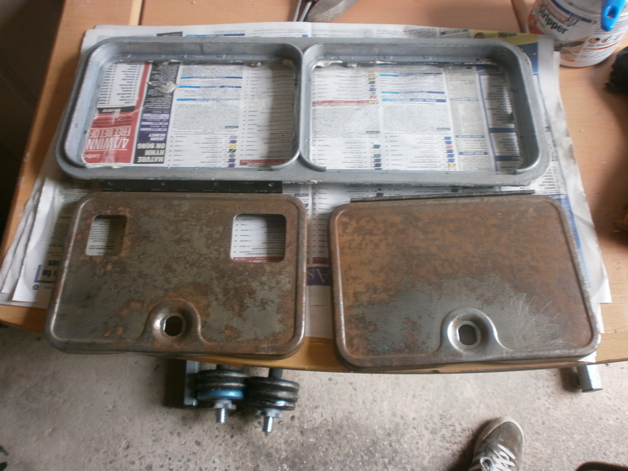

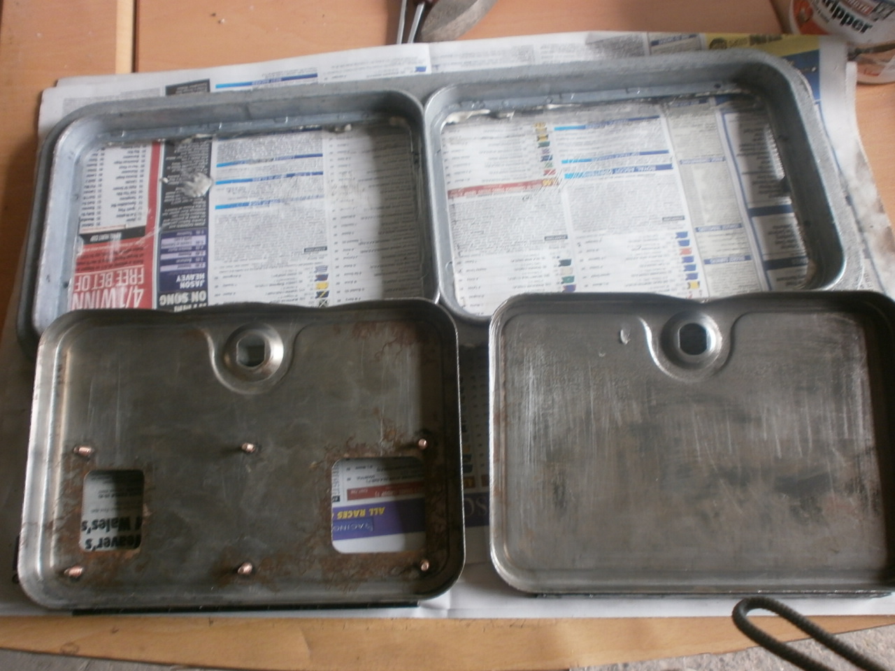

Ok back with a bit more done have been waiting for parts and such and time just flies , took the coin doors off as they were in a real bad state , got them down to bare metal using paint stripper a srewdriver a wire brush and some wire wool, i also straightened out the door edges where they had been broken into at some point , they are now ready for paint and i will be taking them to the powder coaters soon for that leatherette finish

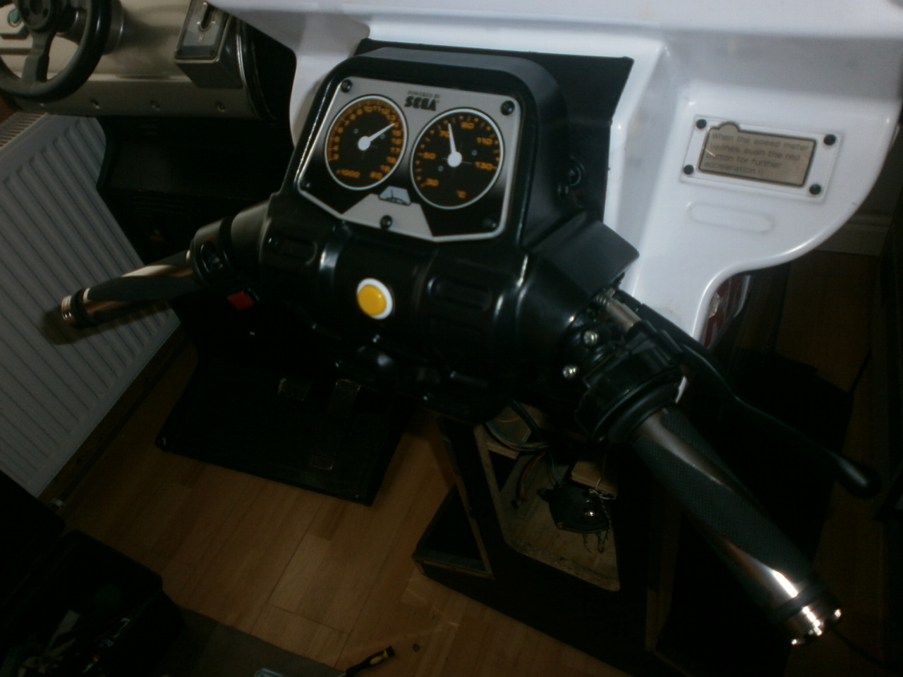

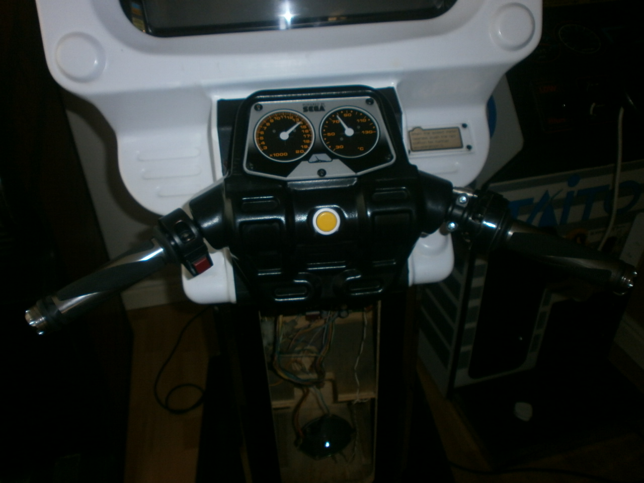

i have also put the handle bars back together now i have replace the broken brake cable and the missing brake lever also got some new grips that i liked the look of think they look a bit better than just the standard black grips, still need to sort out the return spring in the throttle just cant see how that works
got the light working under the clocks thanks to duncan for the bulbs
 i can now play it properly now its all bolted back together as when i bought it the 2 bolts that hold the steering on were mising and replaced with one wrong bolt , you could pull the handle bars back and forth about a inch,also the throttle was stuck on full so now works as it should :)

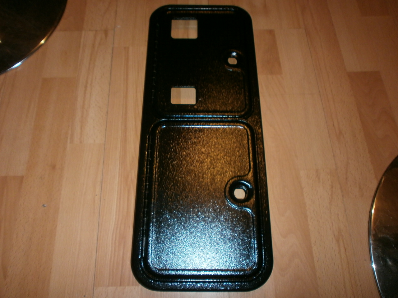

finally got the coin doors powder coated
just got to fit them now a nice little job for the weekend , i could do with a couple of locks with keys if anybody has some spare for sale
