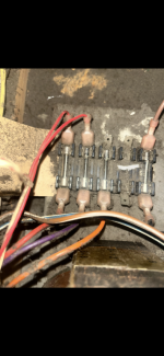

Would anyone have some good pics of roadblasters power supply
I’m wanting to find where the yellow wire
And the black and white (marquee?) connect
I thought the marquee build or starter needed replace ,then found the wires and think I’ve upset the yellow wire ?

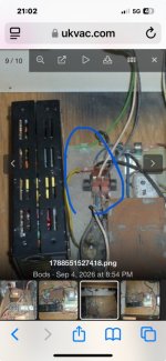

It’s similar for sure
In that pic of your sprint
It looks like black and white go to top connectors of that block
Hard to see the yellow

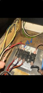

I’m wondering now if that yellow wire was connected
Is it for usa power and blue for uk
I put the black and white wires ,old marquee bulb and starter and it was all working .
But now it’s cutting out .
It’s very dusty around fuse holders ,su will try and clean all that

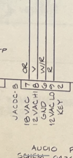

Got this from manual .cant really see anything from it
When I plugged that yellow wire in it blew fuse

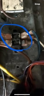

5,202CR
I don't think the Yellow is connected as I have another PSU i bought for my Toobin as It was missing completely and I had to make my own up and just looked at that yellow is just loose as well, must be different voltage input to transformer as only blue and brown are connected, typical in my other photo's it makes it look like its connected to the terminal block but just were it landed for some reason

I put a new switcher in it ,just incase
Turns out after isolating the loads it’s the transformer iso that’s smoking
Does this have to be the exact one for a system 1

The iso that’s there powers that audio 2 board mentioned in thread below
So I can possibly disconnect that and use and amplifier of some description ,using 12 v from the switcher and all should be well ?
