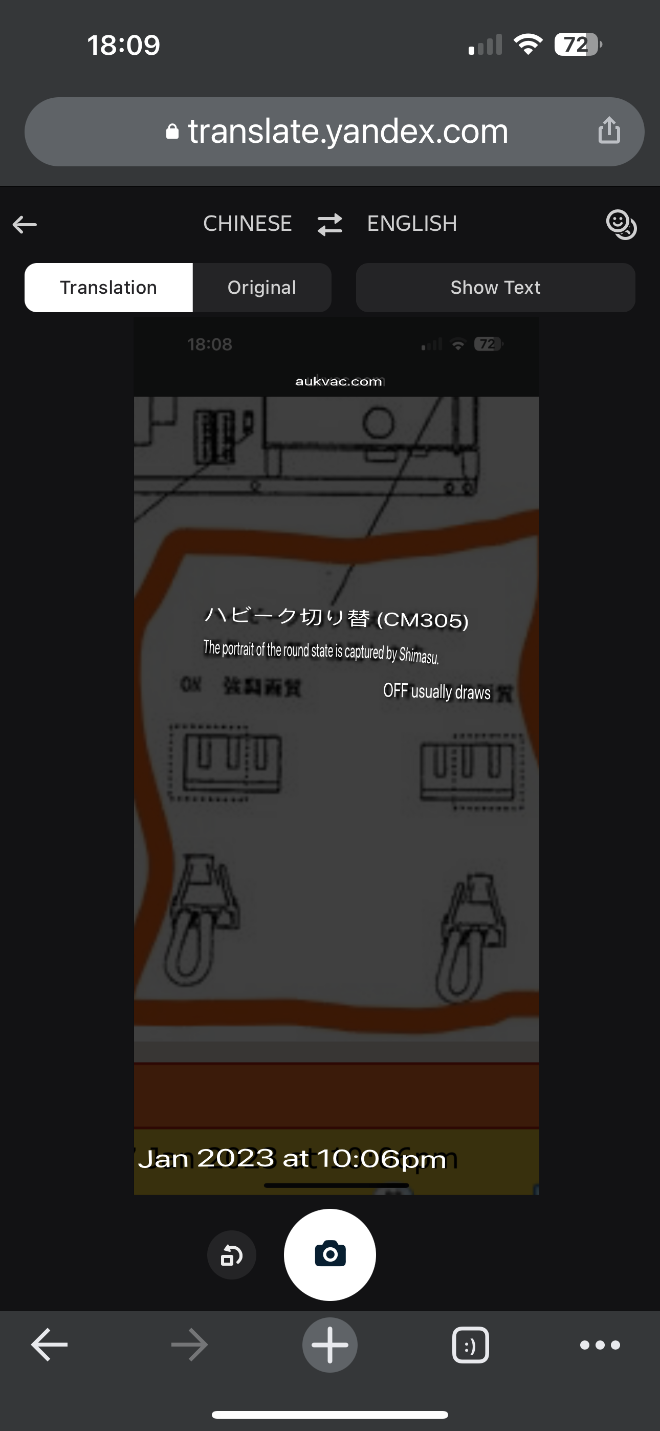

I've just been setting up this TOEI TC-RM251S chassis ready to install into a cab of mine, I noticed this wired jumper markled 'on' / 'off' on the chassis and I've highlighted it below from a manual page, does anyone know what it does / is for?

Difficult to know (i've never worked on one myself) but as it's highlighted on the a page showing image adjustments, it could be something like a test pattern or something. I wouldn't mess with it till you know though. Could probably work out from the schematic what it does.

Yup, I've left it in the position I received the chassis in, nor have I tried swapping the jumper when powered up.

Still not 100% sure what it means, however it looks like I may give it a try to see if I notice any difference, it might be related to the 'Wide' jumper located elsewhere on the chassis.
Also looks like the word SHIMASU is a verb that means "to do something."

This is what CoPilot says:
Translation of the orange‑boxed text
ハイピーク切り替え(CM305)
→ High‑Peak Switching (CM305)
ON:強調画質
→ ON: Enhanced Image Quality
OFF:通常画質
→ OFF: Normal Image Quality
What “Enhanced Image Quality” actually does
This switch (ハイピーク切り替え / High‑Peak Switching) changes how the display’s video amplifier handles high‑brightness peaks and edge transitions.
🔧 When set to ON — 強調画質 (Enhanced Image Quality)
Higher peak brightness — whites and highlights are pushed harder
Stronger edge contrast — outlines and fine details appear more defined
Perceived sharpness increases — the image looks crisper
More aggressive signal processing — the circuit emphasizes high‑frequency components
This mode is typically used when the source image looks soft, low‑contrast, or washed out.
🔧 When set to OFF — 通常画質 (Normal Image Quality)
More accurate, natural contrast
Lower risk of clipping in bright areas
Less haloing or ringing around edges
Better for colour‑critical or calibration work
Why this exists
Older or professional CRT‑based monitors often included a “high‑peak” or “aperture boost” circuit to compensate for weak video sources or long cable runs. Turning it on gives the picture more punch, but at the cost of accuracy.
Should you use it?
If you want a punchier, sharper‑looking image, use Enhanced mode.
If you want accurate colour and clean calibration, stick with Normal mode.

There’s a similar three way switch on the TC252 chassis which is a 25inch Toei chassis’s it just gives a little contrast boost as described above. Not a jumper though
