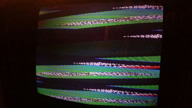

I picked up another faulty track and field board which wouldn't sync.

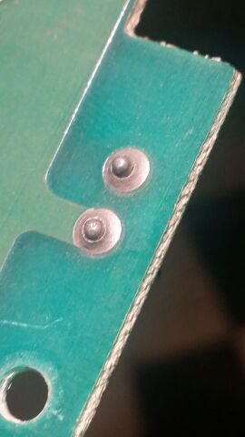

A quick inspection revealed a couple of issues:
Missing caps and dry joints on the power connections:
After replacing the caps and fixing the dry joints I fired it up.

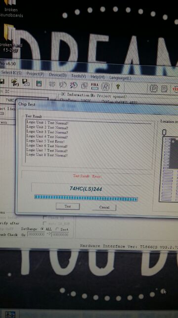

After a bit of research I decided to start at the 74ls244 @ C1. Hooked up the probe and pin 9 was stuck low. So I pulled it out, checked it on the mini pro, to confirm it was bad.
Replacing it fixed the sync issue but revealed more issues.

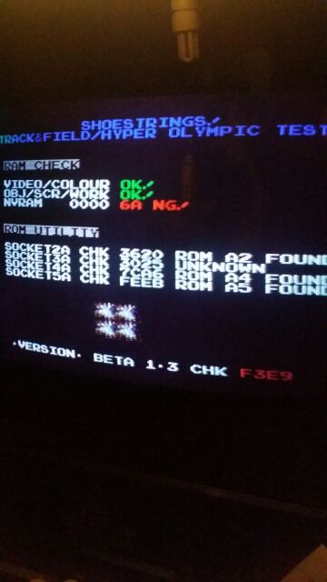

This point seamed a good time to try the test rom.
Replaced bad 2114 @ 11B
This is as far as I had time to go tonight. So we have a rom/socket problem @ A3 and bad sram at 6A, I'll be replacing this stuff tomorrow night.
This test rom is great from shoestring.Shinydaz2017-03-02 15:22:20

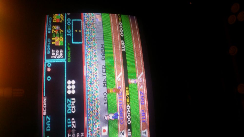

So I Swapped out the rom at A3.

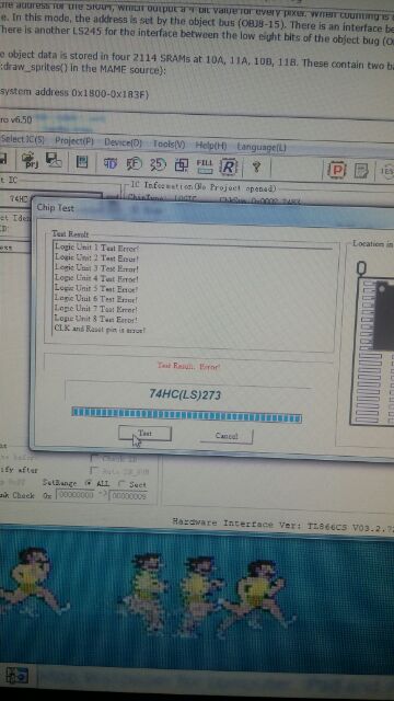

I still had sprite problems.
So I probed the 74LS243 @ 15A and there was no output at pin 9. Pulled it out and ran it through the minipro.
Pulled one off a donor board and voila.
I think I got lucky fixing this, but I'm learning everyday. Maybe the next step is to buy an oscilloscope.Shinydaz2017-03-03 04:04:04
