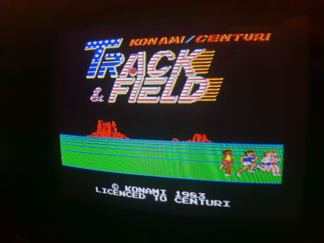

Only a small fault on this one, the red was missing on the 'ack and field' writing on the main screen and also the red mountains. After probing the section around the roms/proms that hold the data, I came to the conclusion it could only be the prom at fault at 15E. After replacing it, all the red colour returned.
