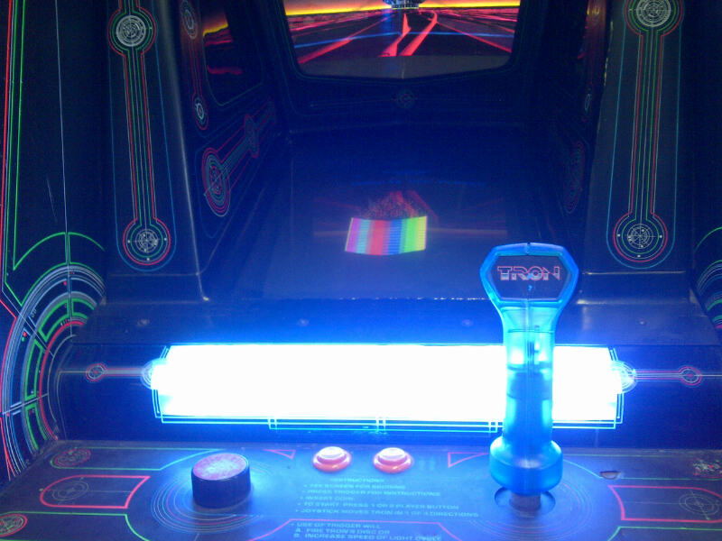

Our Tron is coming along nicely and I found a UK company to source replacement neon light bulbs.
As you can see from the picture below it is _very_ bright so I wonder if we are missing a bit of shield from the light somewhere?
If you look at the second picture below it looks like there's an extra cover or something to make it more purple.
Anyone know what I'm talking about and/or have a spare one with less fading of the colours?
Many thanks!

I think also maybe that they are using a different colour of UV tube as it definitely looks more 'purple'
I'm using a Black Light - Fluorescent Blacklight 15 watt T8 450mm - but maybe there is also a 'purple' version as the same people I got the above from have a 'blue' version
Mine:
https://www.bltdirect.com/product.php?pid=1488&
Blue one:
https://www.bltdirect.com/product.php?pid=26336&
Even the one shown on Phoenix arcade looks _very_ purple :)
Thanks again!

Do not use the Blacklight white in there! These are not supposed to be used where you can view them directly, they can cause damage to your eyesight. Tron needs the blacklight blue there. This has a filter to protect your eyesight but still give the UV glow in the dark effect.

So would one of these do the trick - and should they both be Blue ones?

mine is blacklight as dan says!
marque isnt thoe
try local disco suppliers mine sells them for £2 each,so i got a few heheh,and 4ft ones
nice tron btw

Marquee = normal white light
Above Control Panel (that you can see) = Black light Blue
Below Control Panel (behind plexi) = Black light White
Dan
Judder
998CR
Perfect - I'll purchase one of those eBay blue ones, and keep the other white one for spares
