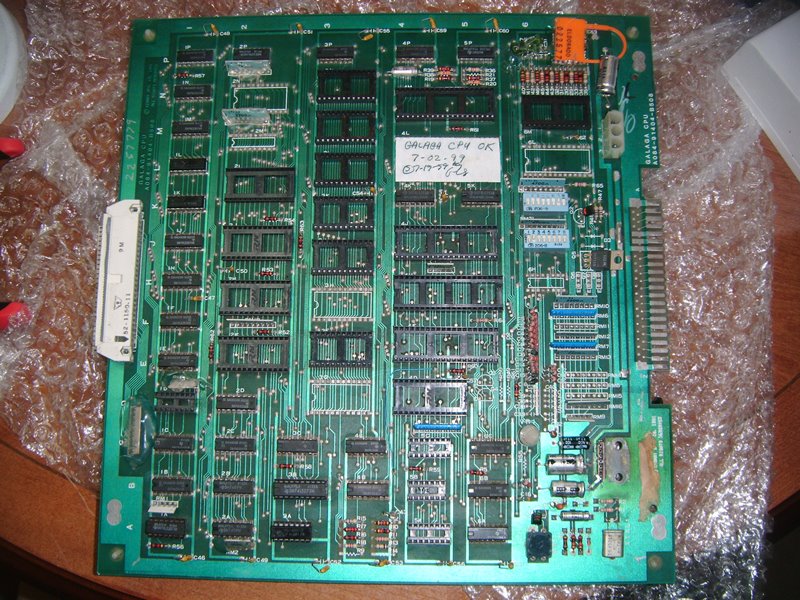

This is U72's Galaga PCB I said I would repair. I picked this up from Expo but to be honest it's taken me so long because I'd had other things to do and had 'gone off' repairing. With Christmas holiday of 2 weeks though I had some time on my hands. This is the fix on the graphic board. The CPU board and the graphics board have both been worked on. I'd given up partially on the CPU board since it's been hacked quite a bit. I have found a broken trace, unrepaired, and I'm wondering if all the hacking is to compensate for this. I'll remove it all later and patch the trace. The only reason I'm going to do this is because I now have a spare working CPU board.

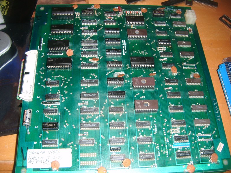

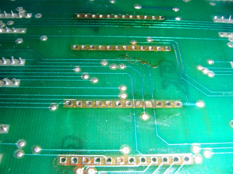

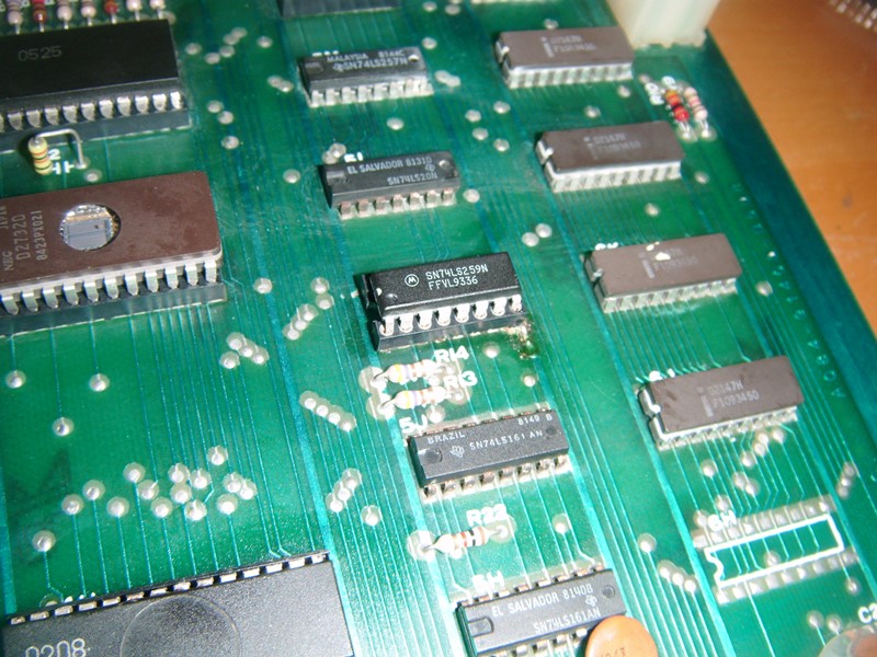

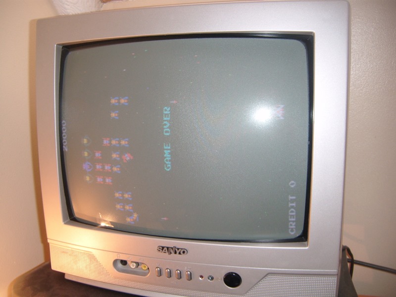

After changing a failed custom (07xx) and a RAM at 3H I was getting blocks as characters on the video. Something had been spilled on the board over customs at 1K, 1L & 1N. Decided to replace all the sockets. I didn't photograph this part. This was the board up to know.
And this is what I was getting - rotating characters which were the wrong type. Everything was wrong - shots, explosions, characters.

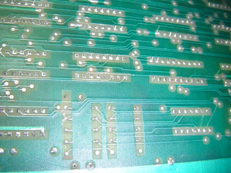

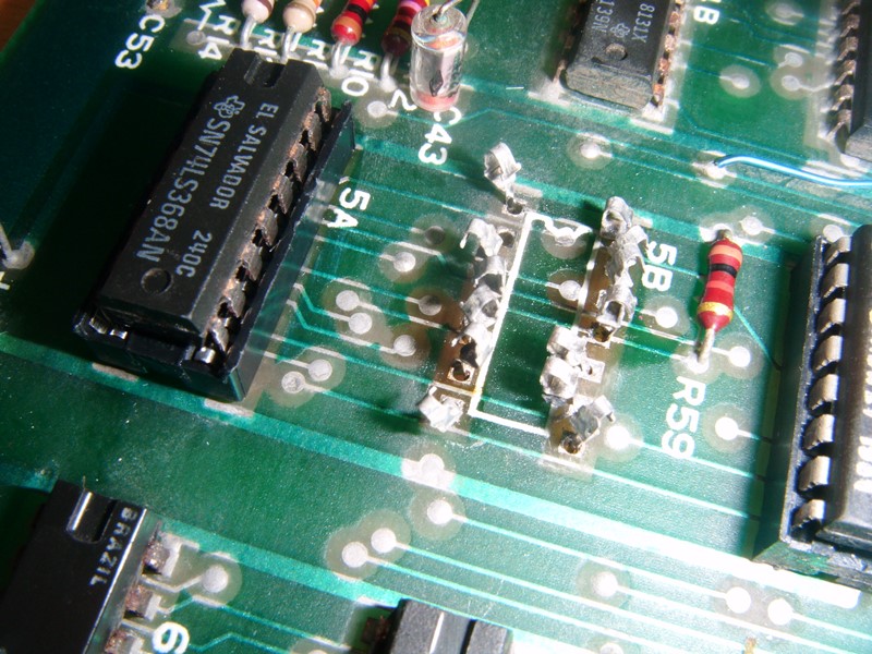

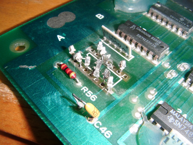

As mentioned previously, the board had been worked on before - here is some of the handy work. I really don't like working on such boards.

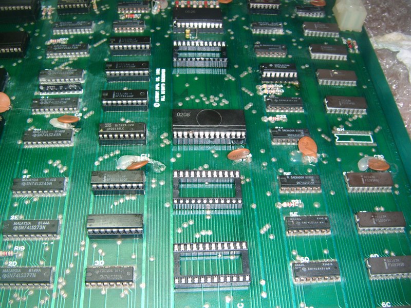

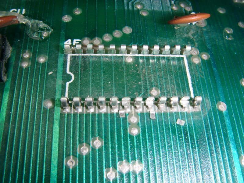

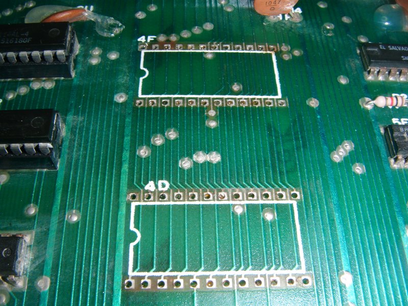

Since the characters were messed up, I decided it would be a good time to replace the character ROM sockets. After pealing off the housings I was greeted with three broken pins. Looking promising.
Removed all the pins - this is my handy work on the top.
And again on the solder side.
New sockets now installed.

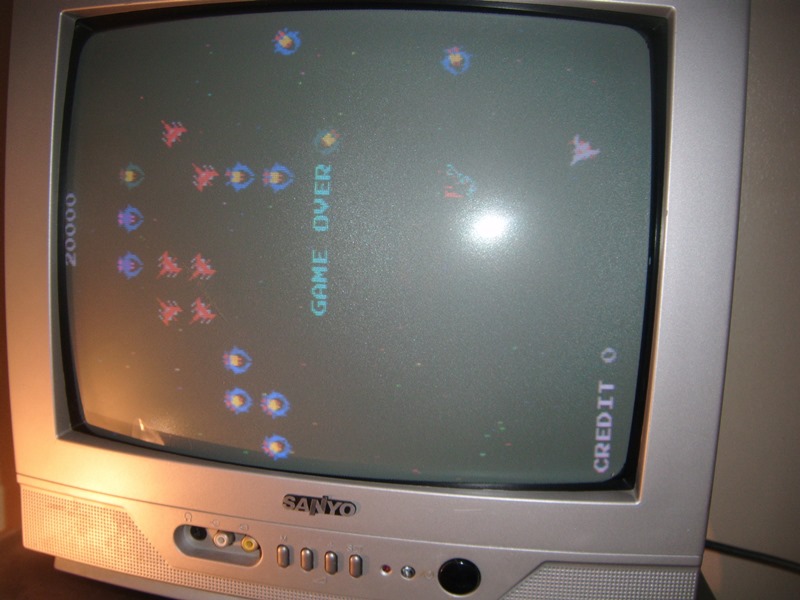

and voila, we have cured the video issues.

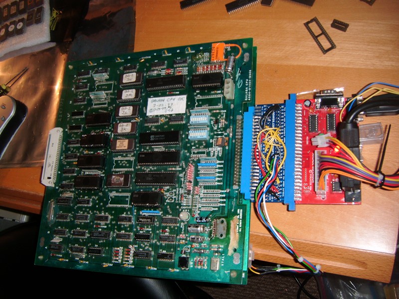

The board now boots but there is an issue with one of the ROM sockets on the CPU board. Board re-sets about every minute and I've tracked that down to one or two sockets.

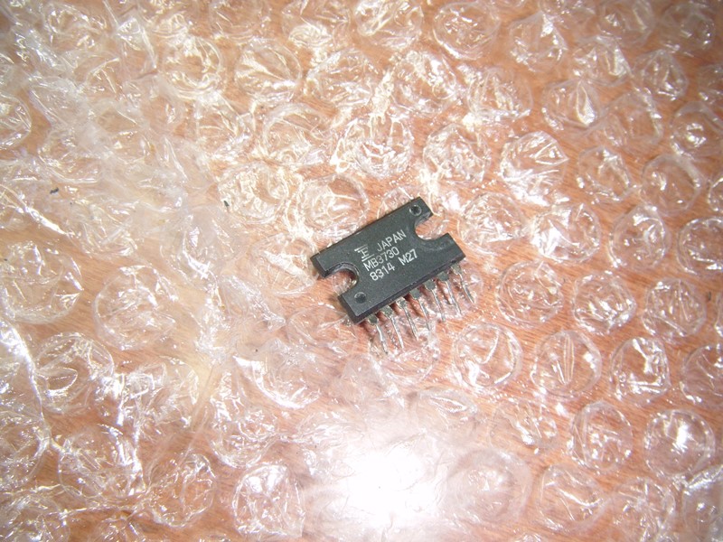

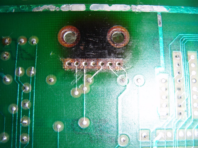

I've removed the amp because it nearly took my skin off when I first tested it. I know there is a broken trace to pin 7 of the amp but it could be another issue. The break is so close to the soldering eye it may have been making contact. I'm going to order a new amp anyway.
Here is the board pre-socket change on the customs ICs.

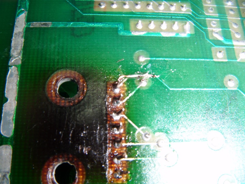

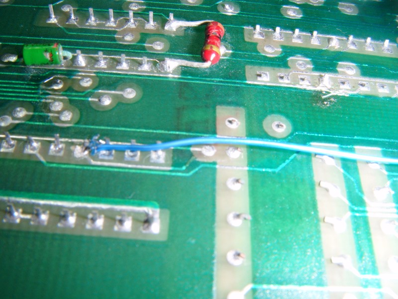

Here is the trace and other components, notice how scorched the area around the amp is.

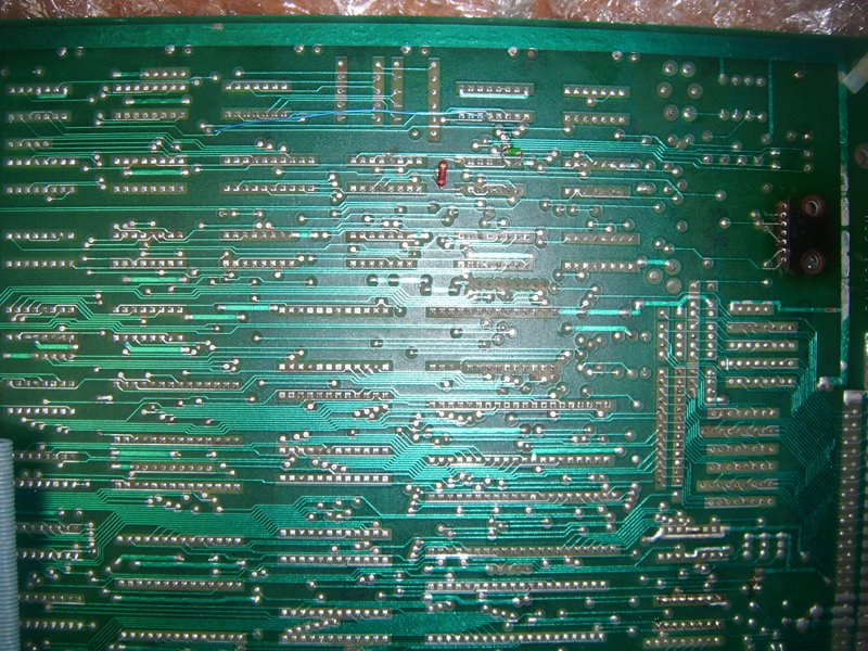

Here is the broken trace.
Here it is on a good board. This doesn't feature on other versions of the board. As far as I know there are board versions A to D.

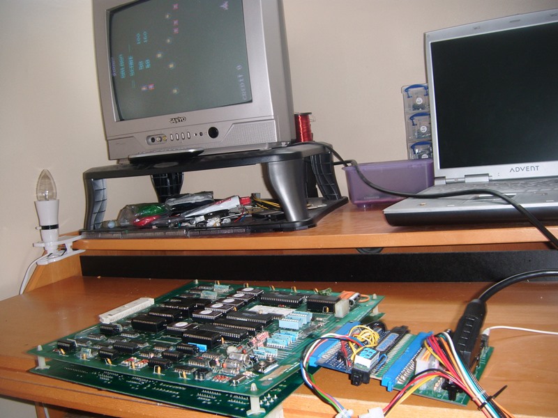

Here is the board on the test rig working but resetting. I'll have to order the amp which will take a while but in the mean time I'll replace all the ROM sockets to make sure the board is a lot more reliable. ROM E needs to be burned also, that one is on loan from my test board - I've order a batch of chips from Germany.

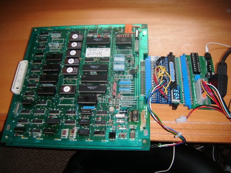

Both boards are now fully repaired and re-furbished. Andy wanted a board with stability and wasn't particularly bothered what it looked like at the end of the day. All the important sockets have been replaced along with good customs sat in sockets, most have new legs attached.

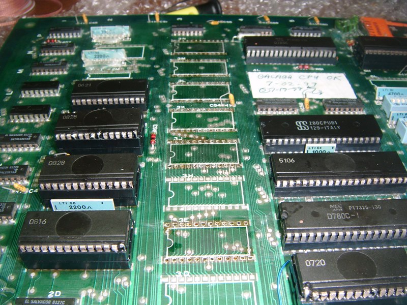

Finally, then. Board was re-setting so removed all the ROM sockets.
and replaced them with nice new ones. The board is now solid no re-setting. I hate turned pin sockets BTW don't expect me to recommend them.
After removing the amp months ago, I couldn't find it for about 2 hours. I had stored it somewhere safe, that I couldn't remember. Eventually found it and thought might as well put it back in. Nothing to lose really.
Next though, that broken trace on pin 7 of the amp socket.
Using 2 twined 0.2 copper wires I made a repair over the break rather than solder over. The board is looking a bit fried there.

Awesome tech thread - amazed how much that amp burnt the PCB.
I've seen a few of those MB3730's do that.
IIRC, they are self-referenced for the speaker return so if you get a ground short they go supernova very quickly and pop, if you have an intermittent leak to ground or the return trace is bad they will superheat but stay working and do that to the board.

MB3730 amps, agreed as James mentioned, seen a few other boards with the over-heat issue.. :-(

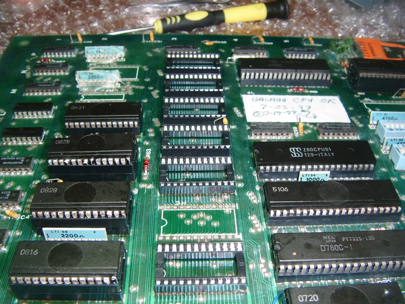

To fix the board I've had to replace every socket on the CPU board, every single one and all were bad (23 in total on the CPU board). I replaced the final 2 this afternoon and the PCB is finally stable. Couple this with having a brand new Z80A packing in immediately and it's been quite a journey and one I won't be doing again. This is the only board I've repaired for someone else and from now on I'll be sticking to what I've always down, repairing only my own. I don't have the equipment, yet, do to this sort of thing properly. I'm still after a Fluke in the wanted section. I'll just keep wanting and waiting.
Bad pins.
More bad pins.
Finally got 4.93 volts in it.
And working again.
