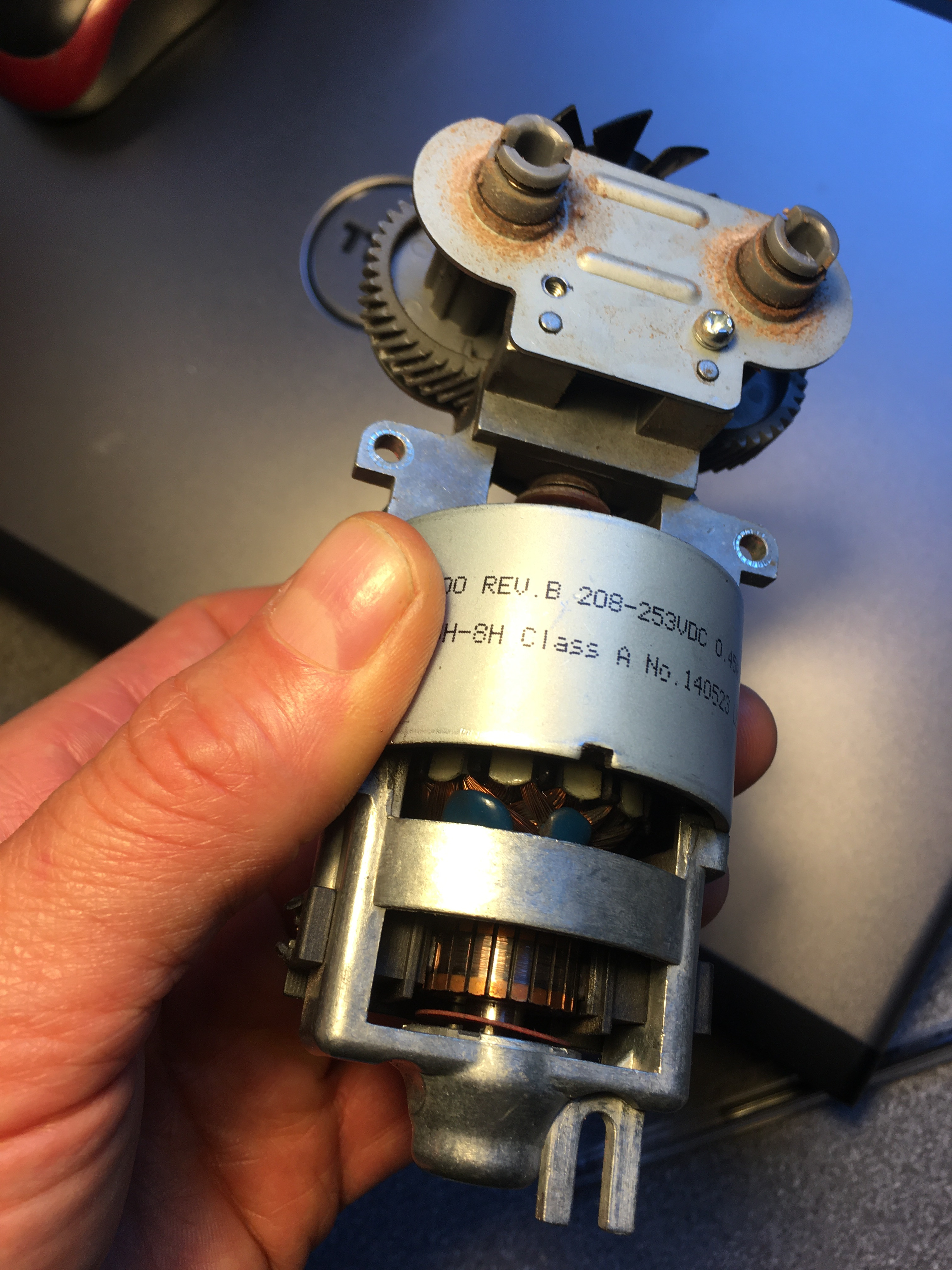

Hmmmm, so I decided to replace the fuse and give it another test...
Errrrrr, I think it's pretty terminal now. Sorry chaps.

322CR
