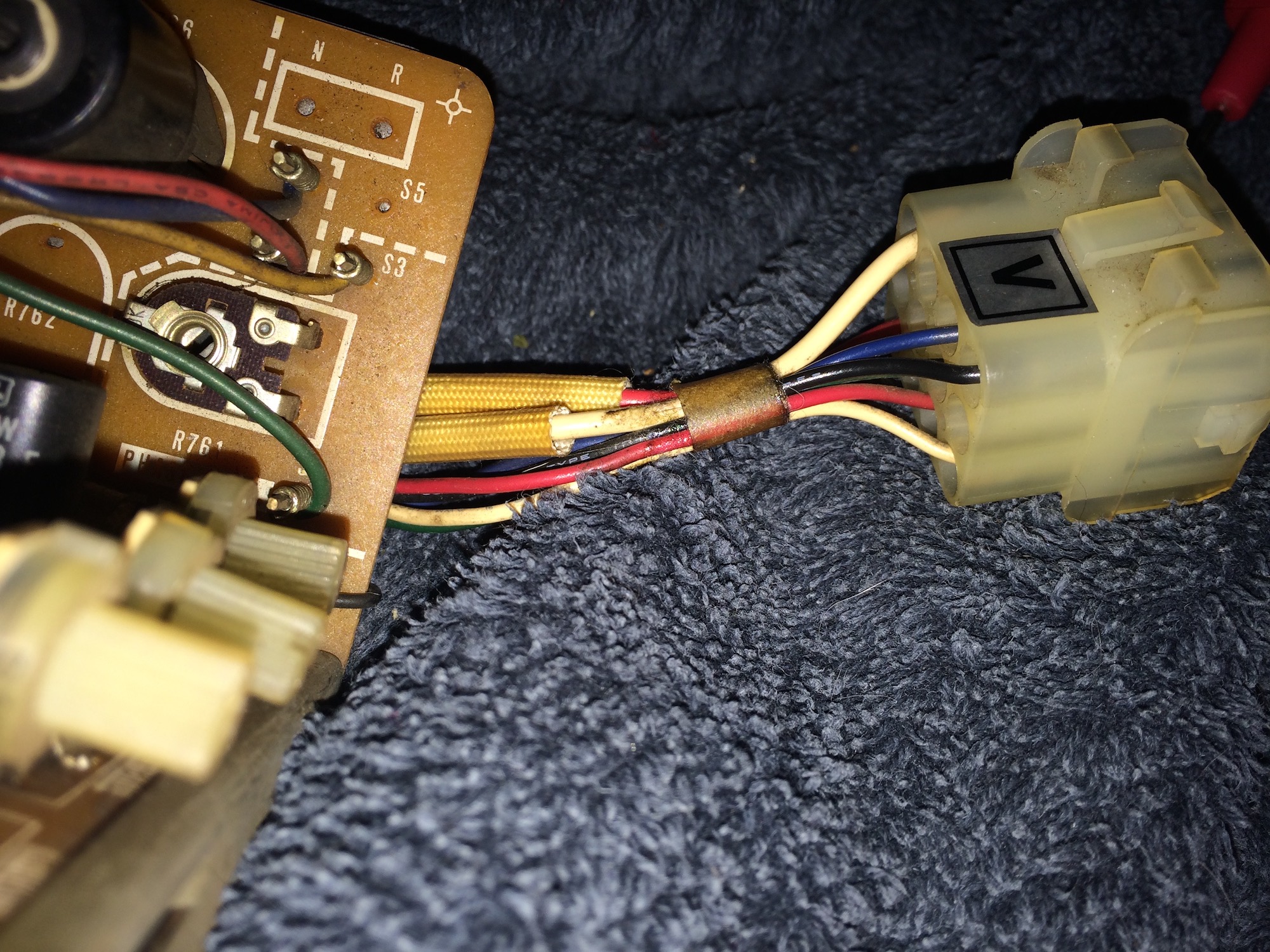

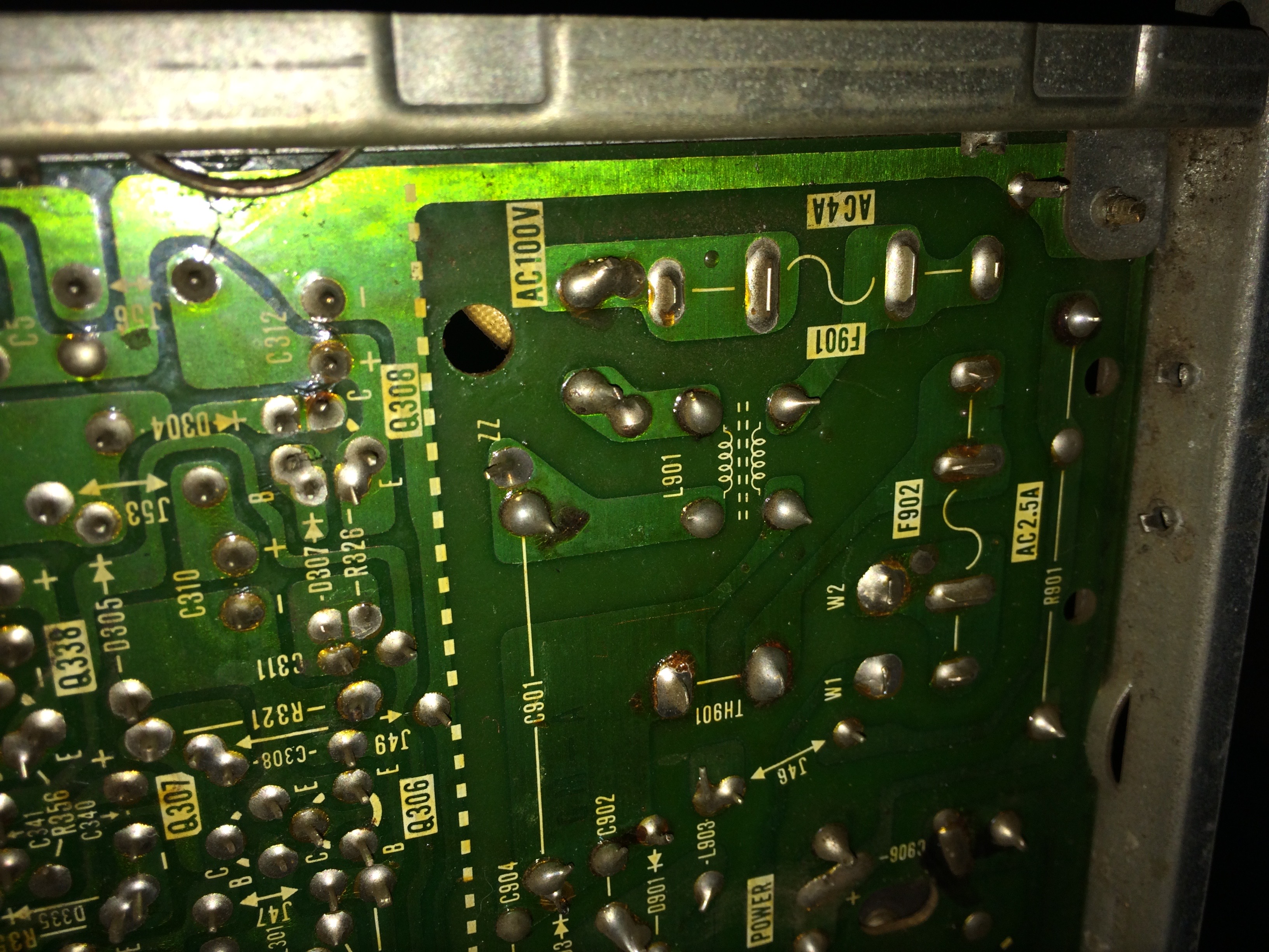

The monitor takes 120V from the transformer, but where it connects on the chassis, I cant work out which is + and which is -
Does it matter which way round I connect the 2x 120V cables to the monitor (via the plug) ?
Can anyone help - advice would be appreciated as this has me stumped and I don't want to blow it all up now :)
Here's some pictures:
Edge of monitor chassis showing the monitors plug. (My new plug /cable will plug into this one)
The 2 power cables connect to the monitor chassis in the photo below, the dirty white braided cover cables (inside the cable covers: 1 is red, 1 is white):

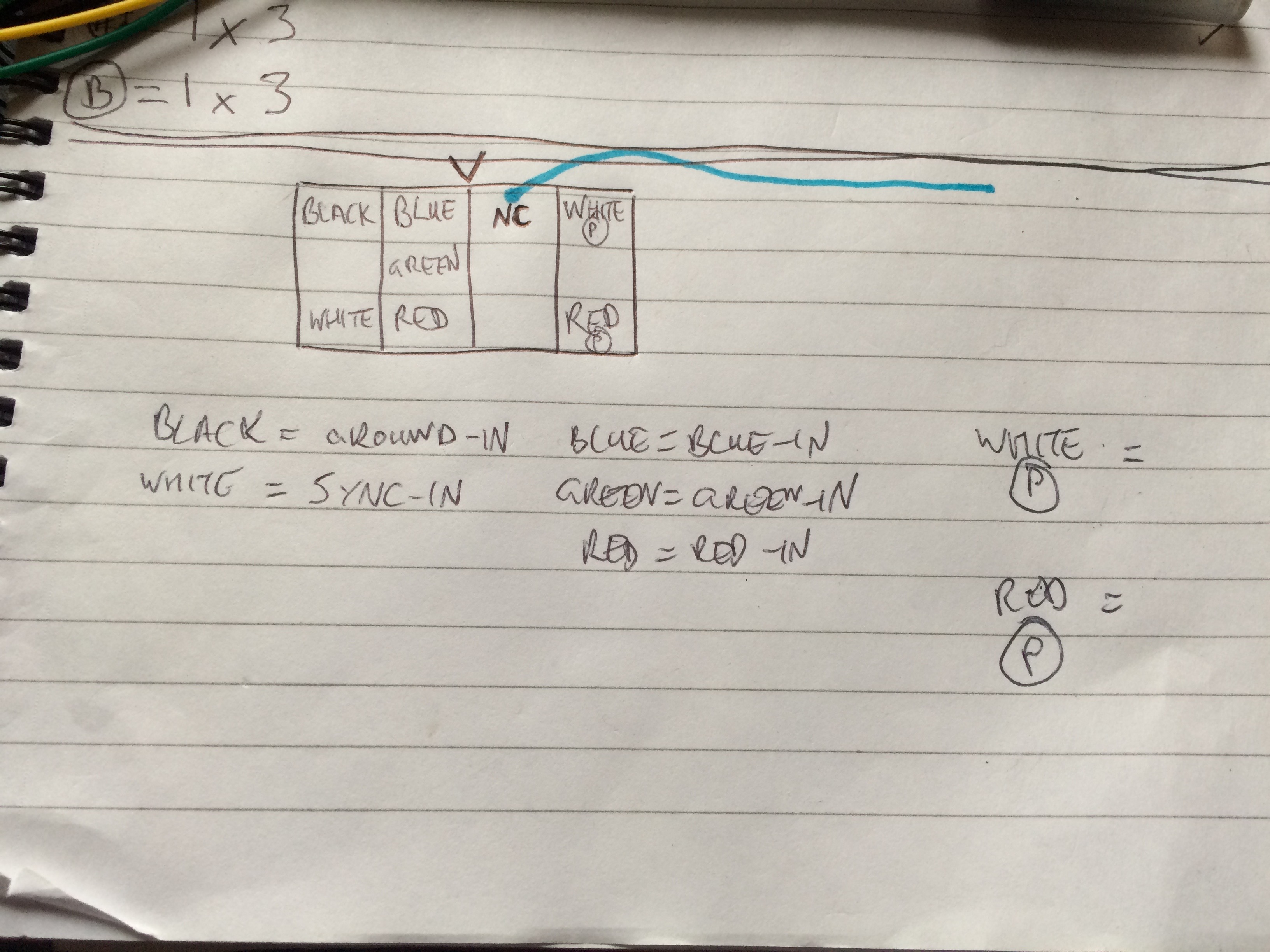

I made this diagram while using multimeter to continuity test where each pin went, as if you're looking into the plug that comes from the monitor:

It's 120V AC so there is no + and - . It doesn't matter how the wires are connected as long as they provide the proper AC voltage. It's however important that you use an isolation transformer for the 120V. Only rather modern monitor chassis work without one.

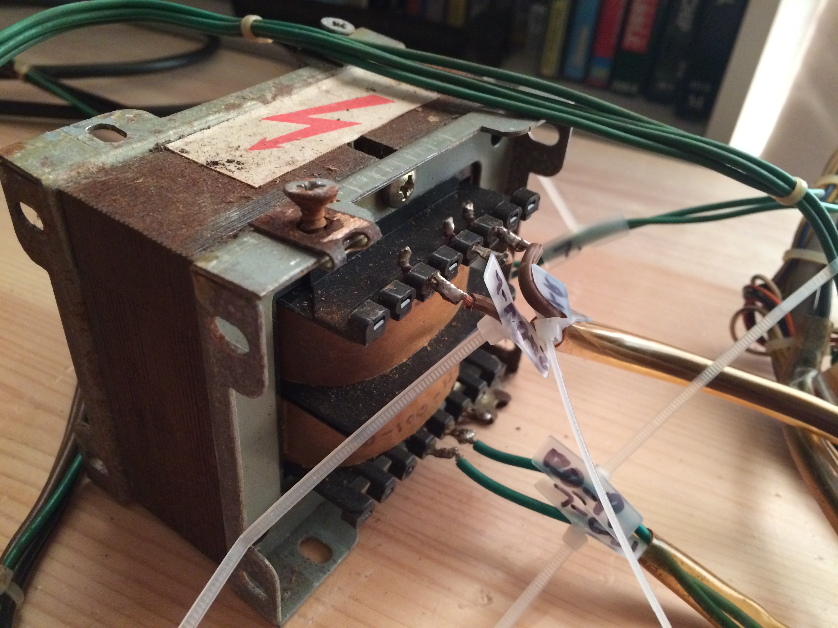

Usually the ISO transformer will still have 120v and 0v labeled so I normally just put the 120v line through whichever wire is connected to the fuse on the chassis.

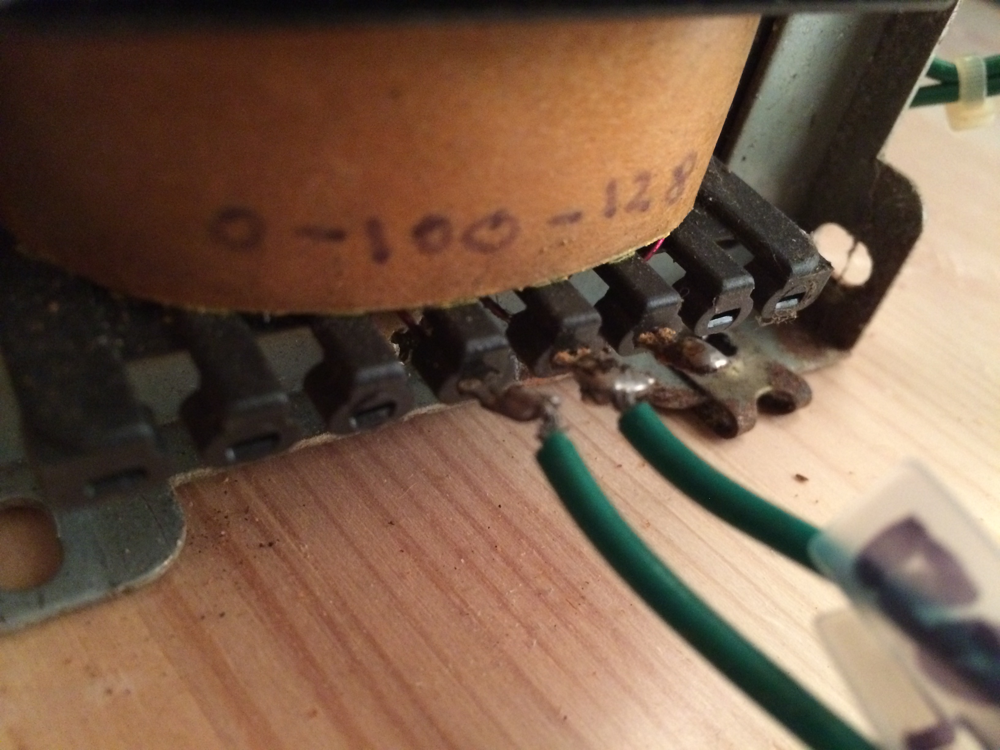

Thank you obcd and tb2000 - very much appreciated.

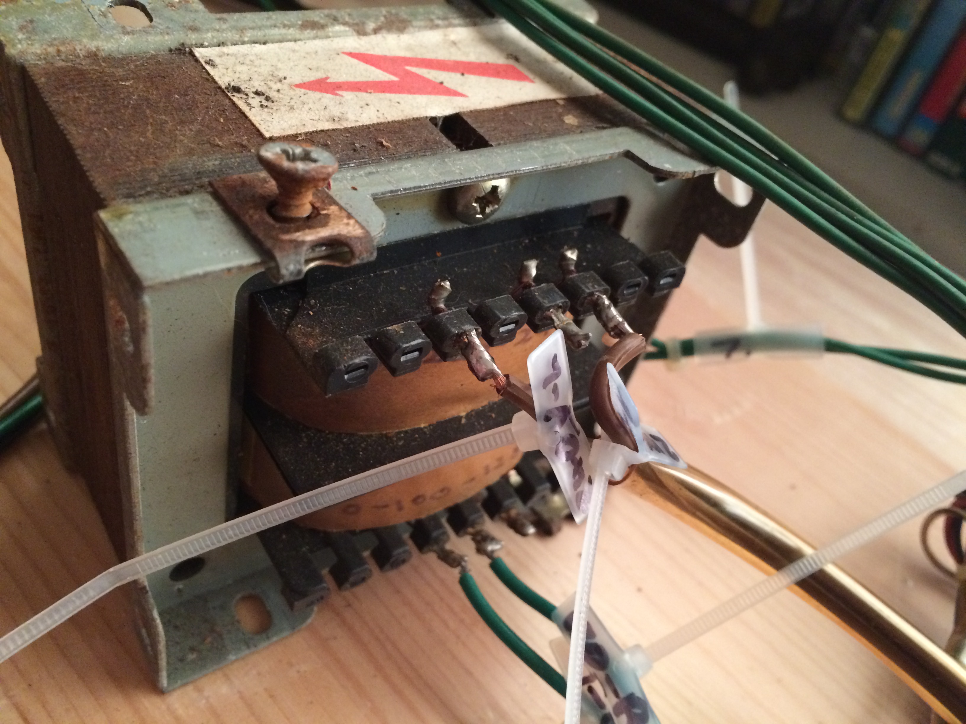

I'm using the transformer that came with the cab and have tested it using my multimeter with nothing connected to verify it's receiving mains and outputting the lower voltage for the monitor.
Here's some pix out of interest (Top row of transformer = 240V mains, bottom row = lower voltage for monitor):
NB: These are pictures of the transformer and original wiring as I originally got it.

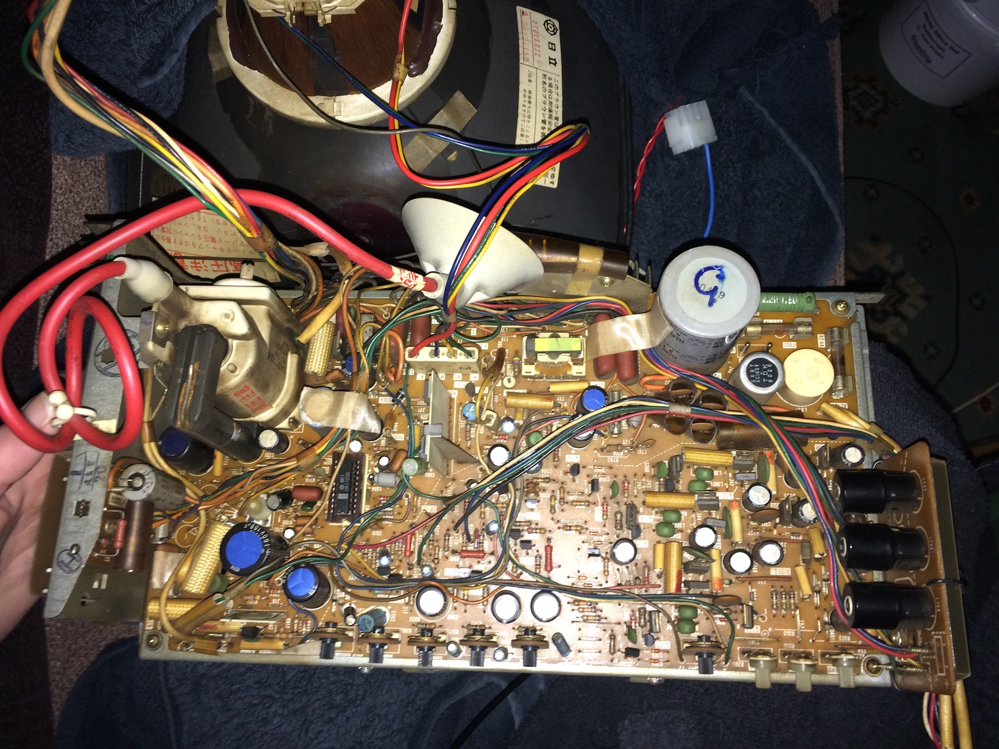

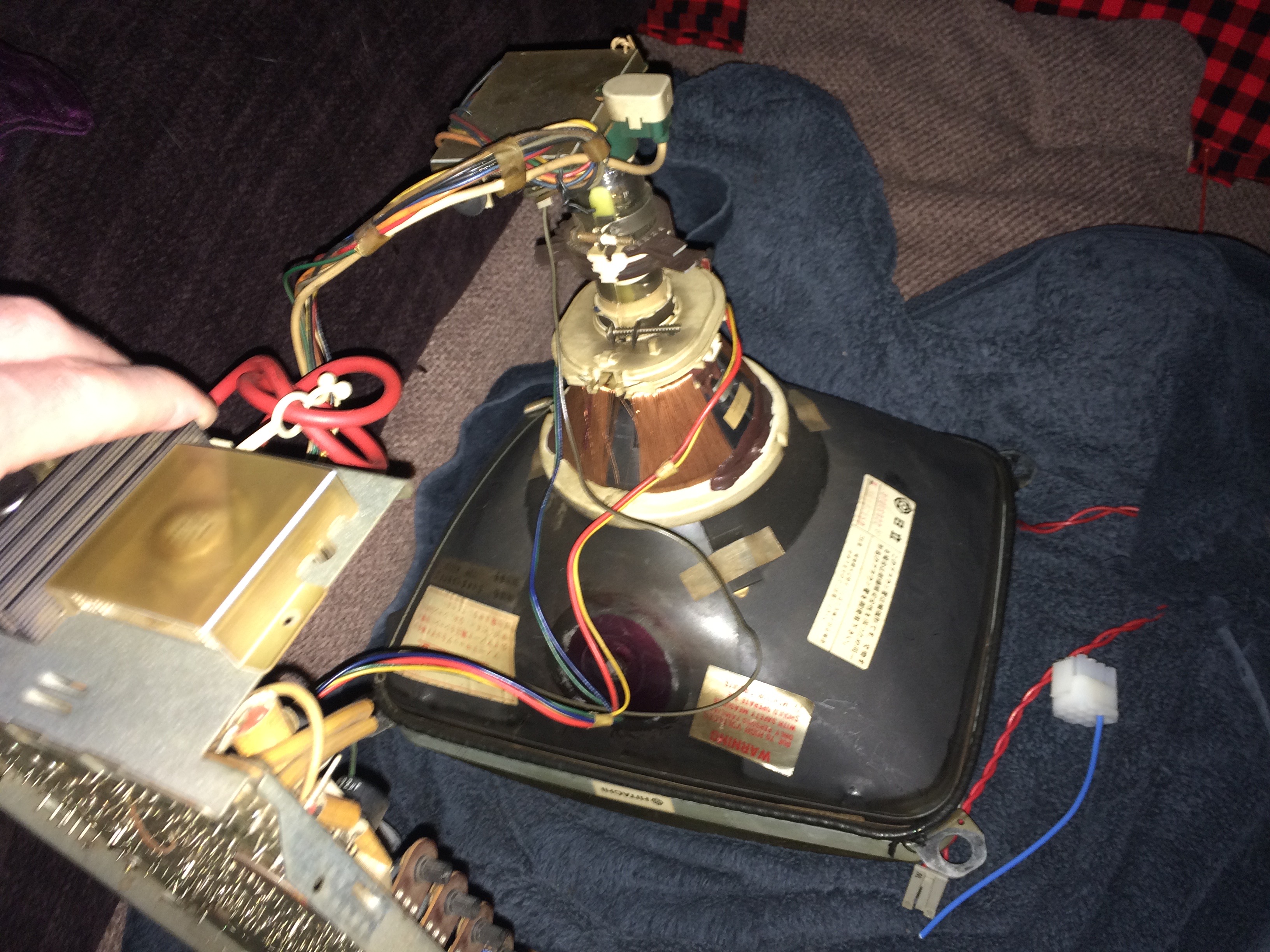

Hello, here's a bit of an update re: my progress testing this monitor out, some random thoughts and possibly a random question or two.
Tube is Hitachi, from what I can work out the chassis is Taito (or Toei) CM-R14 C14C-5090.
I finished wiring up the monitor cables (Red, green, blue, sync, ground) and 120V from loom/isolation-transformer to monitor now and can hear the monitor come on when I switch on the cab without a game pcb connected.
I haven't connected all of the loom to the cab yet, just the monitor and the +5,+12,GND from the psu. (My test pcb, football champ doesn't need -5V)
Next day I tested again but could not hear the monitor coming on at all. While using my multimeter to test 120V from isolation-transformer to the monitor plug (monitor-side), as I pushed in my probe I heard the monitor come on. Aha, right, so I've got a loose connection in my newly made plug (loom-side). On closer inspection, it seems that my new pins for the new 4x3 mate-n-lok plug are shorter that the ones in the original loom plug - which likely explains the intermittent connection.
For now I've removed my new 4x3 molex plug and plugged in the pins from the plug, from my loom (r,g,b,sync,gnd) and transformer (120V) into the monitor plug directly. This makes very solid connections and I've continuity tested from jamma connector and transformer to the monitor side of the monitor plug and all is good. I will try to get new longer pins for the molex at a later point, for now I'm testing with these wires pushed on to the monitor plug - if that makes sense.
Now I can hear the monitor turning on when I switch on the cab everytime - great.
Testing with the trusty Football champ pcb gives no video output. (confirmed working pcb in other cab several times during todays testing).
I tried disconnecting the loom pins and connecting them to my amstrad cpc6128 monitor to see if the problem was my monitor - but got same (no) output on the amstrad monitor. NB: I do not know if this would work anyhow, but read that it might be possible to use an amstrad monitor as a pcb test monitor because it accepts r,g,b,sync,gnd - so this may have been a bum test.
Measured psu output voltages at the pcb and noticed that +5 was +5.5V in this Taito cab. Measured psu back in my other/working cab and it's at +5.0V, so turned down the psu in this Taito cab to match it (5.0V) but still no output on the screen.
NB: psu in taito cab is now making fizzing sounds (quiet-ish) that i've turned +5 down.
I have continuity tested all 3x fuses on the monitor chassis - and verified that the amps on each fuse match what the pcb says it should be - all were fine.
