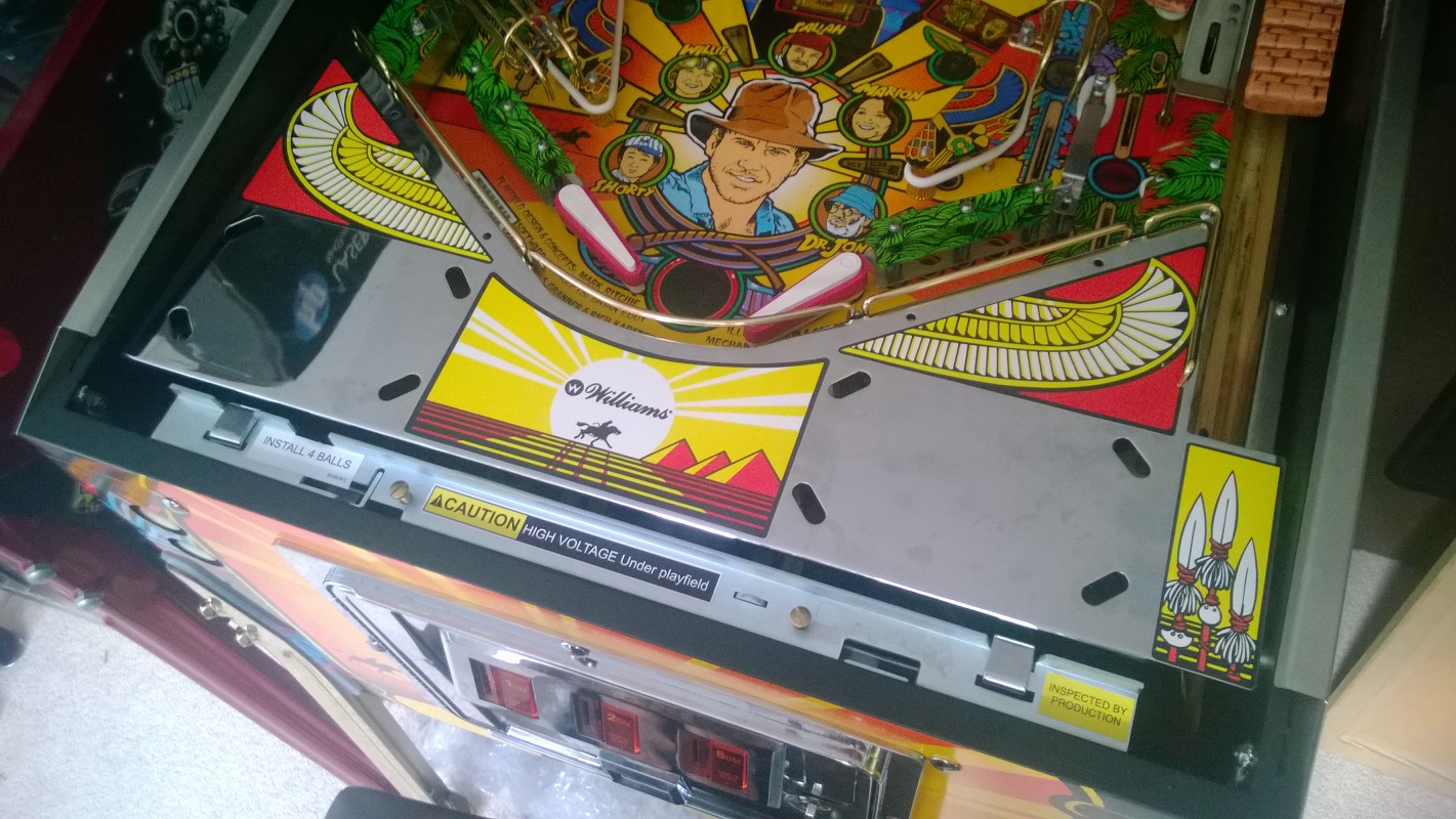

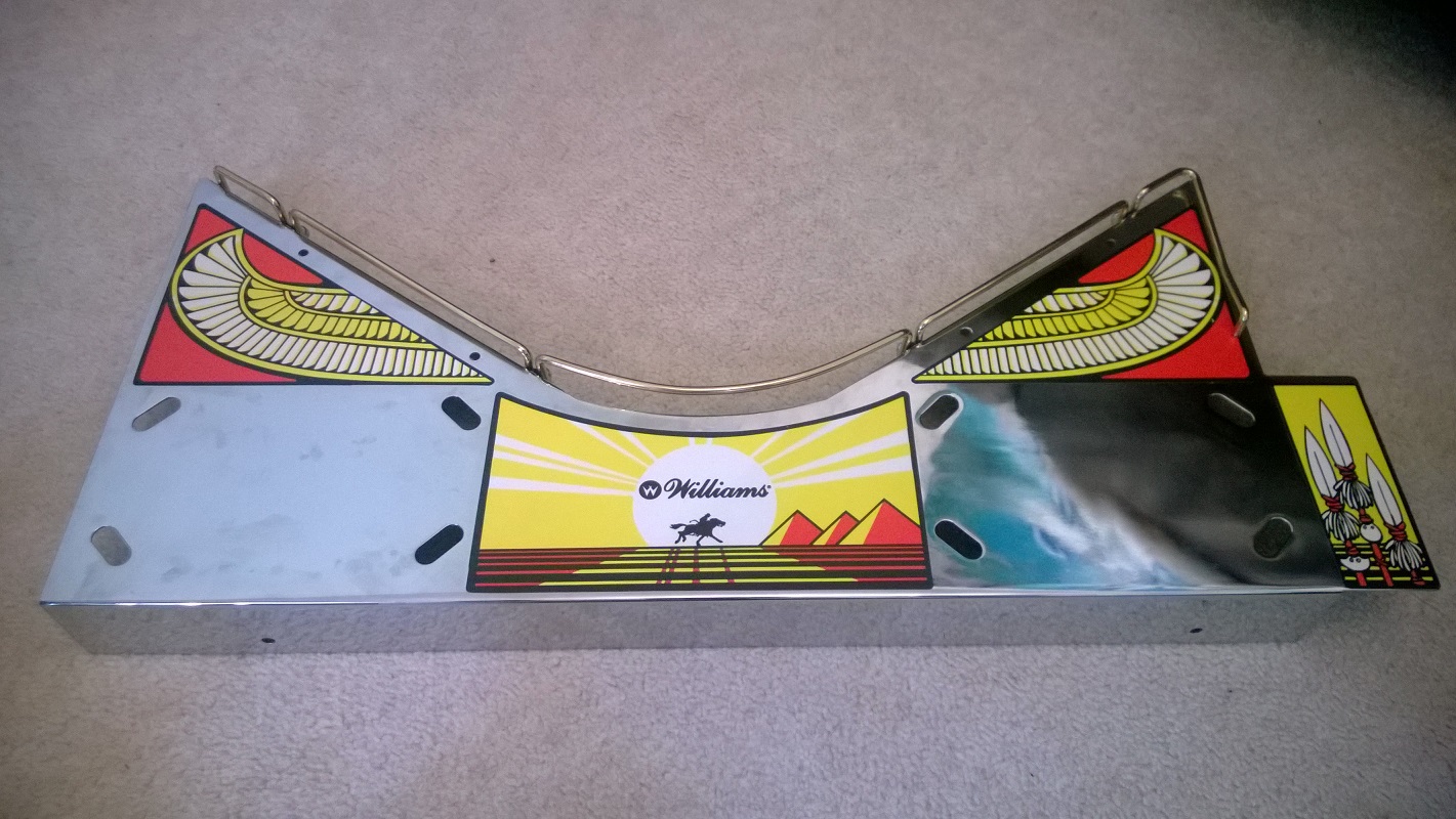

But in the mean time I couldn't resist doing a mock up of the mirror chromed apron with the apron guard...
Notice anything different about it?
Look again
24 carat gold plated baby!
Deathrow
Boom boom POW!
140CR
Thats better than new! I couldn't own a machine like this... I would be afraid to let anyone near it!

Superb!
I feel happy after seeing those chrome bolts.....resto paradise!
This is great and now so close!!!

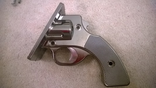

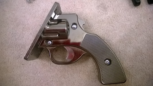

The Gun Rebuild

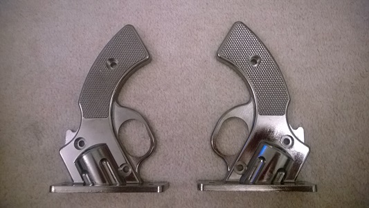

Ok so I bought new NOS gun handles earlier in the year to use on this. As the ones on the machine were badly scuffed and had also gone a god awful colour. I am pretty sure I could clean them up and get them looking new again, but the scuff marks in the metal were a little deep in places to polish out.
First part was to find the gun handles!
Aha! Minty looking

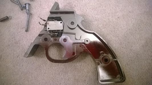

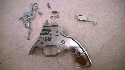

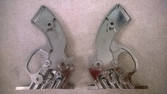

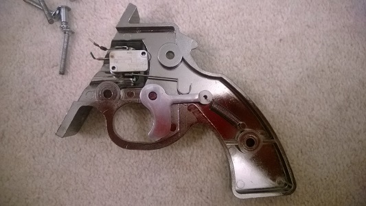

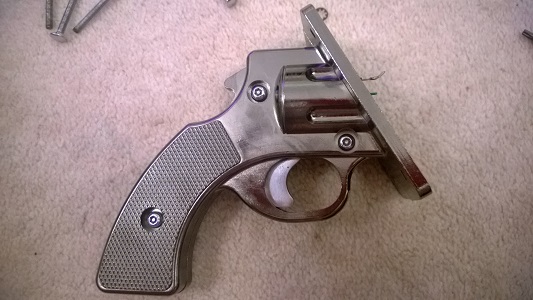

Right time to remember how I took apart the old one
I couldn't actually remember but luckily it was pretty easy to work out. Polished, chromed and new springs at the ready
Installing the microswitch and the trigger, you can see how pulling the trigger activates the switch
Adding the pull back spring. This puts the trigger back into the right place at rest
Other casing added and lined up, ensuring the trigger and micro switch don't move off their pivots!!
Chromed bolts going in
The other side
All bolts tightened, trigger tested for continuity and gun rebuild done! BOOM.
Some higher res pix coming over the weekend. Comparing the old with the new

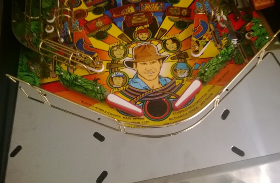

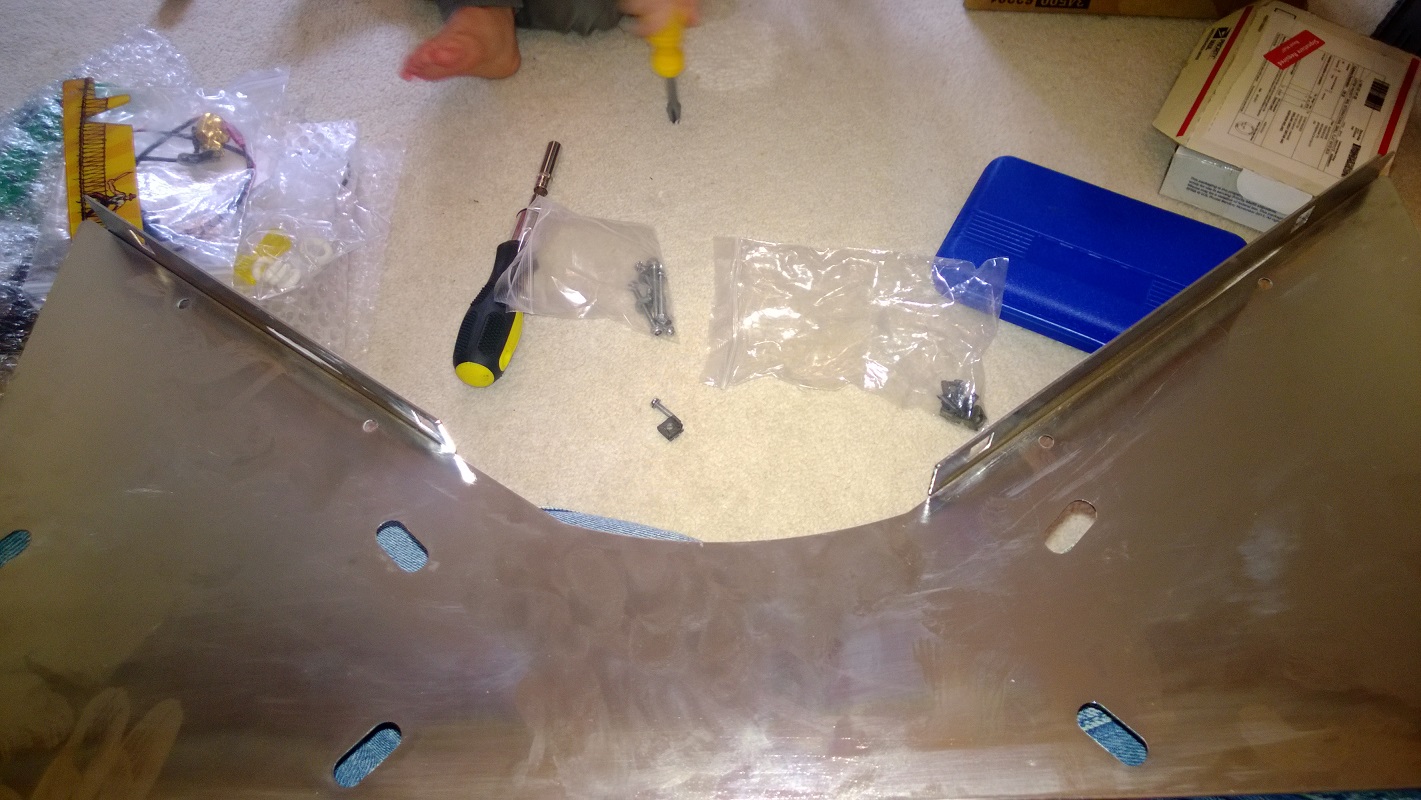

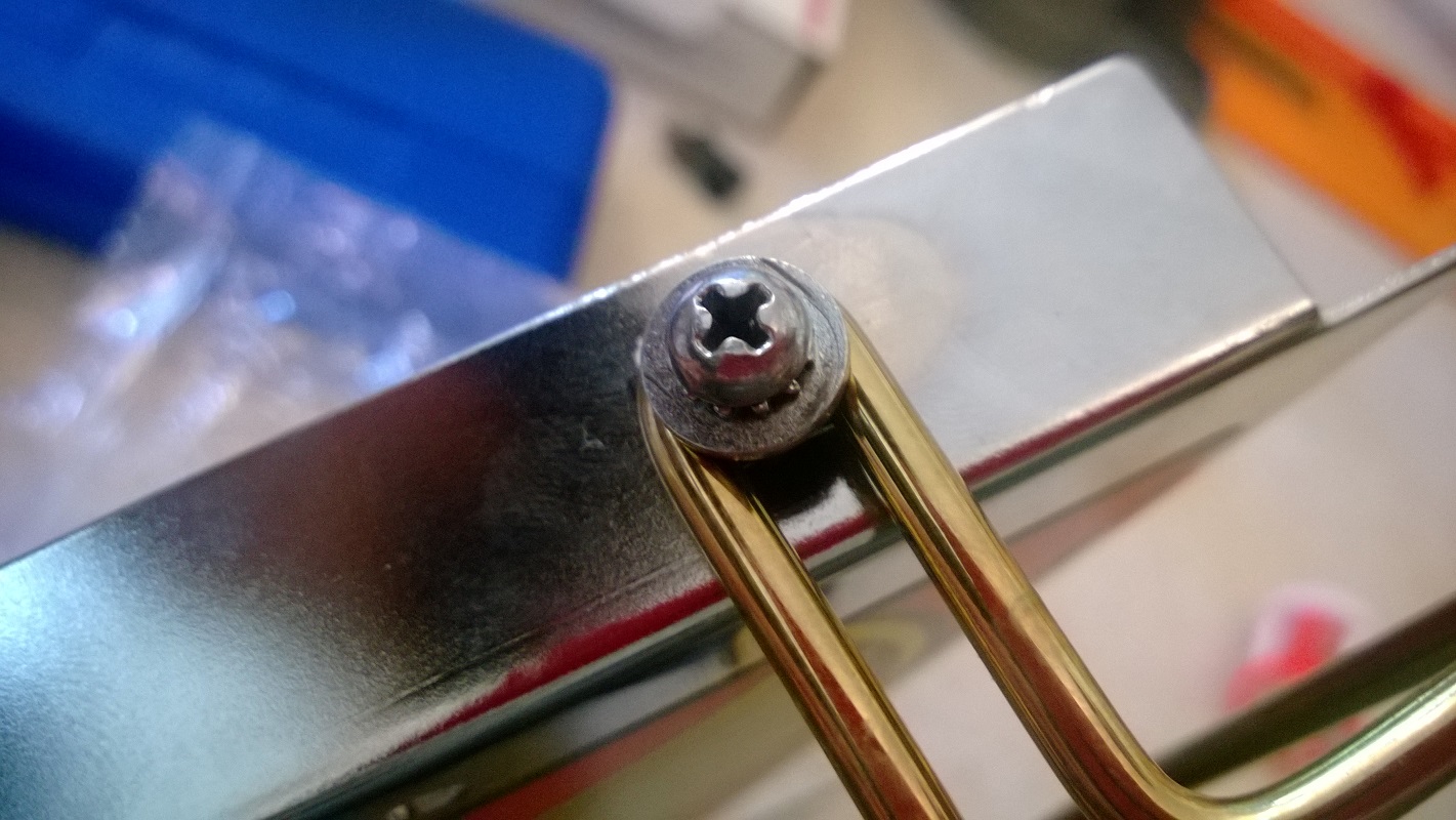

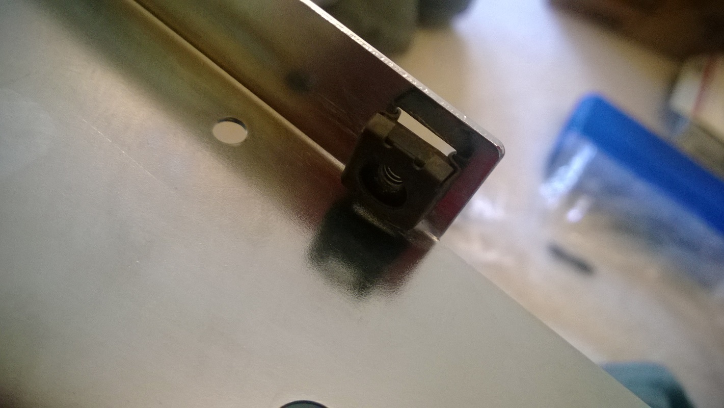

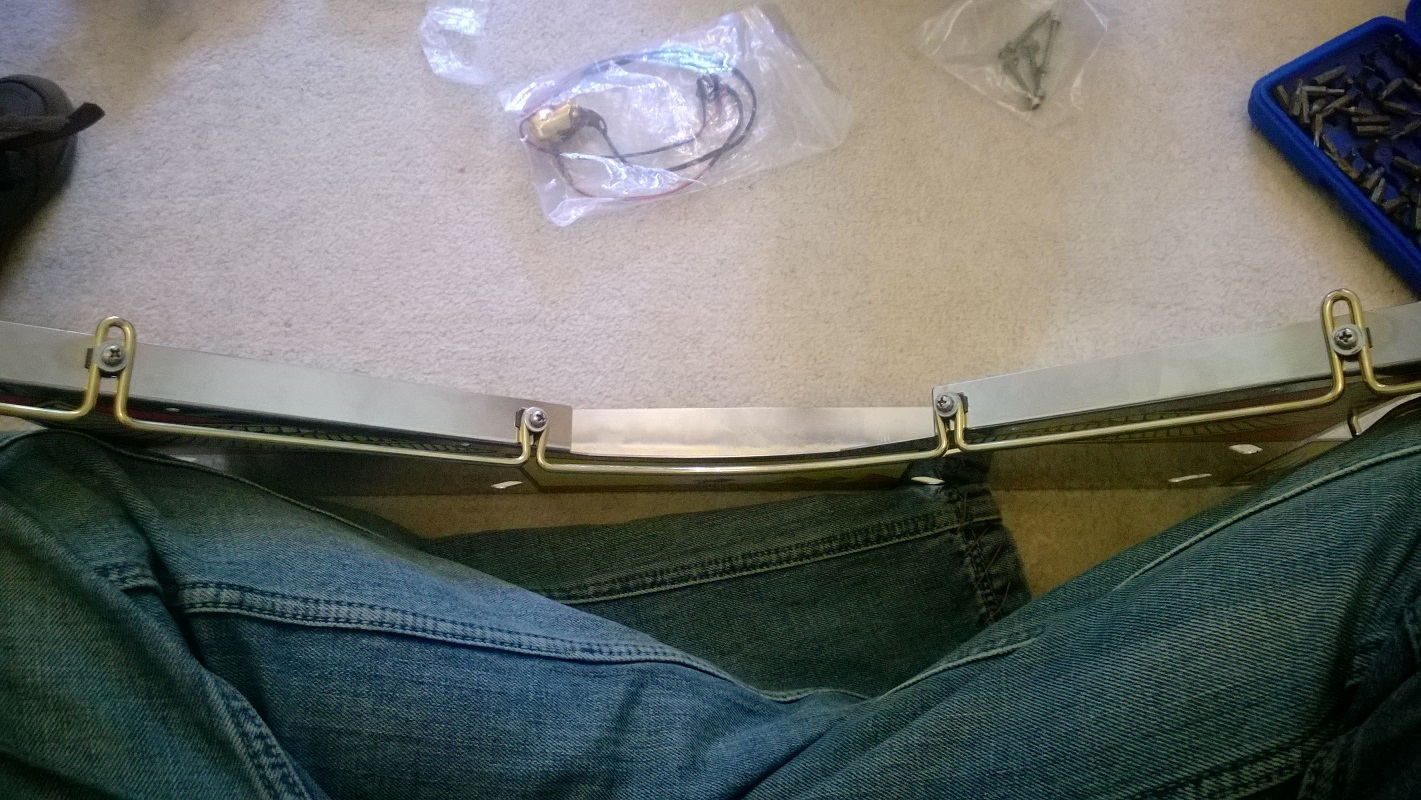

Ok a few extra things done. The apron is totally finished now and installed. I also got the rails mirror polish chromed to make it really pop.
Bolt fasteners installed
Apron skirt installed
All done

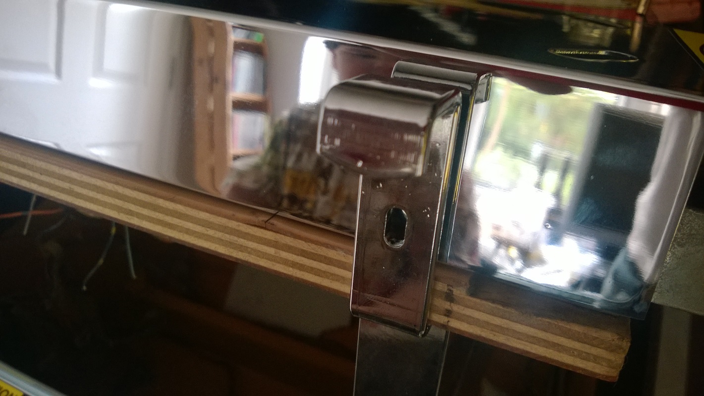

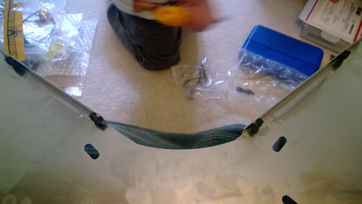

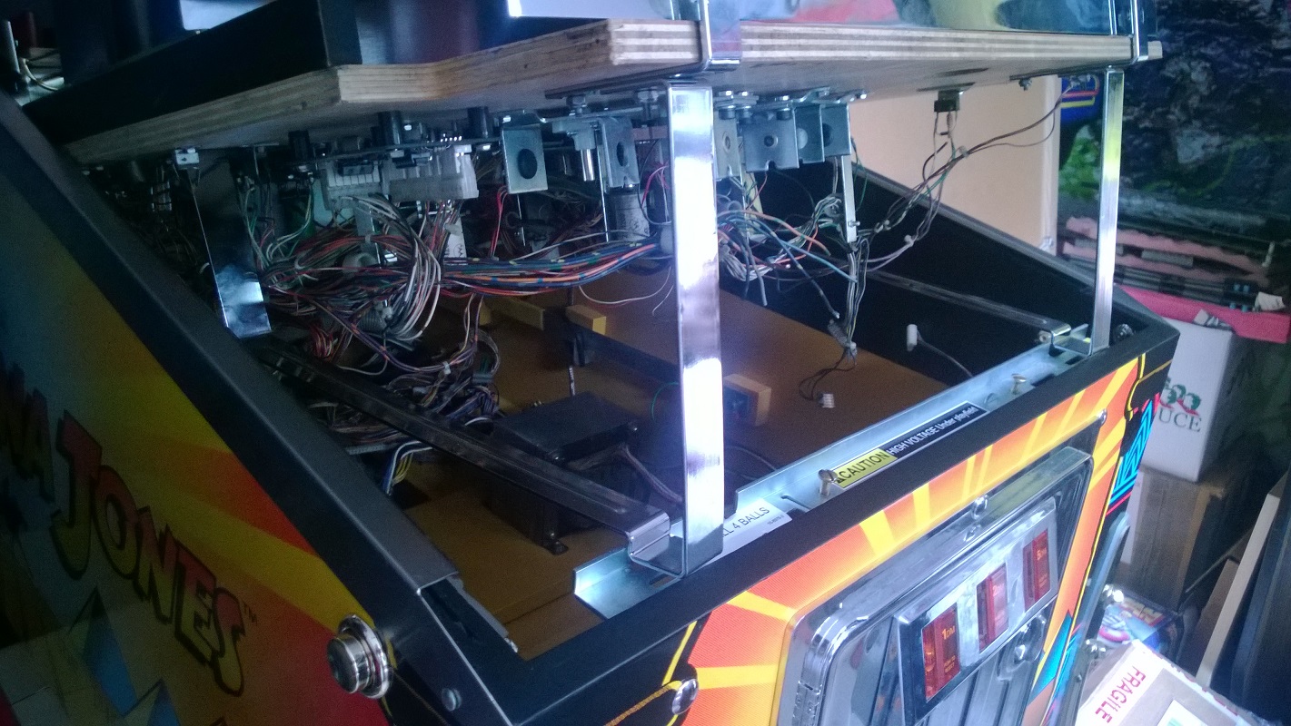

when fitting the apron I also took the time to fit the L shaped playfield supports and the hand rails.
Pix or it didn't happen
A good shot of the hand rail supports

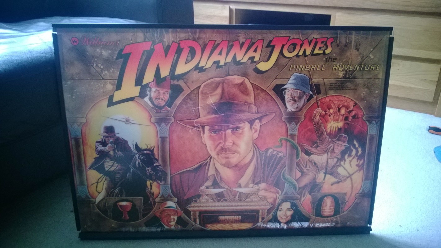

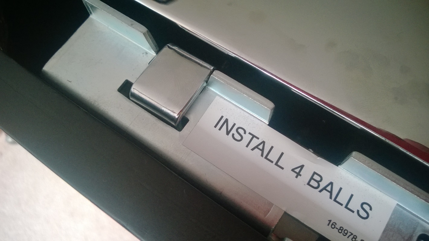

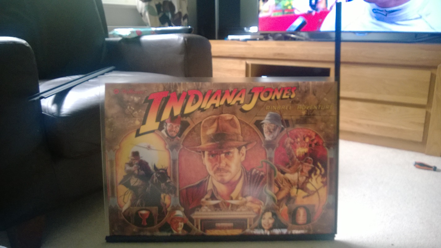

I had the translite and the anti glare backglass for a while in the machine. But I hadn't fitted any trim. I bought brand new trim for this and installed it last weekend.
Lower trim installed
The others I had to use a stanley knife and a clean edge and cut to size.
All done!

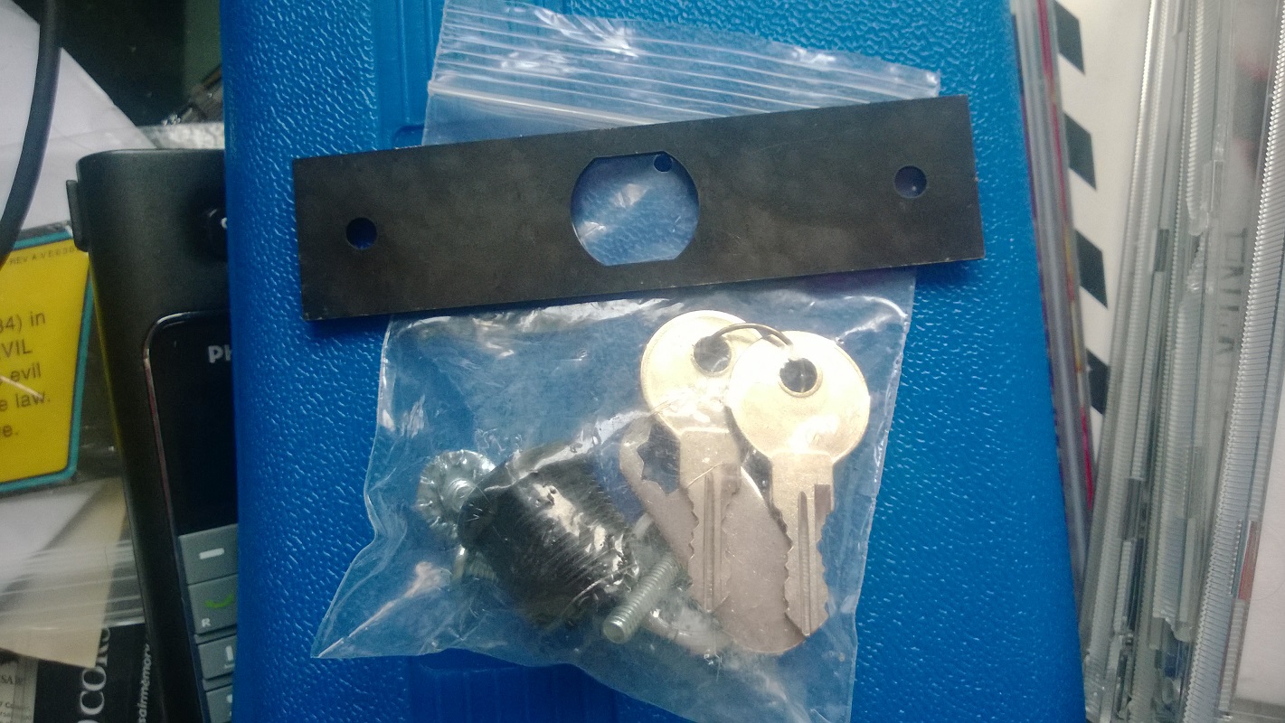

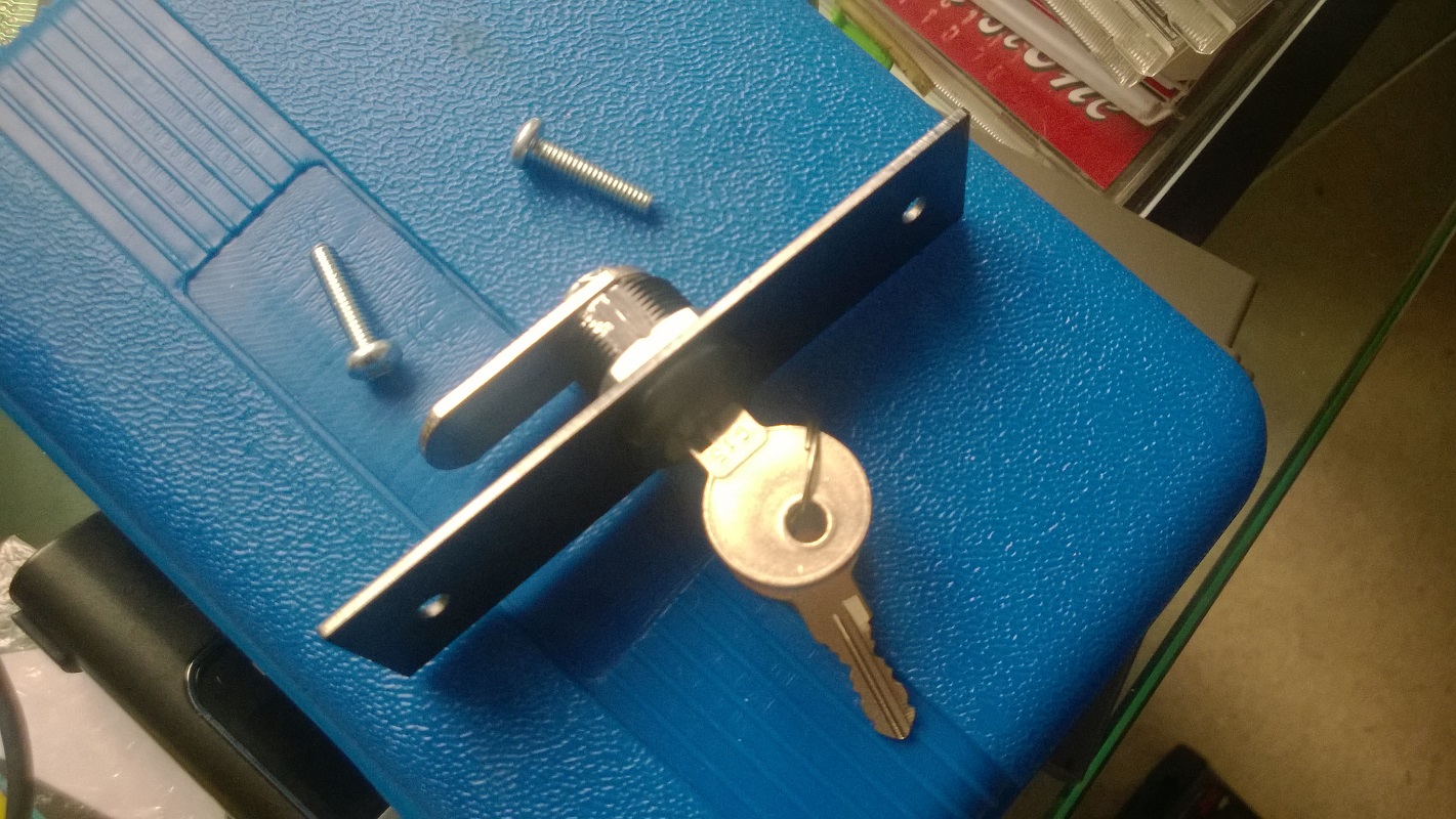

Finally I decided to get a new backbox key lock also. so I bought a NOS one and installed it.
Hole I needed to fill:
NOS kit
Assembled and ready to install
Time to put it in the backbox.

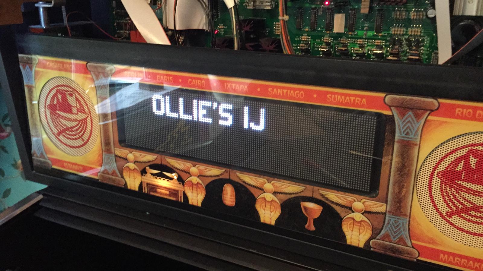

Very late update...
I have folded the game up, (along with a colour pin2dmd!) and had the game picked up by New Forest Pinball. They are going to perform the PCB repairs on the PCBs i've picked up for this and install them and do any needed tweaks to the game. Since it has been sat so long a rerubber and upgrade to Titans/Superbands is happening too.
Hopefully pictures of a fully functioning machine by end of the month!
5,598CR
There is an update in that there is no further update. Last pic is of it booting but the playfield wiring has some issues and ground shorts. It's being worked out and taking ages.
