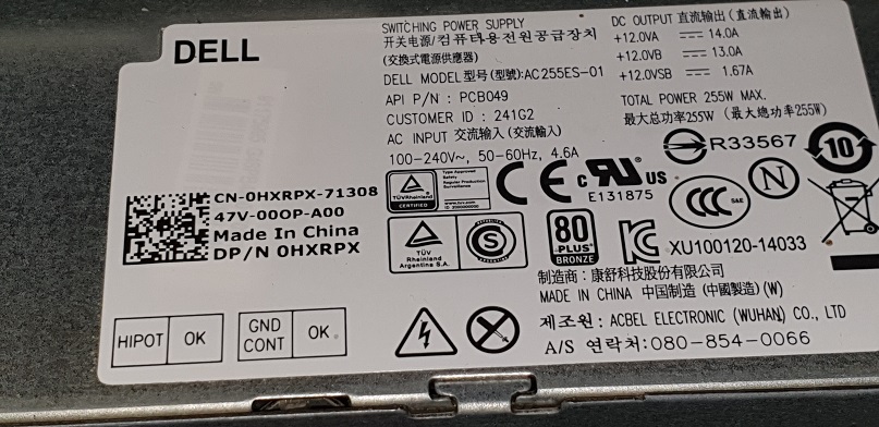

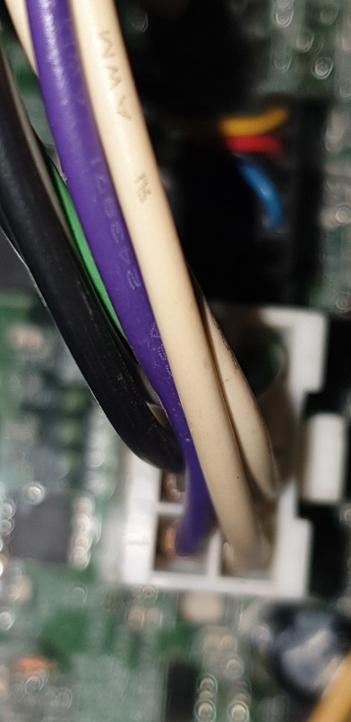

Macro that is too clever for me, no idea what you mean !
Assume ATX its massive and has a single green , some black , purple and white wires going out the power supply to mobo
I wont ground it yet until I am sure if I am keeping this coinops or putting it to Windows 7 and using Chunkin build with it instead. Or even combining both !
But in theory...
Would I be cutting the Green and splicing it in to one of the black wires. Or just finding a ground another way.
Thanks
big10p
Coins detected in pocket!
5,648CR
That's not an ATX. Some weird SFF Dell thing. This is the ATX pinout. Shorting green to ground basically fires up the PC as soon as the PSU gets mains, without having to press the power button. Possibly the green wire on yours does the same thing, but you'd need to check.
