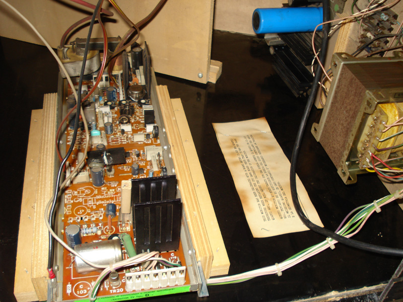

Here are some pics from the innards. The PCB is single board, has a lot of fixes and odd cludges in evidence. There's what looks like a voltage regulator PCB, and the B+W chassis is probably the simplest I've seen!
Stu
gridrunner2011-11-25 22:30:48
guddler
4,055CR
PCB doesn't look like a Zacc Invaders to me. Too many ROMs and in the wrong places, plus the board looks too big. Doesn't desperately look anymore of a bootleg than the originals do (well, maybe), it just doesn't look like the invaders. To be honest, looks more like a Subelectro UFO board to me if I had to guess at one but it's been a long time since I've seen mine
My UFO board was originally in a B/W cab despite being a colour game so that isn't a reason to think it might not be.
Rest of the innards look original.
