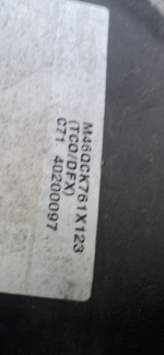

i dont know much about CRT tubes, but we all know a man who does.. i'll send him a PM and see if he knows anything about the M46***** line, as there is not much i can find on tubular about them.

I have the chassi With you can have for nothing .. as I haven’t tested it .
Chassis had power cables input cut and
That doesn’t mean it won’t work it’s just lazy techs that disassemble old cabs ..
This could have been on a demo cab
As it’s from wells Gardner / sega
When wells Gardner still was operationaL. I got it personally from them When they was closing .
Still has plastic wrap onscreen .
For hang on though I think you need a 15khz so you most likely better of
Getting a hanterex polo 2
And a Philips tube from a 19” tv.
Will get a closer look at chassis tomo for you with pics
I think I have a spare hanterex also

That's a 22.5mm minineck crt if I remember correctly. Very common crt used with the K7000. Really shouldn't be that hard to find a replacement. I'd look for a 20" tv (make sure it's got a proper curved crt and not an FST as that will be a 21" probably). I always found most of the 'cheaper' makes had the correct crts in them, so stuff like Beko, Goodmans, etc. Should just be a drop in replacement with just having to adapt the yoke plug to the K7000 type. It'll probably have a more efficient neck heater so you can probably up the resistance of the heater resistor on the chassis and still get a good picture with the bonus of it not putting quite so much power through the heater (which should lengthen its life somewhat).
