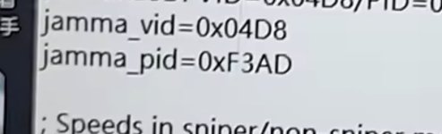

Once you figure out everything you can have different .inis for your digital and analog setups, horizontal and vertical and different controllers.
The table back on page 3 I think shows what settings you need to have for no lag on various setups. You need to have a look at that then adjust your .ini as needed.
This are your VIDS and PIDS
These will probably be different between your JPac and JAMMAmisterthingy.

I suspect if you look in the ini file that came with it it will have all the settings you need.

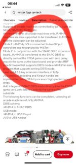

Please that thread again. The issue was not with the update script (update all was not out then) and it says the quirk was already integrated. The OP there had an issue with an off the shelf usb encoder clone, it was unique to that setup.
IMHO you need to try it with another setup and edit your .ini. It also looks like there is a dip or setting for different input modes for you JAMMA encoder. I’d go through those settings.

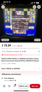

Also one of the screenshots in AliExpress shows this setting.
Not sure if it is just neogeo but check for this to ensure DB9:
