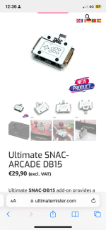

You definitely don’t need that. That is for adding snac arcade sticks.
Just thinking out loud, if this is a SNAC only device, it will NOT control menus and will only have 1 player. These are your symptoms right?

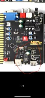

I only have 1 player yes
It does control the menu though .
I have a button next to the jvs port I don’t know if that changes the controller modes ?
The very fact that it says joysticks is
Showing me that it is possible to add payer 2 ..
Both the toggle and the small red push switch I don’t know what they do ?
Its not a SNAC device, its an xinput USB interface.
The switch next to the JVS connector is designed to do something like map player1 controls to player 2.

Maybe this is what’s going on then
The switch is forcing mappings from p1 to p2 …
I will try flipping it back later

See 1p 2p switch ..
I get what your saying as the mister mimics the pcb so all controlls mapped directly in core
On all the pictures Ive seen and on both my boards that P1/P2 switch is to the right, so pushed to the USB3 connector side and not the JVS side.
