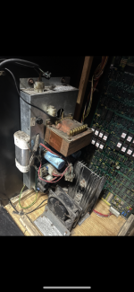

Hi guys
Would anyone be able to rebuild this power supply or any recommendations on anyone that could please
I took it out and cleaned it .after game stopped working
Changed the 5v fuse which came apart in my hands .cleaned around the fuse holder which was black
and it worked for a few seconds
It’s out of my 720 euro cab
Thanks in advance

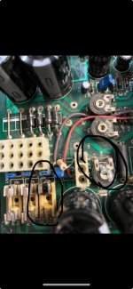

So I’ve taken this out again and gave it a better clean
It has blown 5v fuse
Is there any way of cleaning that fuse holder for the 5v
I’ve noticed this crud on this part shown ,is that glue from factory just
Or could that possibly be my problem with 5v blowing ?
Or is the /could the fuse holder be the problem ?

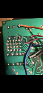

I’m going to have to change this fuse holder for sure
Soldering onto a board .oh no

You could use a swticher for +5v and use the PSU for the two AC outputs (if those still work) would require some hackery though. Shame it didn't use the same setup as the US version as it looks like that uses a standard switcher and a transformer for the rest. You do like the oddball stuff though. ;)
Do schematics even exist for that power supply? I cannot see a model number or any markings.

The boardset is Atari ,
you know me to well with this oddball stuff 😂
The only good thing yo my advantage though ,maybe is ..
The pcbs are Atari,so maybe that makes things better for schematics
It was all working and playing
There was a small smell of burning when it turned itself off
I’ve almost convinced myself it was the dust on the power supply burning .no smoke
It also made a sound of the coin counter clocking up
The 5 v fuse holder is broken for sure
My belief is that everything else is working
Though what could have caused the 5v fuse to blow .maybe years of use and it was maybe slightly burnt up ?

It looks like there was poor contact on the fuse which caused high resistance that then creates heat, then that creates more resistance and so on until eventually it just burns / blows the fuse. Same thing often happens in pinball machines.
I could recap it and replace the fuse holders for you but the issue comes with testing it, I don't have a load tester or the pinouts for it.

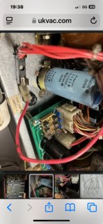

Any idea what that is between the power supply and transformer that looks like some sort of bomb? If it's a filter cap for the +5v that could have shorted.
@Ace` I managed to miss this post Not sure how and had a go at the soldering
