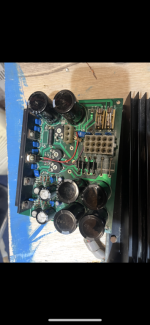

Below I took readings
First is with all connectors off pcbs
Machine turned off and big plug attached
next reading pic -with one (bottom)power connector removed from pcb
Last pic is reading with all connectors off pcbs
Is there any clues there ?

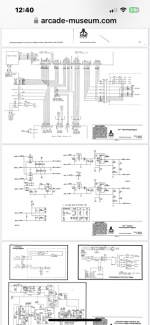

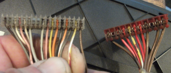

The images posted above of the schematics appear unreadable on my pc however I made a very nasty test loom for Paperboy/720 from a scrap paperboy loom ages ago and most of it runs on +5v but you do need +15v to drive the video amp (I think) and/or hit the reset circuit over the head or you just get a black screen. I think it might also be used to tell the nvram to write the high score tabe before the 5v collapses on power down.
On the very faded masking tape wrapped around the loom it looks like the extra voltage needs to go to a pin on J15 on the cpu pcb and that looks to be a yellow/white wire one pin away from the edge on the end furthest from the 'key' pin and it is also conected to the power connector on the video pcb as shown in the pic above.

Yeah those schematics are unreadable ,I didn’t even realise I’d posted them as I was the middle of writing a post

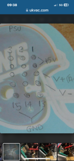

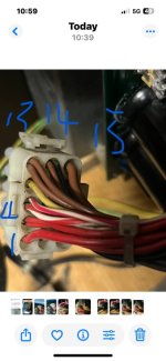

Before I do anything
1 and 4 are the 5v looks like there’s another red wire beside number 4 in 5 .could it also be 5 v
The grounds are 13 and 15 is 14 with the brown and black wire included in the grounds ?
Better being safe than sorry

See at the back of the switcher there is another psu where brown and red cables cut and wired to switcher instead
not sure whats going on with the AR2 is it? bottom of rear door, connector blocks joining wires
Without looking at manual I don't know how much that original PSU did, was it just 5V?
