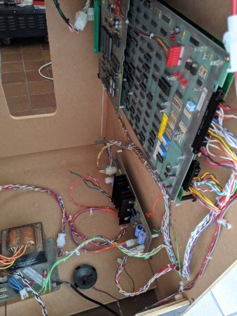

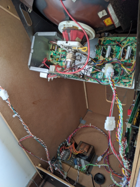

A long overdue update, but I've made quite a bit of progress! I finally got a power brick (eBay), and have a service panel and coin doors on the way (from Equites). I also got some speakers of the same spec as the originals from eBay - apparently they are used in new Minis!
So after a couple of false starts with fuses, big blues, and putting the monitor too high up, I've got it up and running. Huge thanks to Equites & Monstermug for all their help!

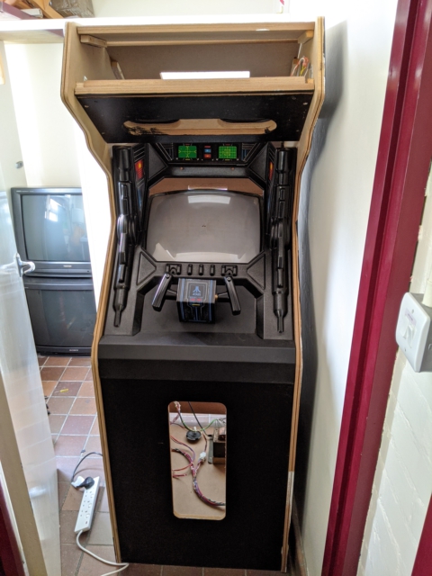

Little update - I got the cardboard bezel and smoked acrylic for the monitor glass, as well as some coin doors (blank for now), and a service panel.
Found a little bit of t-molding left over from my champ sprint cab but need loads more!
I'd like to use an LED tube light for the marquee - does anyone know much about these? I found this and thought it might be suitable:
https://www.ledkia.com/uk/buy-t8-led-tubes/5799-kit-600mm-2ft-9w-t8-nano-pc-led-tubes-100lmw-lamp-holder.html?id_c=13128
Think it might not quite fit though.

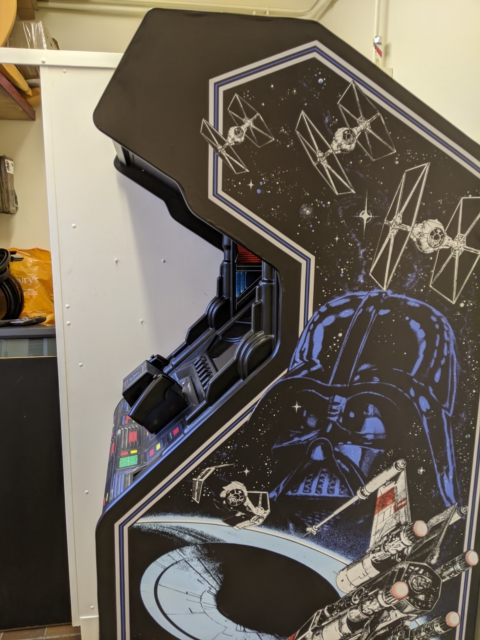

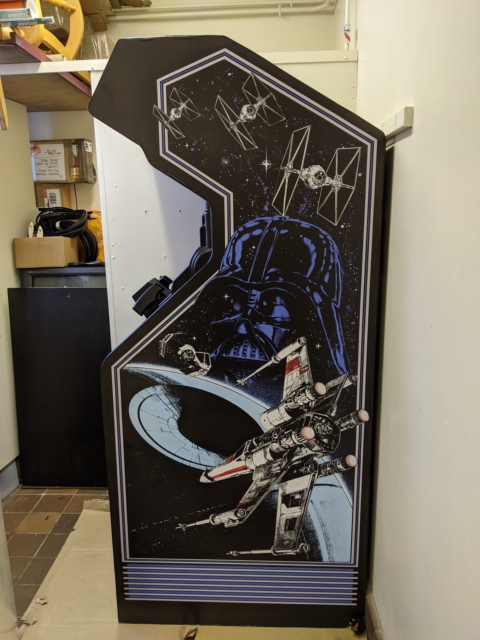

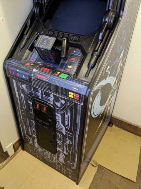

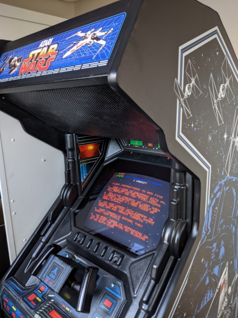

I've finally had time to put all the artwork on, which is excellent quality - thanks Muddy! And it's so much easier if you spray the surface with water first.
I also found an original coin doors and mech on eBay, and Monstermug kindly provided me with t-molding. I never could find an original speaker grille, so got some mesh from Amazon that's pretty close to the original:
https://www.amazon.co.uk/gp/product/B00QAGKBH0/ref=ppx_yo_dt_b_search_asin_title?ie=UTF8&psc=1
The LED tube that I mentioned above works fine on 110v so no changes needed to the wiring harness. I'm having to keep it in a pretty small space at the moment as I move other stuff around, so I can't get great pictures, but here's what it's like now:
Lots of little things still need doing - many of the the insides of the holes in the speaker grille need painting, which is why the black doesn't look uniform. I'd also like to generally strengthen the cab up. I'm missing part of the marquee housing, so have had to attach it slightly differently for now. The coin doors need repainting. But it plays a great game of SW, and the artwork looks amazing. The vector graphics looks terrific, and the sound is so good. Might also get the ESB multi game kit if anyone has one going spare?
Thanks so much to everyone who's helped - Equites & Monstermug have given me loads of advice and support, and been very patient with my lack of technical knowledge!
