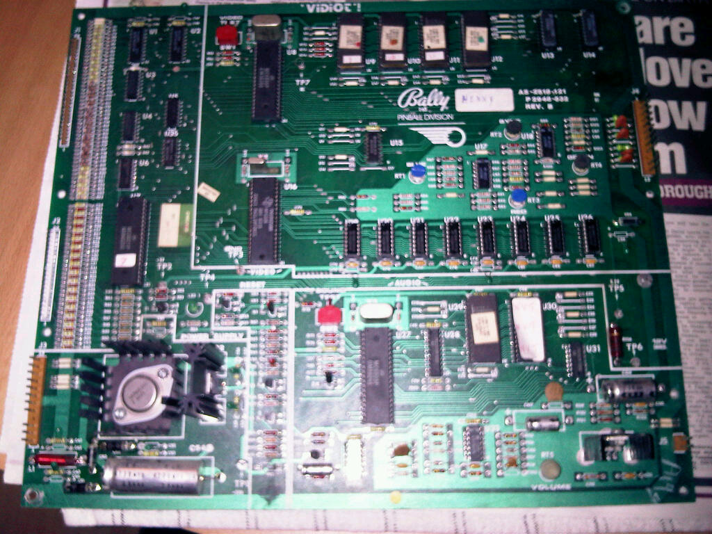

The PCB's:
Battery is missing on the MPU?? Looks
like there is some corrosion on the PCB and behind it. Not sure if this
is from a previous leak or not, but this needs looking at fairly
urgently. I have a spare but this has quite bad corrosion, and not sure
how fixable it is

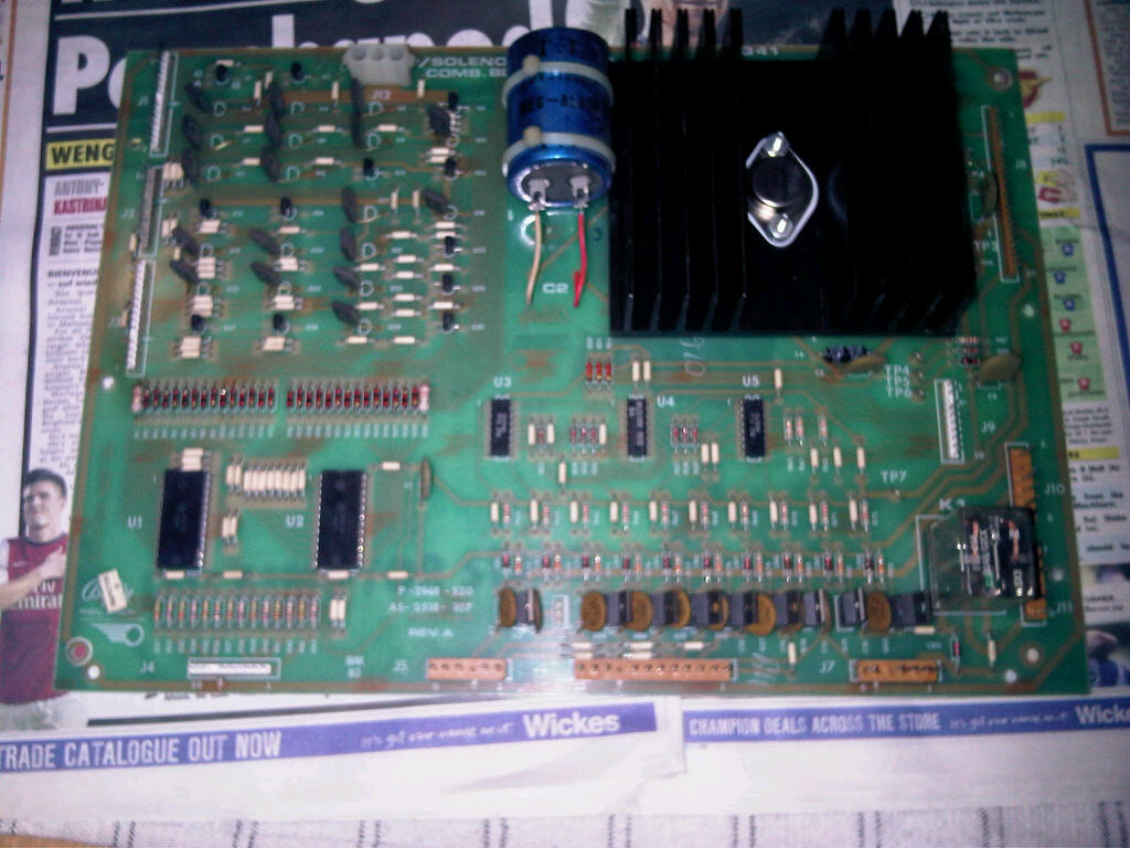

Solenoid PCB looks ok. I have a spare:
Vidiot PCB looks ok. I have a spare:

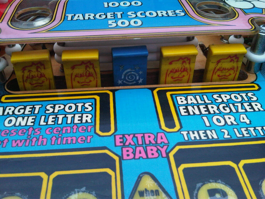

Clearly some of the targets will need replacing as they looked a bit worn and dull:

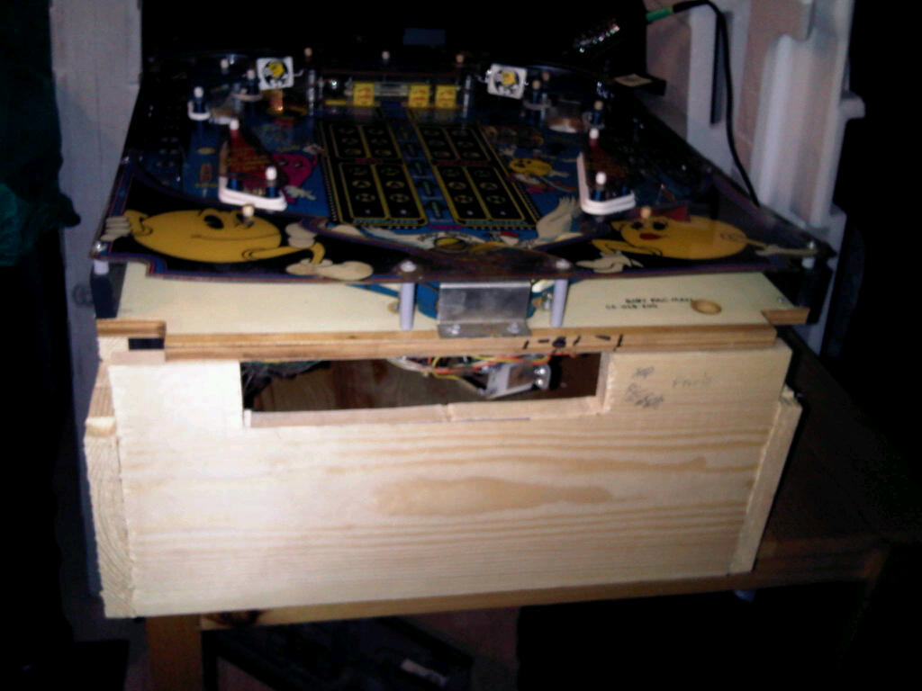

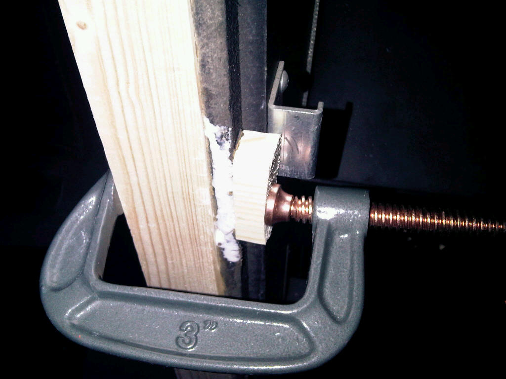

Not given an update on this for a while, so here is a list of things I've been working on:
1) Stripped all the parts out, in order to start working on repairing the cabinet:
2) Started to get the cabinet back into shape as it was swollen and damaged at the back. See pics above to see the original state it was in
3) Built a box for the playfield to sit on so that no coils or wires etc get broken underneath, whilst I was working on it:

5) Cleaned the PCB's

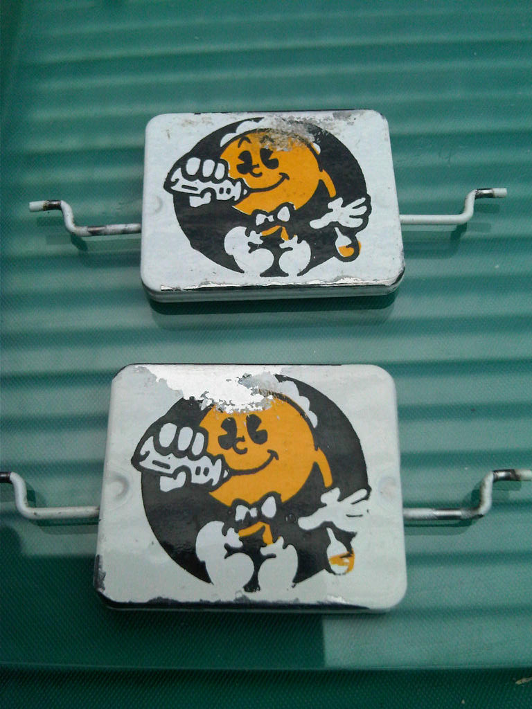

Just need to work on the spinners and replace the drop targets and the playfield is in good shape:

What did you use to clean the PCB's with Purity? Always interesting to hear peoples different methods.
