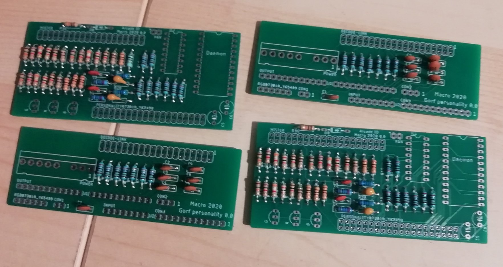

s
The two boards in their current state of assembly!
