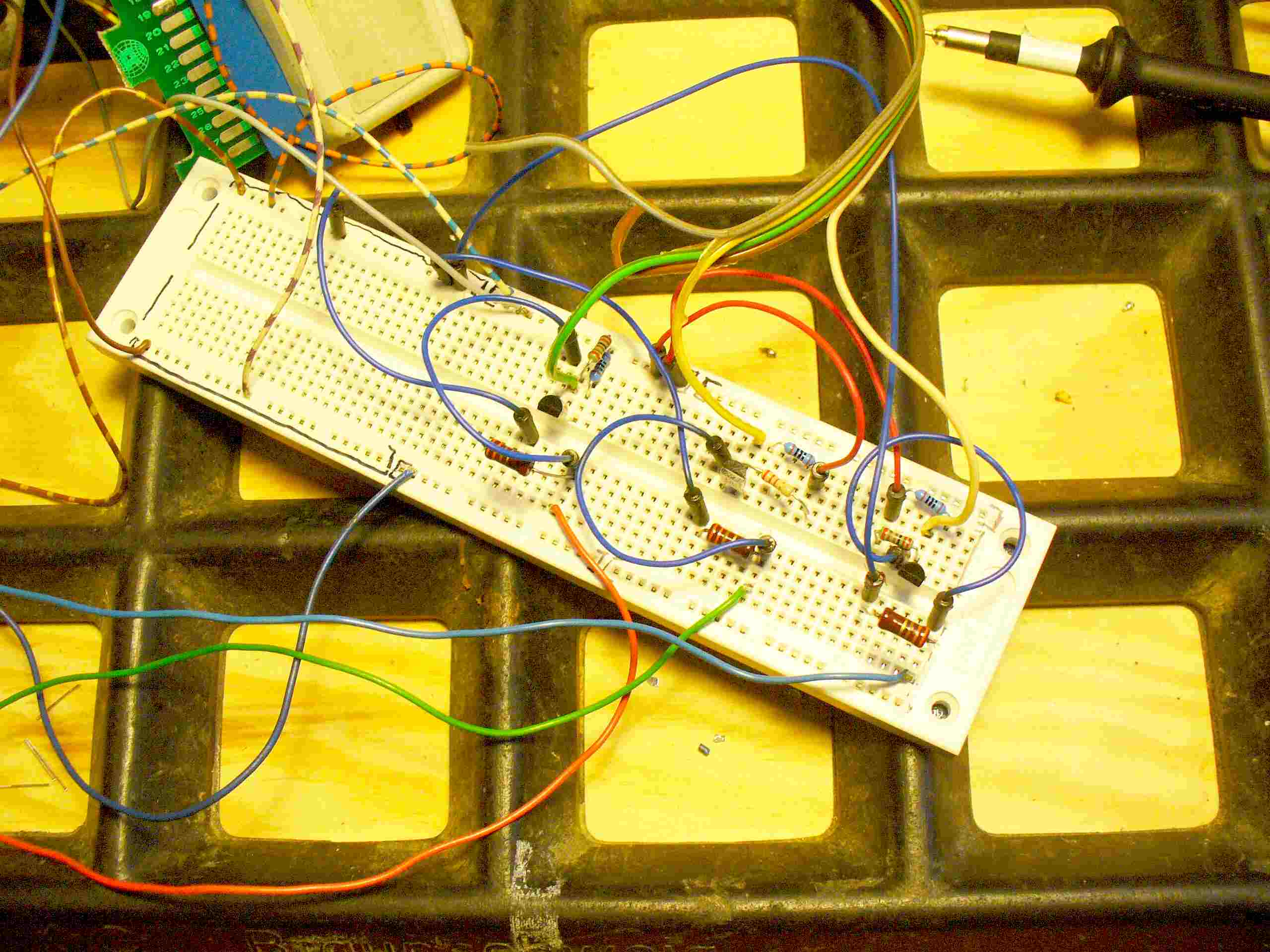

DonkeyKongler
108CR
Macro said:
the schematics also show the generation of the necessary Y,YR and YB lines, so the board has the full colour signals available, even if it doesn't include them on the pinout!
you are right,
if you do this..........
you get a coloured spaze zap........
