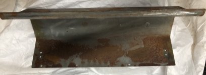

I wanted to start work on the Goliath Arkanoid panel today.
Unusual layout and seems specifically dedicated for Arkanoid.
The rust could be felt through the cpo so unfortunately it has to be replaced.
Rust has started to work through the metal, will need to be treated and then will use a Zinc galvanizing spray.
4C486FAE-CCFB-4B3E-9CDD-7014EB44B832.jpeg015B1DA5-385B-4209-BA1A-384111C4CDC6.jpeg1150622D-F751-4142-8B27-0E065B541274.jpeg
This is a Lordsvale panel which I zinc sprayed recently so should take the Goliath panel back to new looking hopefully.

@Flyback2021 kern to hear how you tackle the rust issues like this one… I have a metal faced cab with pervasive rust throughout.
Hi
Had to deal with considerably worse rust than this in the past unfortunately.
This link might help and refers to panels earlier in the thread
Rust/ red oxide
As regards this panel the next steps
1) evaporust soak 12 hrs
2) full sand in case any residue left from cpo
3) zinc galvanizing spray on internal
4) tac weld the threads for the spinner / ironmongery holders/ retainers added.
5) 2 coats of red oxide primer on control panel ( external)
6) 2 thin coats of Hammerite (external)
7) 320 grit sand so completely flat and perfect finish
8)new cpo fitted
Fair amount of work - doing a couple of panels so time can be saved plus we’ll set up for this type of work. Alternatively you can go the shot blasting/powder coating route.
