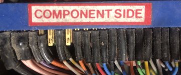

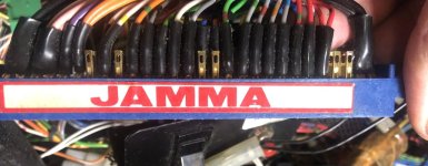

So I had modified my Megadrive joypads, the 9 pins in them, for whatever reason, they have
earth, up , down, left and right, and a b. Just right out the box, but annoyingly they don't have a third button.... Which is why I have that weird setup going on with drilling a literal hole in the Megadrive pads and wiring up the third button, a literal wire wrapped around the controller and requiring a separate connection hanging in mid air...
This is how we played arcade games before MAME I guess?! hahaha
Many games though don't even use more than 2 buttons, but for those that do there is at least a third option.
What I did was wire up button A and start together, so they get triggered together, so any game that required start a and b, that was covered. (A literally piece of paper clip under the button which made the press feel a bit chunky...)
The bloody Konami games with their 2p and 4p hardcoded into the ROMS nonsense.
Often me and my mate, we'd be playing games TMNT as Leonardo and MIchaelangelo only because it was too much hassle wiring up just Donatello.
In this box, the red, green and blue buttons for 3P or 4P was
Green - Insert Credit for your coin door
Red - Button C
Blue - Start (for a Megadrive controller that wasn't modified) or Button D (Like Dungeons and Dragons)
SO at least in games like X-Men or Golden Axe Revenge Of Death Adder, Player 3 or 4 (usually me) could just lean over and press the button when needed (which wasn't often)
Anyway sorry my hacky stuff wasn't specifically anything to do with restoration project. I just thought I'd share it with you since you shared stuff with me.
Cheers
