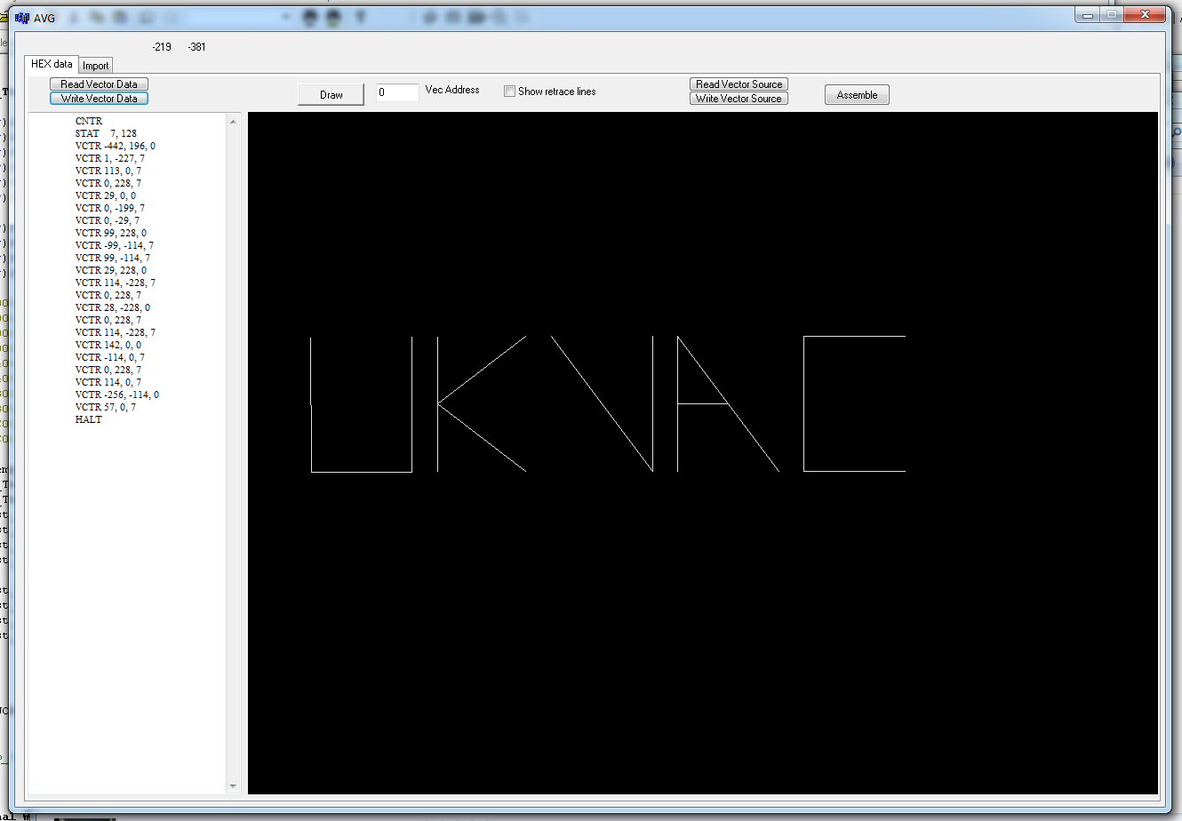

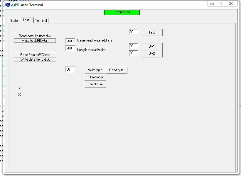

The fruits of todays hacking is a (crude) HPGL plotter file format converter to Atari vector instructions.
First use a freeware vector drawing package called Inkscape to draw some vectors. Choose a custom page size of 10.24 x 7.68 inches. Then save as HPGL format file with 100 pixels per inch.
Next import to the AVG assembler which will generate vector draw instructions. I forced the CNTR (centre), STAT (colour/intensity) and HALT instructions by hardcoding in the app to prove it works. Then assemble the instructions and save the vector data as a binary file.
Next I hooked up my CPU tester to the CPU socket of a Battlezone PCB on the bench and used some PC software to import the binary vector data into PCB vector RAM. The tester then executes a loop where it starts the vector generator, waits for it to halt, and repeats.
And here's some spirals made with the stuff I showed Guddler earlier.
