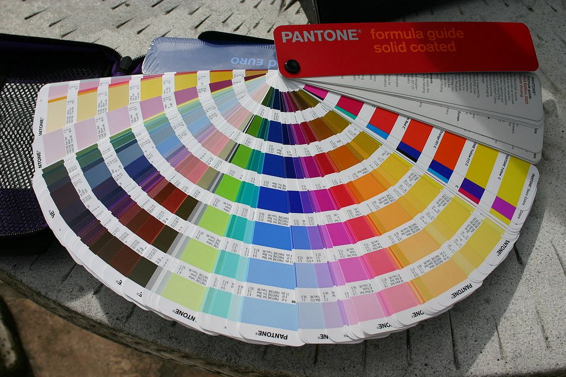

I'd buy yourself some coated Pantone chips if it was me..... you know they'll come in handy.
Get coated that's gloss or uncoated too if you can stretch to it!
26CR
Think I'm going to stick to b&q I don't want to spend massive ammounts on paint, the blue is close enough for me. I have also decided to free hand the artwork without the use of stencils, it's a massive headache and I'm confident I can do them by hand.
