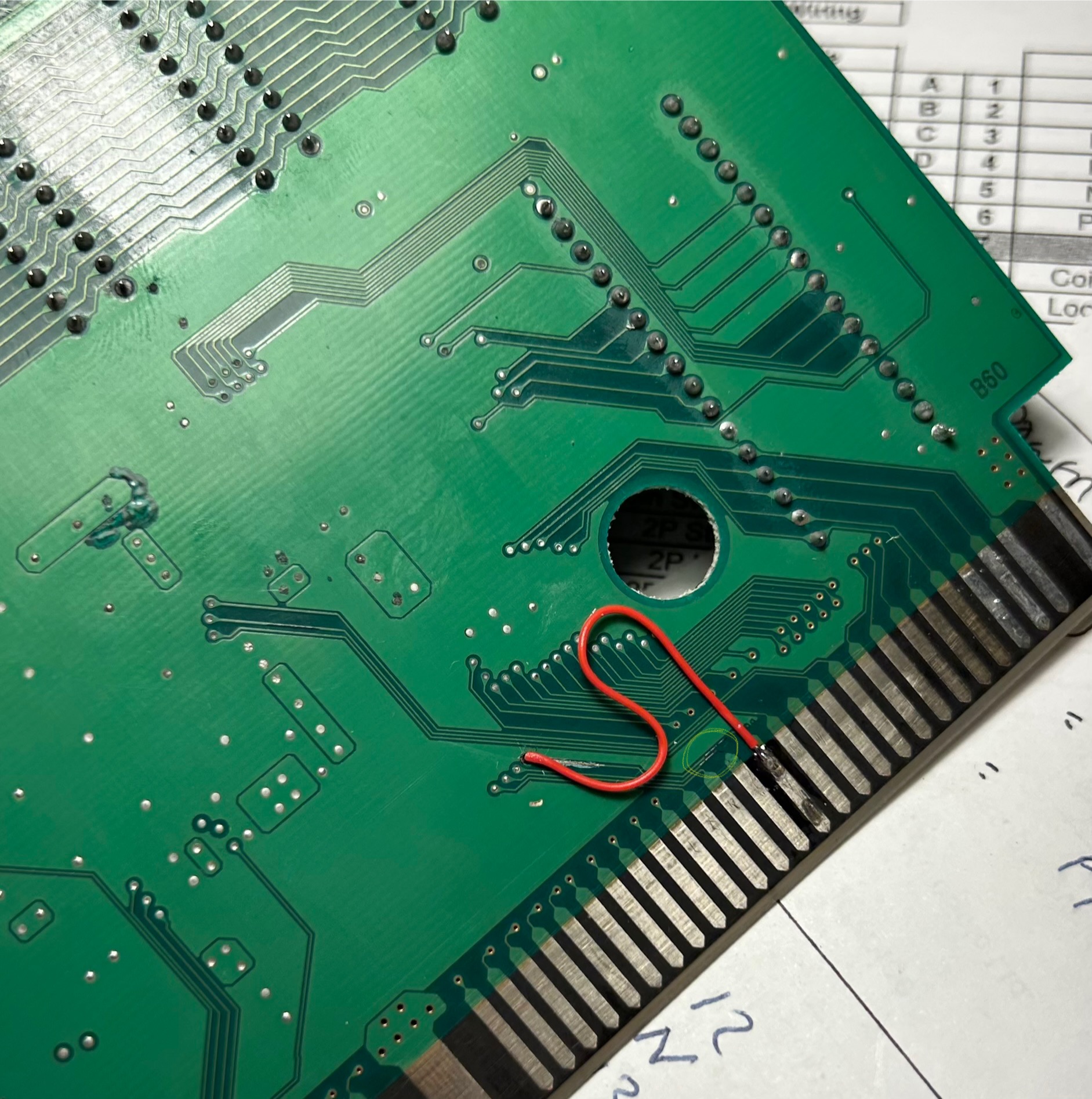

Well, not had much luck with MVS this week but a ray of sunshine - super chuffed to be able to resurrect my Metal Slug 3 with garbled graphics.
Turned out to be a corroded trace etc - watched many a YouTuber do these sort of repairs but with eyes that certainly aren't getting any younger and a Heath Robinson magnifying set up it's not so easy - these traces are tiny and it was knackered right through the board - it's not the prettiest repair but bloody chuffed it worked and all is good with MS3. :love:
