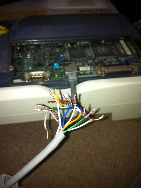

Or you can bodge it like i did when i couldnt find my crossover cable.

Very nice
I always find it easier to strip the insulation back 1/2 way down the cable and do the swap there, when I could never find my XOs
Andy.

i was tempted to chop it, but it was getting time to head in so i never bothered. im going to venture into maplins after a couple more cups of coffee. bit ot but i tried buying a 6 pin jst plug from rs components and they dont sell them. so im still after the cable to fire up the gd-rom drive. i really hope that this cable is the last part i need. i got a hold of some cards to save the id info. so im ready to go on everything.

This was just 2 ends of a cable I found lying about, didnt want to cut a perfectly good CAT5 cable.
