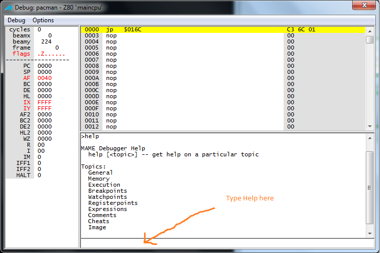

Cool - where can I find a guide for the mame debugger ?
Do you have to do a custom build ?
Is the latest version debugger the best ? - I believe some people prefer an older version or am I wrong ?
Cheers, Col
ColinD2016-03-08 18:26:01
Hurray Banana
2,740CR
Not read a guide, I use the in built help. Just type Help at the command window and enter commands to find out how to use.
No if you run from the command line (I have this set up in VS2015) it will tell you the checksums are wrong but happily load the roms and execute your code, with the debugger. You have to press F5 to start the emulator from the debug window, but this let's you set up breakpoints and watch values before you start (which is what I tend to do). The debugger is very powerful, it's great a keeping accurate track of beam position which is mega useful.
just launch like this mame pacman -debug
I'm currently using 157, which is quite a few versions behind the current build which is around 171, so don't know about that specifically.
If you have any further questions I will try to help, still just scratching the surface myself.
