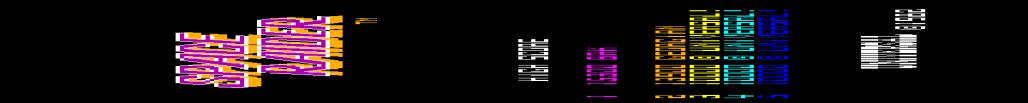

Also, using the Recalbox Manager V3, when I take a screenshot, the screen shot is very long. Any Ideeas on how to get a better screenshot?

I realised that the image is 1920 pixel wide, resizig it in paint make it look a lot beter. pixel perfect my ass.
