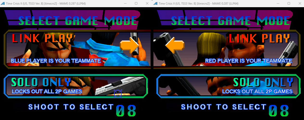

another dev has come along not realising sailorsat and your code has been languishing there for a year, and reinvented the wheel by emulating the c139 network code yet again:
Again, no feedback, no comments, no pull request merged. Just silence.
Must be very frustrating for new devs and turn them off even submitting to MAME.
Interesting.
I see at least Sailorsat gets a mention in the chat, if not in the code.
That is the strangest code/comments I've ever seen, I must admit. Is that what Claude creates?

I've absolutely no idea how this github thing works, pull requests merged, force-pushing and all that. Is it possible to get this code and add it into the source manually to create your own version of Mame for linked TC2? If it doesn't end up in the official release of Mame, and if it were at all possible, I imagine this would be very handy for owners of Time Crisis 2 twin cabs considering the rate at which original pcbs go wrong. I've got a whole bunch of faulty Time Crisis 2 pcb sets myself!
Edit: I just noticed there's a compiled link up version to try it seems.
John Bennett
5,287CR
Yeah, you can pull their branch, go to the green 'code' button and download as a .zip.
You'd then have to compile it by following the tools on the mame site. Bit late tonight, but I can help people through it if needed.
I'll be honest, our C139 code needed work and was hacky, but to be fair to the MAME team, I can't see something that AI-ridden ever being accepted, it's completely unfathomable. It’d need a big tidy up. That Rage Racer AI-assisted port code was lovely, so it can be done.
